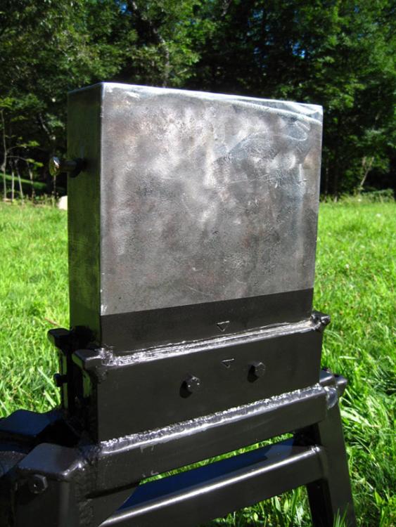

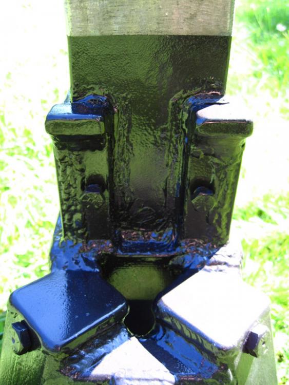

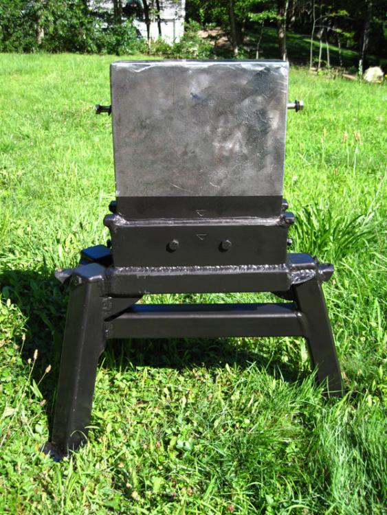

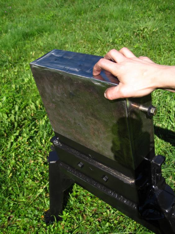

Extrasmack Posted March 11, 2013 Share Posted March 11, 2013 ****UPDATE**** 11/04/2009 I got to use it for about 4 hours and well i'm really quite impressed with the design. It's ~377#'s so it doesn't move a bit. The way the design is that Brian made it makes it really one piece, and not an anvil on a stand. The fact that there are through bolts through the anvil holding it as well as bolts on the ends makes it one giant mass. It does not have a ring, so if your looking for that I wouldn't suggest this style. But it also doesn't have a thwack that you might get off of just working on some railroad rail. It actually just has a really good deep low sound. I can tell you though that TIG welding the S-7 shock resistant rod onto the top of the steel really is a nice touch. Couple times I missed with a 5lb sledge today and no damage at all. Plus it's not the worlds most expensive finish so you can always take a sander/grinder to the top and your not messing up an expensive name brand anvil. Like wise you can always weld in the dings if if they get bad over time. Really happy I built this anvil and I think my neighbors are probably impressed that it's fairly quiet. Glad I went with the special order 4" plate though. That really gives some mass underneath. of course there is also about 50lb of sand in the legs or so which helps soak up some ring and vibration. I think you can't go wrong building one of these. Great starter anvil. I think mine was about 400-500$ though out the door. Of course you could drastically cheapen that perhaps even by half by going with 2" or 3" plate and not hard facing the top. I'll have to get a video soon of it for youtubers. :D Quote Link to comment Share on other sites More sharing options...

Avadon Posted March 12, 2017 Author Share Posted March 12, 2017 29 minutes ago, ede said: Thanks for re-uploading these! You're very welcome. Any questions just pm or post here. It's basically a big heavy mass with S7 welded onto it. I suppose if you had any gigantic piece of steel you could weld S7 onto that area and you'd basically have the same thing haha but the shape does lend it to be easy to work around and it can be moved. The width/thickness is 4". I had the 4" piece of plate cut for me at Turner Steel in Massachusetts. The torch cuts were just cleaned up with angle iron flapper wheels. Quote Link to comment Share on other sites More sharing options...
