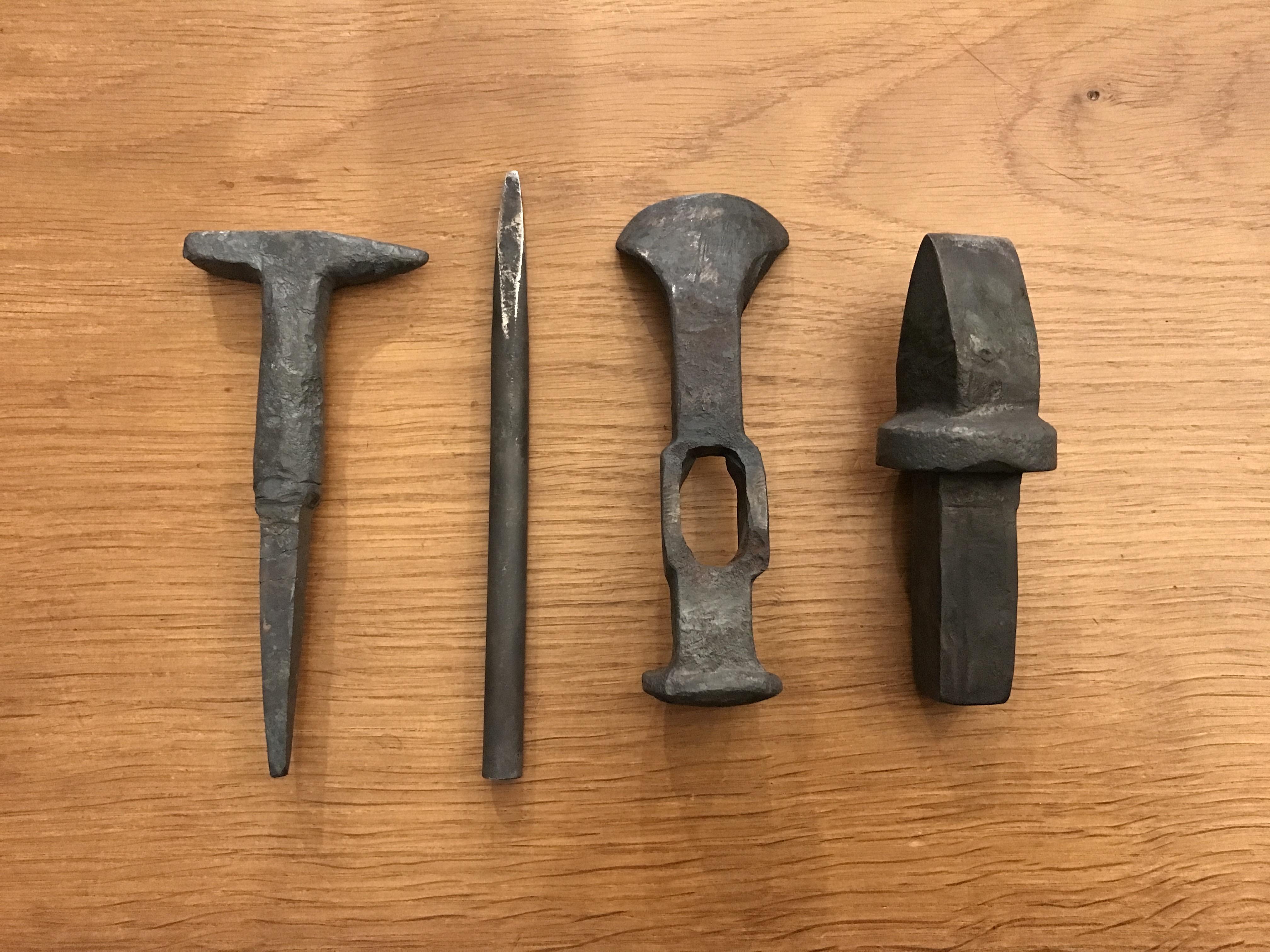

Can we get a good broadside view of the PW, Chad? Today I got home and decided to work on a bunch of miscellaneous projects to finish all of them. All but the stake anvil are heat treated. The stake anvil is made of a rr connector bolt. I tried water, oil, and air hardening, but cannot find out how to harden it! If y’all have any experience, I would love to hear! The punch and hot cut were oil hardened, and the rr spike bowl adze in water. And yes, I know the hardy is twisted, it was my mistake, but the angle actually works better for me! -
