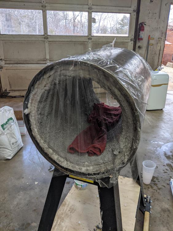

  1. A quick update on the forge: Sure enough, after a couple hot firings that cement started the crack and fall apart. Y'all were right, I didn't use any rigidizer the first time around so I stopped using the forge once cracks started to form. I took a break from forging for a few weeks (I had several house projects that needed attention) but recently I've gotten back to it, starting with ripping everything out down to the shell, which I scrubbed clean of rust and old cement with a steel brush. First off, I didn't care for the size or position of the one burner hole I had previously drilled. It was far too close to the front of the forge. My plan is to have two burners in this forge, so I measured out a ratio of 2:3:2 for the spacings between the front of the forge, the first hole, the second hole, and the back of the forge. I think this will work well for using the full length of the forge or when adding a false wall to use only the front half the forge. I also drilled holes in the steel shell that pointed towards the middle of the future bottom of the forge, instead of pointed towards the center of the forge. This should help me angle the burners further down than previously and keep the burners from sagging so much. By the way, I've significantly shortened the burners, shortened the 1/8" propane pipe, and added right-angle fittings to minimize the strain on the burners. Next I re-lined the shell with the same kaowool I used previously, but this time I sprayed each layer down with rigidizer after buttering it. I used a good fitting N95 mask to avoid inhalation of any of the silica, don't worry. After letting that dry a bit, I re-buttered the outer layer and mixed up some Kast-O-Lite 30 and have my first 1/8" layer on. I've wet down some shop towels for extra moisture and covered the shell with plastic wrap to let the whole thing wet cure. Tomorrow morning after letting the first layer cure for a while, I'm going to put a second layer on to get about 1/4" all the way around and also add refractory onto the ends where you can still see the exposed kaowool in the pictures. Eventually I'll also add some Plistix to the lining, but I need to drive out any remaining water from the Kast-O-Lite and kaowool first, and I plan on running the forge up to temperature once or twice to see how it heats before I get to that. One other improvement is that since I know my burners work, I cast the flares into the lining with the Kast-O-Lite. The previous version of the forge leaked heat around the burner holes and the burners had way too much play. I think the smaller holes combined with the flares being cast into the lining will help reduce heat leakage around the burners considerably. So, what else am I missing? Any other comments or improvements that I should consider before proceeding?

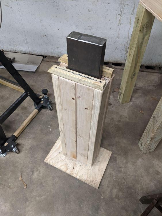

  11. Adding to the list of forklift tine anvils, with just a sprinkling of fresh scale for flavor. This is 98 pounds of steel I got at the scrap yard for about $0.40/lb. I realize the plywood base isn't the greatest; I'll figure out something more solid maybe this spring. I also have some steel set aside for banding, but after I assembled the base I found that the tine was so solidly wedged in there (I barely got it to drop all the way down) that I haven't prioritized it. I keep thinking about ways to improve the anvil or the stand, but I think my skills need a LOT more practice before putting much more effort into this anvil! It does need a hardy hole somewhere though. Any suggestions where that might go to be most effective?
