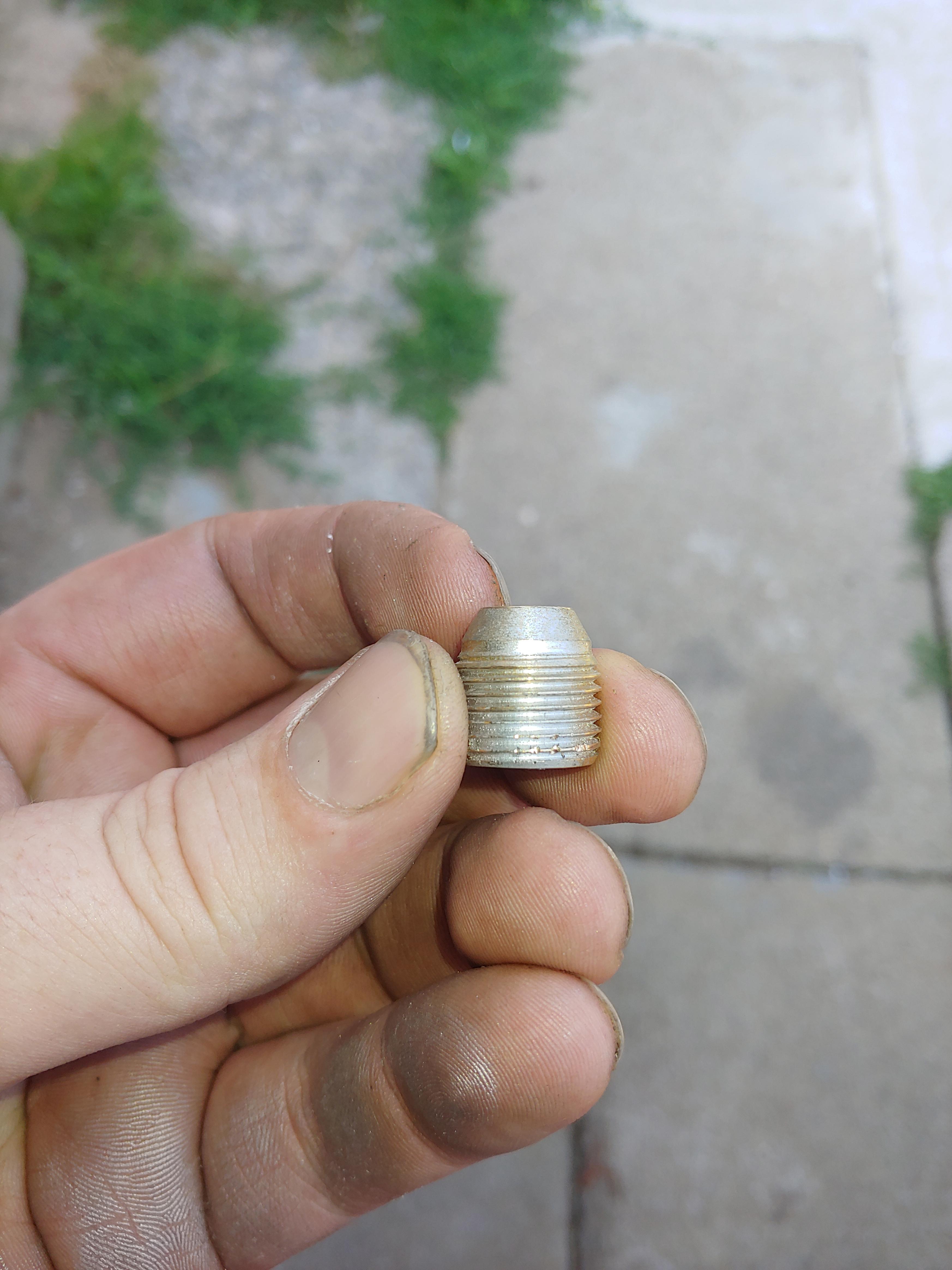

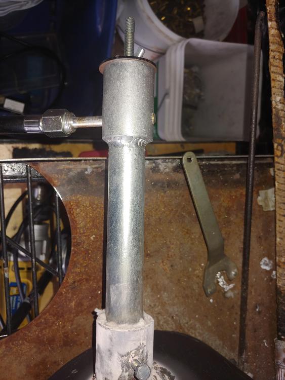

Third picture was the coupling to link the new regulator the company sent me and the replacement torch that broke off lol. I'm waiting on a replacement for the replacement. I just put my own together instead following instructions from many parts of this forum. Now the obvious fail pic is 9mm brass casings that were added to a mass of large gas fittings that congealed into a mass. I figure I'll keep it around as a learning opportunity for others who ask what's that.... -

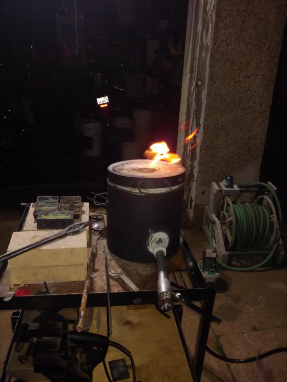

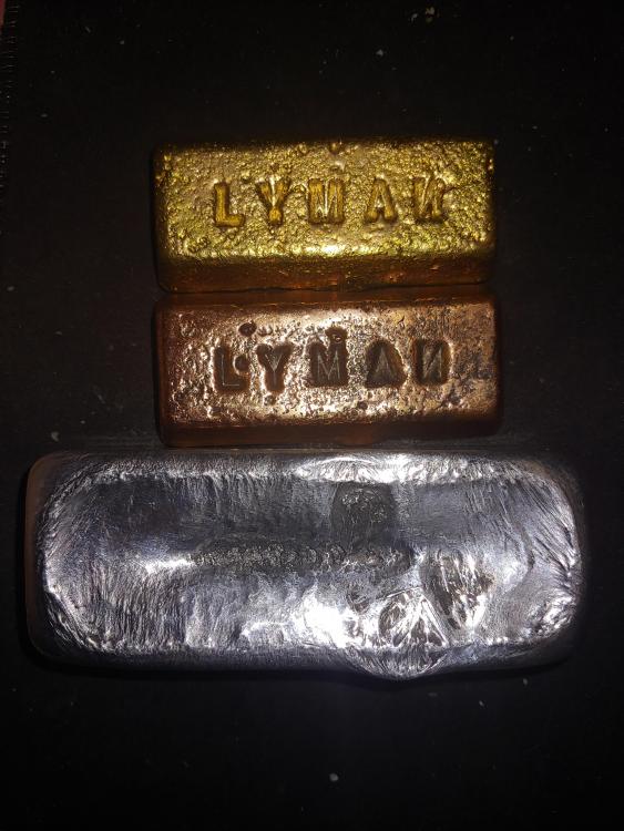

When the first attempt looks like a congealed mass of Hodge Podge brass items and your furnace doesn't work, Join IforgeIron, make a post, do some research, fix the problem and attempt again... Okay, so, Vitrified Firebrick, Check, 2 5lb Bars in under an hour, check. USING ANY OF THE ORIGINAL TORCH OR REGULATOR..... ummm nope... XXXX XXX Slow Mo Pour YouTube link to follow. -

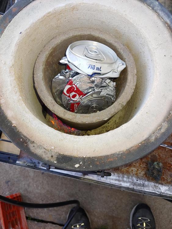

Welp 22.5 psi and I accidentally overheated my aluminum... never had that happen yet, it was cherry red in reference to the old pie cherries not the new dark ones. I had added in 3 small ingots to start a puddle for the rest of my cans, got called away, my father (who worked in multiple steel foundries) came out and monitored. it took all of 10 minutes to have my load liquid in the bottom and like 20 minutes for him to finish half a blue box of crushed cans. I got a call 20 minutes from home and was told it was all liquid and to hurry home, got home to about a 1/4" crust of oxide on the top layer and a bright bright almost yellow crucible. Nice jets coming out the top of the furnace and everything. So my regulator helped a lot, so did thread tape and tightening fittings, lol. also testing for leaks beforehand. So I started reading a lot here and in the past 48 hours have severely upgraded my safety routine. Having autism can be annoying because you get set in your ways but I'm open to learning. Probably gonna melt some brass tonight and show you guys the cleaned up results. -

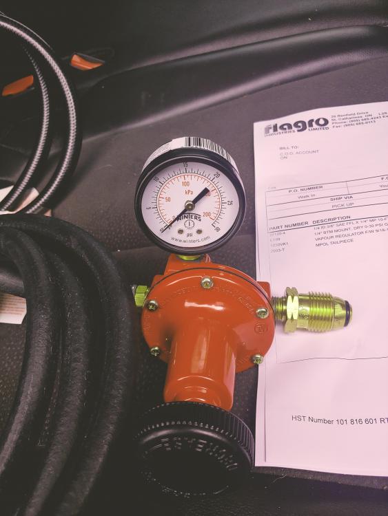

Thanks Irondragon, they most definitely did for my first ingots. It saved me some money on start up. Have so e people buying the ingots and I get my scrap brass as like 1.60/lb Canadian. CNC machinists and Knife Makers seem to like having ingots to melt or work. Just got my new regulator so I can keep an eye on pressures of my gas. Gonna be doing some brass with a decent reducing flame. I have some us pennies for my zinc loading before I pour if I end up burning it off. I haven't had much issues with it so far. Everything is outside although I could probably use some better PPE than running shoes and jeans. I have a denim apron probably gonna switch to cowhide but honestly I prefer topless it's weird I like the feeling of the radiant crucible heat on.my belly. My tongs are about 24 Inch and like your first design I right now am doing an rested tilt pour with the same ones as I am prepping to make a proper set of lift8ng and pouring tongs from that same video. I watch BigStackD a lot and have had an interest in melting since I was like 12. Saw the mini metal furnace on king of random and have been hooked ever since. Here is the new regulator. I dont plan on going past 30psi. -

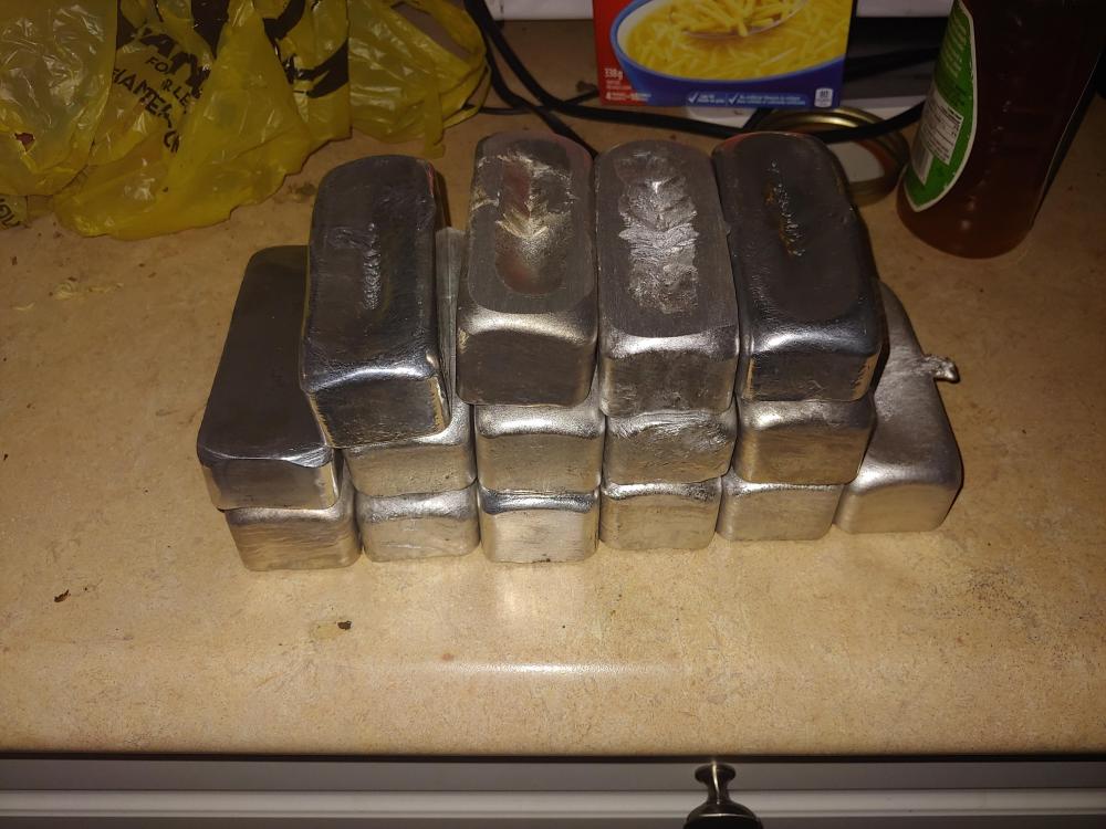

There is actually about an inch between furnace wall and that crucible and yes I have a smaller one. They sent me two very nice replacements after I ordered a second one for safety sake anyways. I just picked up a newer regulator setup as well seeing as I plan on making a second furnace once I have some experience under my belt. So far I have been messing with aluminum. I have an electric I use right now for brass and copper. Here are my replacement crucibles and some small ingots I've poured. -

1. That first crucible was like that almost out of the box. The bottom where it looks like it fell apart was like that from unboxing. I have made sure to break in each crucible I've had by doing the red hot and let it cool in my furnace. 2. Oh I know. I always wondered why they would sell a 30psi adjustable regulator without a psi gauge, but I am planning on getting one with a psi gauge shortly. Any extra pictures of Links for video I can provide if needed. Really looking forward to not having to use my electric for my brass and copper right now. I have waaaay to much to do little 2kg pours lol. -
Just got some replacement parts from the company I ordered from as the first crucible was basically useless after 4 pours, and the torch was misaligned and not assembled correctly. Was getting aluminum up to temp to melt but taking approximately an hour to do so. It would "soften" brass and allow me to get a "mass" of brass at the bottom after giving up and cooling, luckily it came right out of the crucible after cooling. The new regulator they sent is faulty as it sounds funky xx xxx xxxx when hooked up, but I'm going to message them and hopefully get another replacement regulator. I will say they did throw in an extra 6kg crucible, Regulator Hose, 113ml Mold on top of the Replacement torch and crucible. So that made me happy. Maybe with tweaking I can re-align the first torch and fix the problem and make a second furnace. It would work the first time I set it up but since then it hasn't gotten to temp once properly. If there is anyone in my area who could help I would definitely appreciate it.
