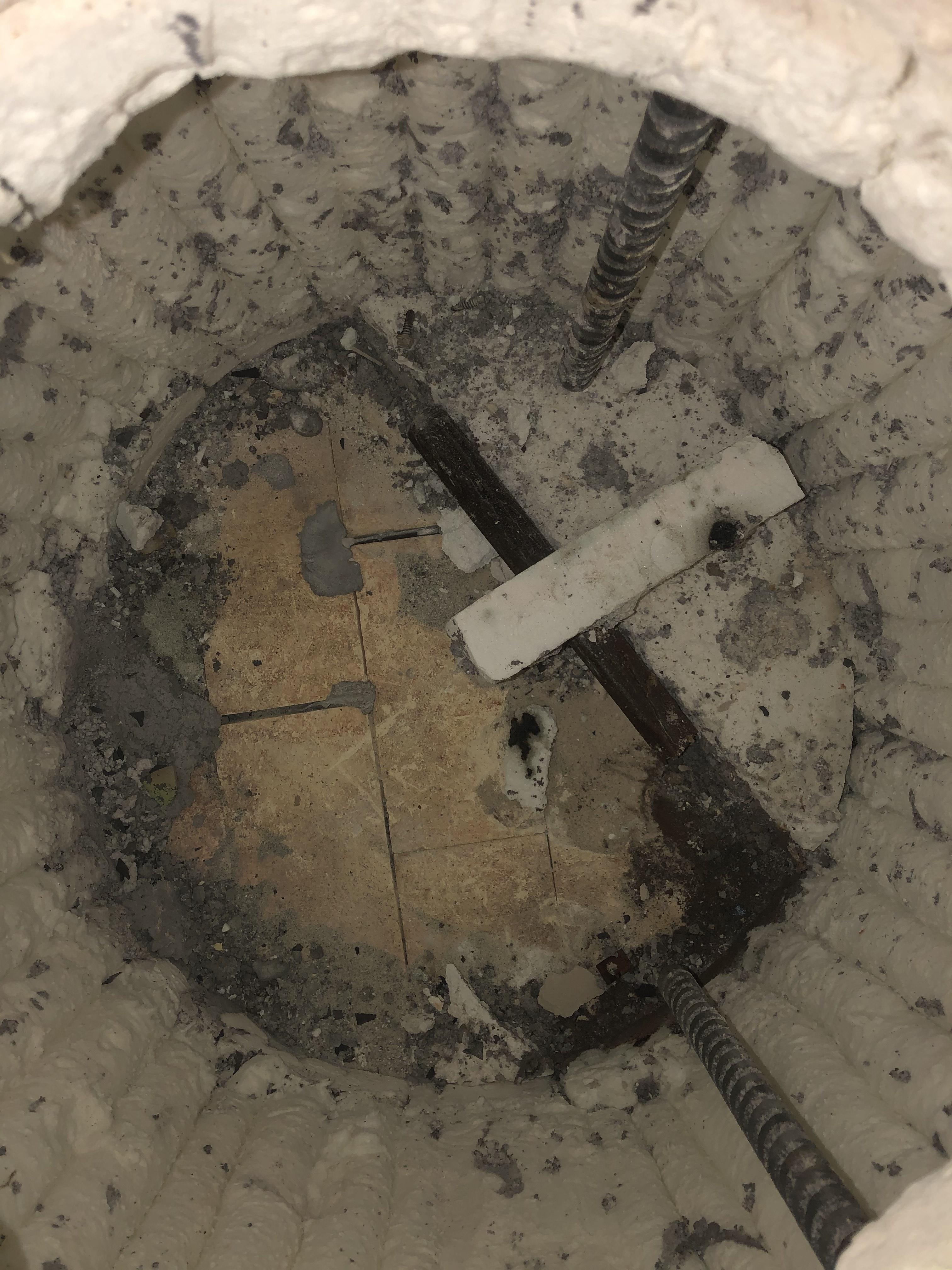

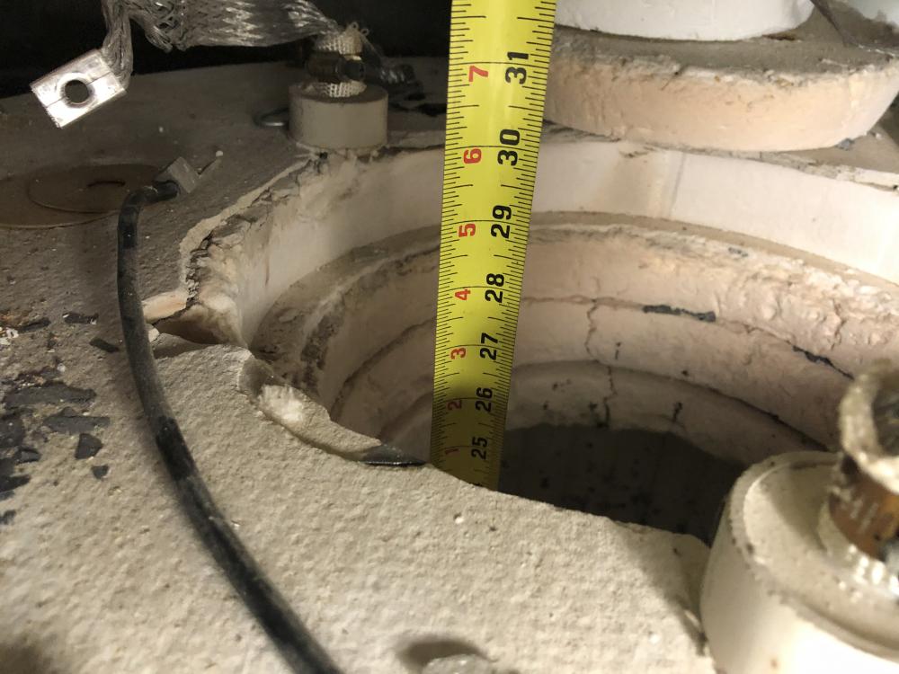

  7. I would like it to be a forge. I’m not sure on the terminology but like hammering, anvils that sort of forge. The current insulation is kind of a mixture, the floor of it is hard, the sides are soft, and there are several layers on the top. The innermost layer on the top is sort of a material similar to the feel of a ‘meringue’ cookie, and then the outer layer is like a softer fibrous material. My location has single phase 120 and 240. I would prefer to keep the costs low. That makes sense, that’s kinda what I thought about this being a little overkill of a furnace. Could I convert this to run on propane? or is that something that wouldn’t be possible? Also, thanks for the response!
  8. A couple years ago I bought an electric furnace from a university's surplus auction. I believe something exploded inside the furnace as some of the silicon-carbide heating elements were in pieces and metal was strewn all over the inside of it. Anyway, I have no experience with this type of metal working, though I do weld and have experience with aluminum fabrication, but I would like to get into forging and learn about it. And so, I am trying to figure out how to convert it into a usable furnace. I'm not quite sure how to do that, so if anyone has any suggestions I would love to hear them. Should I try to keep it electric, or should I convert it to gas? Is the interior too big? Should I weld a stand to set it on its side? Is it even possible to use this as a furnace? I cant Attached are photos of the furnace, it measures almost 3 ft external diameter, its about 4 ft tall, has an inner diameter of ~15 inches and an inner height of 19 inches. The heating elements are silicon-carbide and reach down to the interior floor of the furnace. Not shown is a 12 inch tall circular metal grate that I guess was supposed to prevent people from touching the heating elements. I'm not sure what the red band is around it, there's nothing inside it. -Ben
