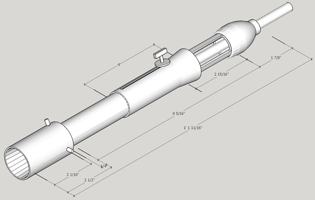

    Mikey, thank you so much for these clarifications! I apologize for missing your comments in the book re: odd-numbered intake openings, I'll be more diligent going forward. I understand now that the step ring serves to give the enlarged opening for gas speed reduction so the taper in the SS nozzle end is no longer required. I'll eliminate that from the build. I had intended to also ask about the one thing you have already clarified, the burner tube length. I want to further clarify this for my all-too-linear mind. In the attached image, should the length of the tube, at 9x inner diameter, be measured from the outer end of the nozzle (red arrow) or from the tube end where the expansion/step ring allows for gas/air mixture expansion (blue arrow)? Finally, I truly appreciate your attention to this older design. I've read many posts so I'm guessing that the design currently taking the fore is the ribbon burner? I'm going to follow a similar documentation procedure for Frosty's NARB but I want to go see Wayne's forced air clamshell version before I go down that road. Cheers! -Paul
  9. Skidpad13 replied to Mikey98118's topic in Gas Forges
    Good evening everyone. I've scoured the thread as much as my eyes can bear. Likewise, I've been re-reading Mikey's book over and over. I have picked up that there have been some modifications to the original designs as presented in the original book. Some of the modifications I have been able to find are: (A) change the number of intake openings to an odd number in order to reduce cross currents, (B) ensure that the length of the burner mixing tube is between 8-9 times the diameter of the tube and (C) there may be some builds that benefit from a smaller orifice opening than the .035 tapered contact tip. So, with these specifications in hand, I've documented the most current version of the design as best I can assemble it in my mind. Since my day job is as an architect, I couldn't help but to lay this out in the computer first where it costs less and saves time to make changes. If this entire exercise has already been completed and I just missed it please disregard this post and kindly direct me where to look as I have been unable to find this despite many searches and pages upon pages of reading. I would greatly welcome everyone's input, especially that of Mikey if you would be so kind. Although I know, especially from recent posts, that each build is slightly different and tuning and modifications will be necessary for each one, I still want to start off on the best foot if possible and then tune the build. One of the questions that I think I know the answer to I will state here for clarity: in optimal recommended configuration, where should the forward (gas discharge) end of the contact tip be in relation to the intake openings? Should it be in line with the forward edge, set back some distance? This is the one dimension that I feel is somewhat nebulous in what I have been able to find so far. This will drive the length of the accelerator tube connected behind the contact tip. In relation to this, does everyone find that forward/rearward adjustment of the accelerator tube in relation to the bell reducer, is essential? If so, my thought to solve this is to drill out the threads in the bell reducer and allow the 1/8" pipe nipple to move freely forward and back with three set screws providing both a locking mechanism for this as well as providing aiming screws for the centrality of the accelerator within the burner body. Please use the attached images, especially the section view with callouts and notes, to document my understanding of the latest generation as well as for edits, comments, corrections, etc... the axonometric view and the exploded view are just to show any 3D context that the section view may leave out. This and possibly a twin, will be used in a soon to be constructed forge. As many posts have suggested I am going to go and visit a local guru to see their setup before I begin on ours. I'm only a couple of hours from Wayne Coe as we are here in Nashville so I hope to visit him in the next couple of weeks and see his forge(s) before beginning to build ours. Thanks for any comments or advice, corrections, etc... I'm always humbled by the amount of wisdom and patience from the members of this forum. SF Paul
