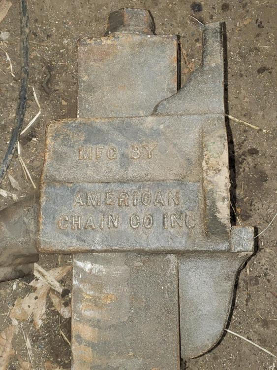

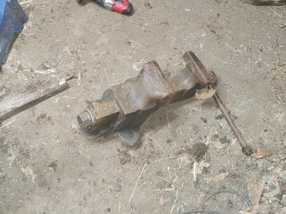

American Chain Co #12 Bench Vise
DeepwaterForgeWorks replied to DeepwaterForgeWorks's topic in Vises
The one jaw doesn't have holes so it's not a removable insert, whereas the other jaw looks to be. Most vise I've seen are which happen to be newer vises, have a removable insert on both sides. And to "Kozzy" thanks for the info, you provided more than I could find. When i searched for any info it only gave me info about the chain the company produced. I have seen other acco vises but they are considerably smaller. I've only ever seen on other post about this specific vise but the picture dont look the same and it went for sale a few years back. Other than that I know nothing about this vise. -
All I can find out about it is what's tagged on the vise itself. Got it from a retired blacksmith who was a friend of my uncle. I was hoping to find out more about it. Any and all knowledge about such a vise is appreciated. Weighs about 80 pounds, only has on jaw. Other side is smooth, screw is in great condition. Also has weld spots on it.

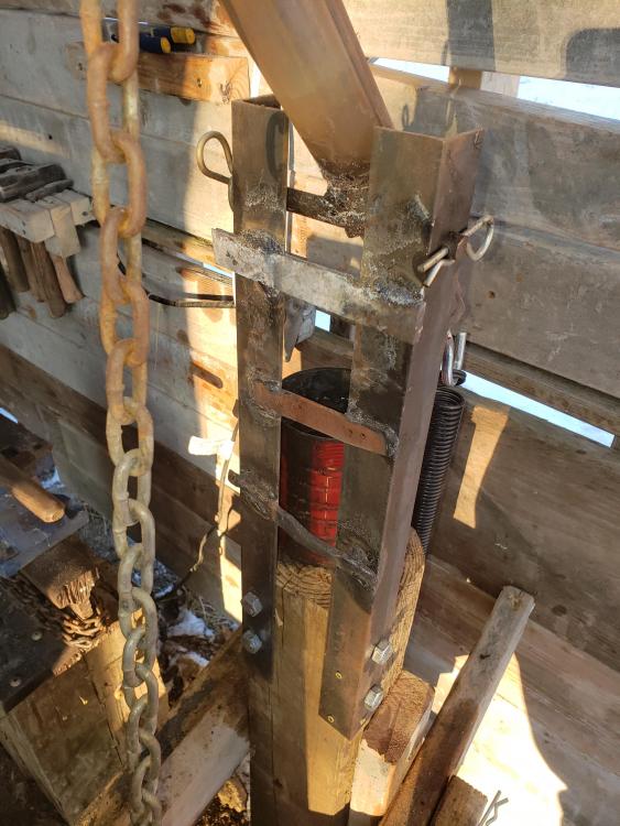

The pipe is holding the sledge hammer to the pivot. Was a quick decision since I cant weld wood to metal. Its riveted in so that the hammer handle is in the middle of the pipe. It hits fairly square, but hits angular using top tools. Would I need it to hit over square to the bottom "anvil" so that it would hit square on a top tool? Or am I overthinking this?

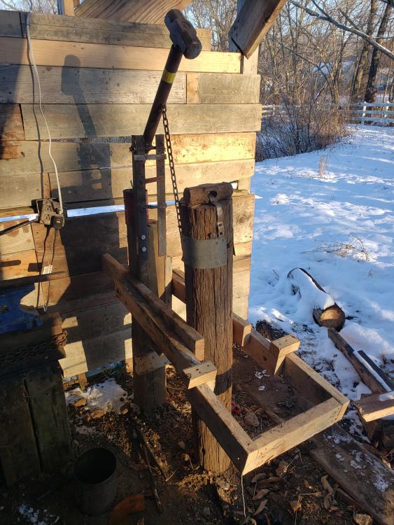

I built my first treadle hammer last week and thought I'd share with the class so to speak. Does hit as hard as I'd like but it's better than nothing. Don't mind the crappy welding, if anyone has any thoughts or ways to improve please let me know. It's based off of "Big Dog Forge"s design. Has a 90lb spring, 10 or 12 lb. Sledge head as the hammer and another as the "anvil".
