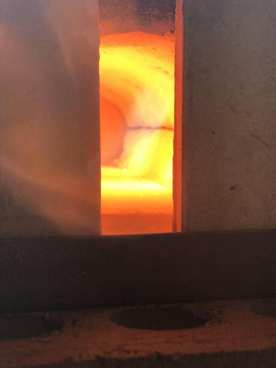

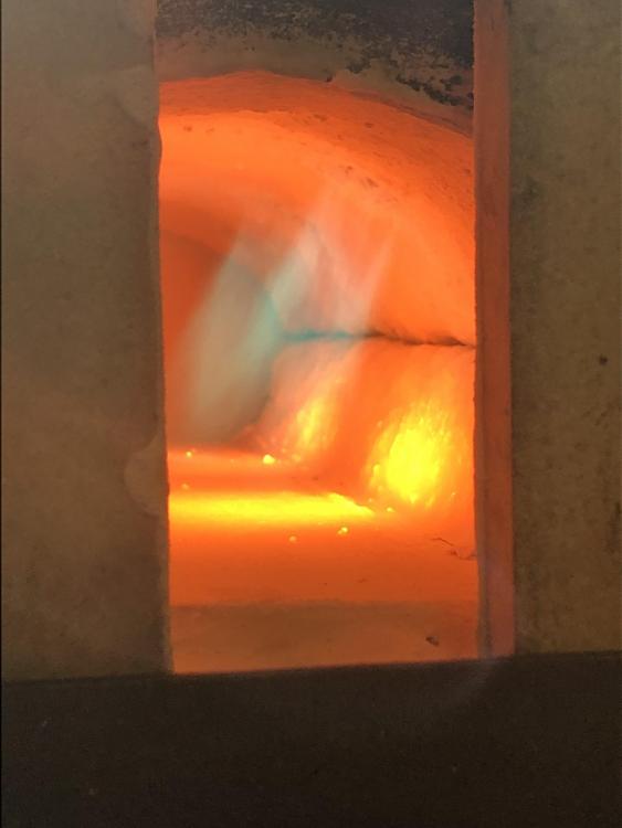

  4. Today was the first time I actually got to forge after finally getting my anvil mounted. The forge will heat steel up to a bright orange color at around 12psi but it's still short of the welding heat goal and I don't know what steps I should take to get there. I would imagine that two half inch T burners should be able to bring the volume, ~240 cubic inches, I have to welding heat. I'm pretty sure that the burners still aren't running optimally. The pictures in the above post are still more or less true today but I'll attach some recent photos of the flames. The rear flame still seems to be under less pressure than the front one and is still green from the copper. Also, they seem to stutter a lot more than I would expect. Any dragon's breath is orange when the forge is up to temperature. I'm not sure if it's an air:fuel mixture issue or something else. I've cleaned the mig tips out and everything in the propane lines is as close to the same as I could manage. I would appreciate any advice with this, welding temperature really is the goal now from a functionality standpoint and for personal satisfaction. Thanks!
  5. Back at it today. I cleaned out the mig tip on the rear burner and reinstalled it in the burner. Lit the forge and the back one is rather green still, probably the copper I think. Pictures below are right after lighting and then after coming up to temperature some. I ran it for around 10 minutes at around 10-12 psi or so and it seemed pretty hot, hard to get good pictures at that point. The link here is a youtube clip of it running. Let me know what you think. I see what you mean about the near flame burning off the nozzle, do I need to adjust the burner's position within the shell to address that or is it a pressure thing?

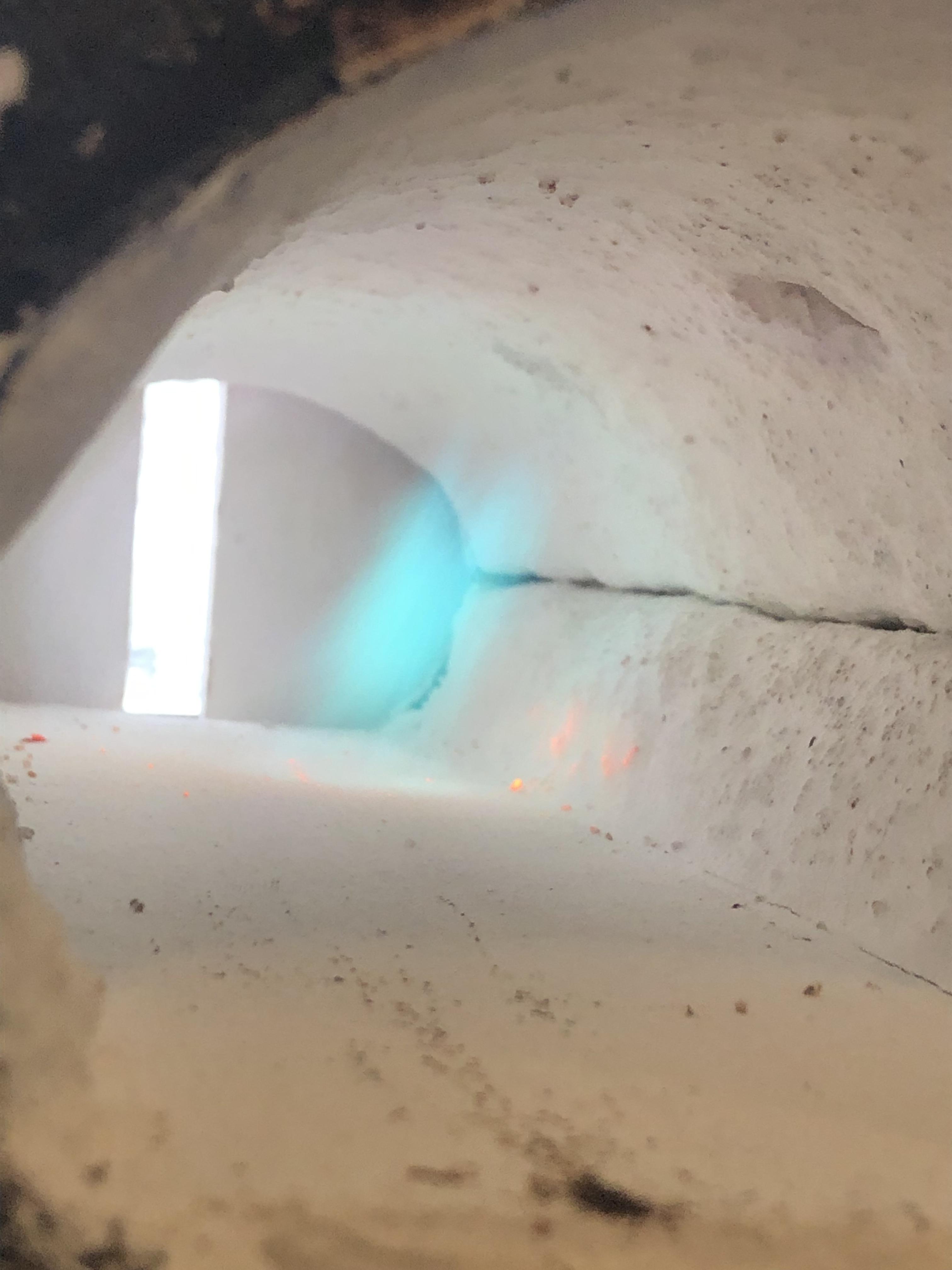

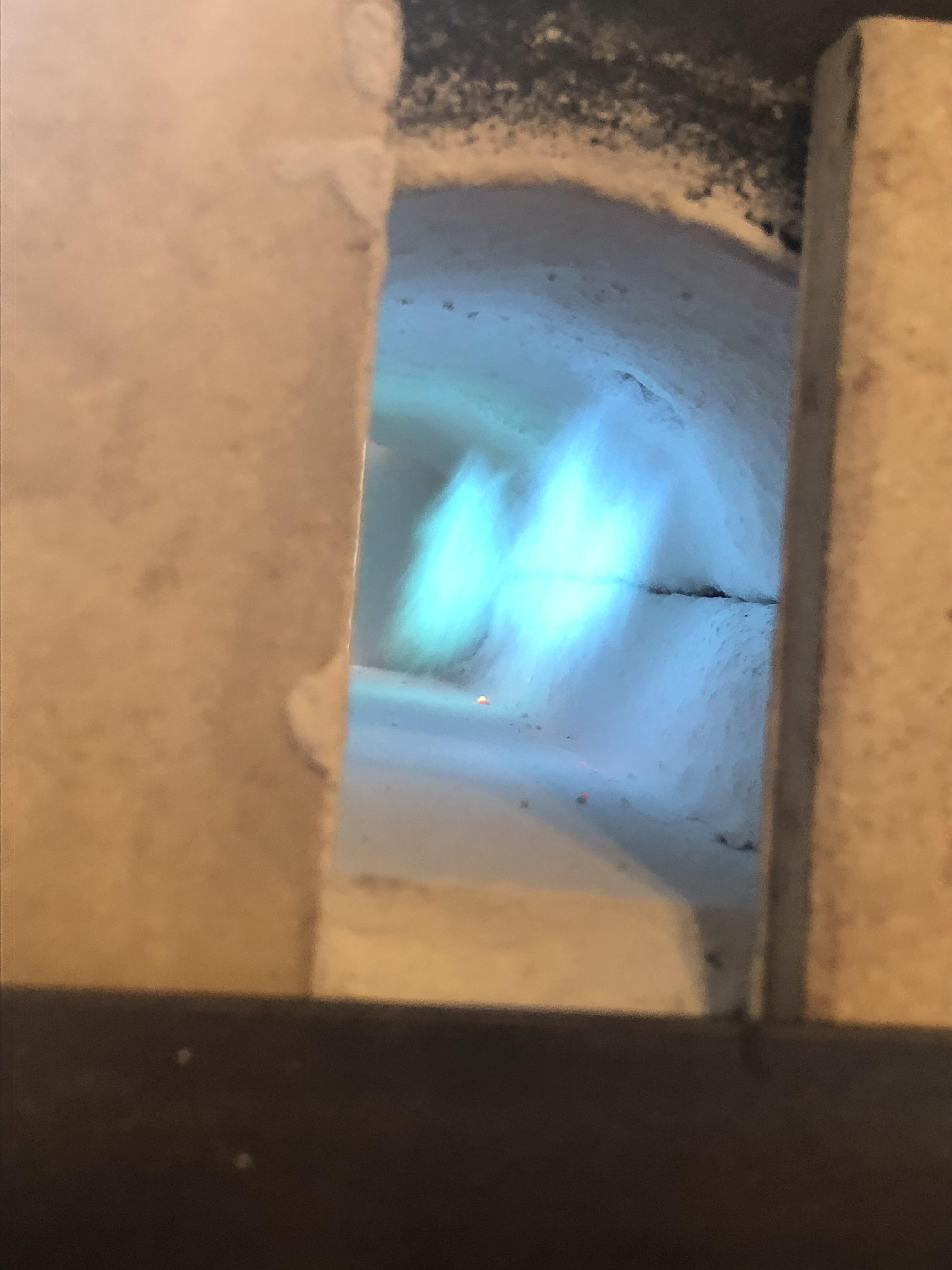

  7. I replaced the tubing on the back burner and I'm not sure it's gotten any better. The flame in the back is now smaller and slightly green. The front flame also shows hints of green at times as well. I've checked the jets and they look lined up properly. If I remember correctly, green = fuel rich and that should be a sign to trim the mig tips? Slight edit: The back burner tube itself was slightly tilted out of alignment with the flare I cast in the refractory, I tweaked that a bit and now both flames look to be the same size, the rear flame is definitely more green, and the front is only a hint green at times.
  8. I’ll go ahead and swap out that section of tubing and see how it goes. Would you recommend I trim the mig tips back a hair, say 1/8”? I'll also add that after the forge got around a nice orange color that back burner flame began to flicker every now and again as well.
  9. The 1/2" is measured from the outer shell. The mig tips should be relatively clean I think, haven't touched those. I did manage to bends a few flatter portions in the coil loop on that back burner, might that be the issue?
  10. Frosty, They're both about 1/2" into the lining. I've only had them running around 6-7 psi, but any dragon's breath that come's out is out the back for the most part, and blue. Not sure if that helps or means anything.
  11. Finally lit the forge for the first time today. I just wanted some advice on tuning the burners. Fairly sure they're a bit fuel rich but I wanted some expert opinions on what exactly should be done. I have 2x 1/2" T-burners. First picture is the front flame, second is the back.

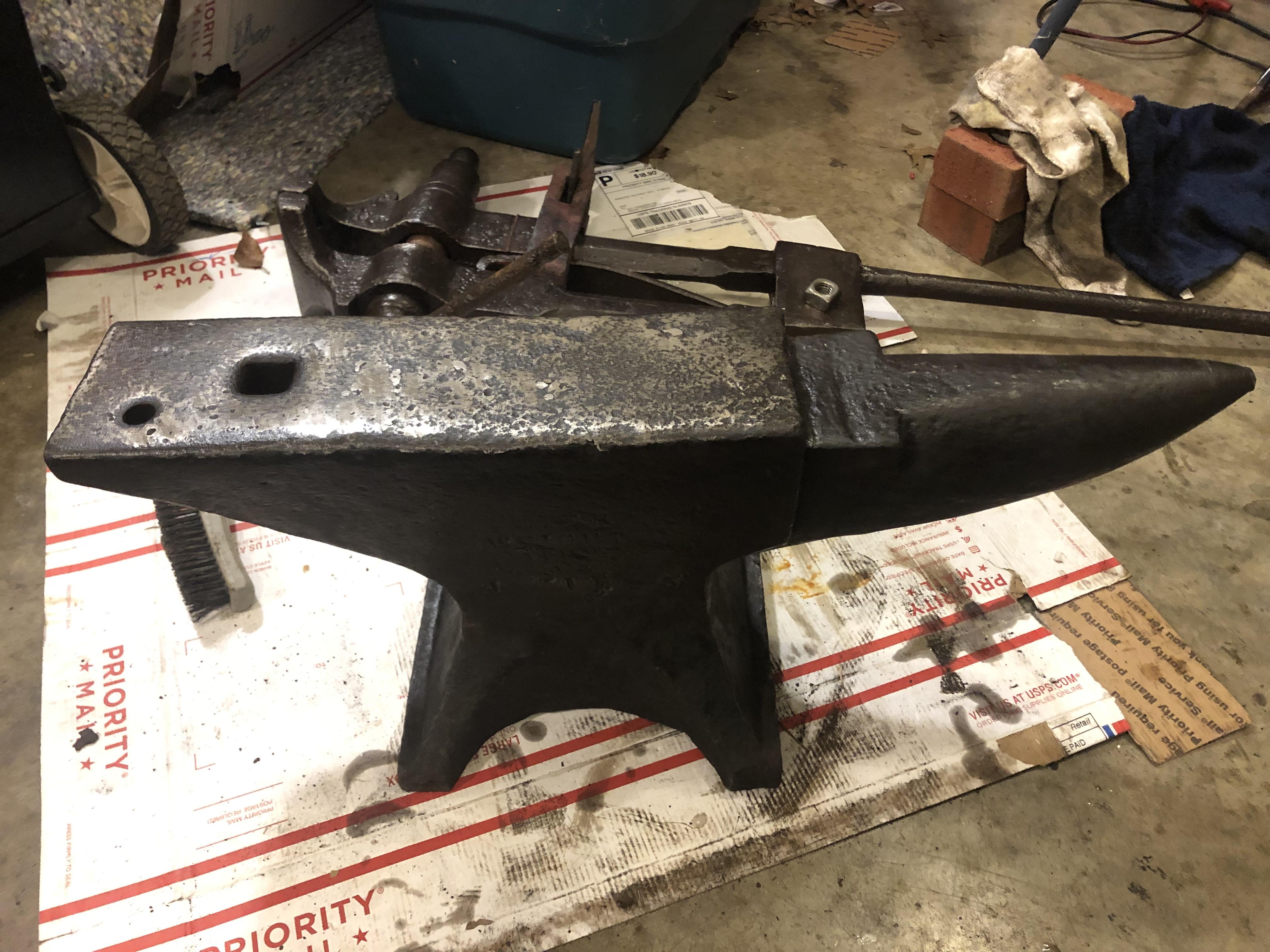

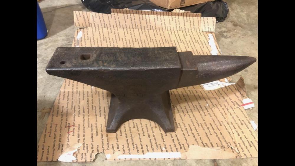

  14. Picked up a 145 lb PW the other week. Here it is before and after some electrolysis treatment, looks like it might be worth it to clean up the face a touch (cameo by the new post vise).
