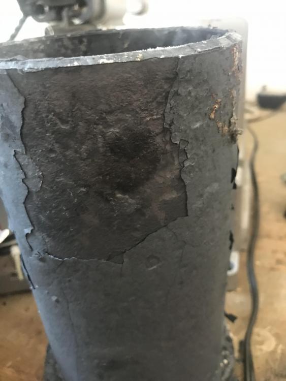

Thomas- I guess I'll need to look it up. So is the scale made from the metal melting in the foundry and then oxidizing? Hand-held Definitely seen lots of the white power on the tools after my three burns of Brass. I will for sure have to look up ways to prevent it especially because I want to get into knife making. -

Is that the metal flaking off? Is the wall thinning because of it? -

Okay I was using the borax way wrong. I would get a punch with my gloves and sprinkle it in while the crucible was still in the foundry. As for brass, I melt outside with a respirator mask on. Plus I always try to stay up wind. I figure you can't be too safe. I need to get some fire bricks. The brick in the bottom of my foundry has broken in three different spots. My steel crucible sheds like a thin layer every time I fire it. It just has a a thin layer that is bubbled, looks like paint, but there is no pushing paint on the metal. I am going to make another steel crucible for the aluminum, so I can melt a lot. But the steel crucibles are heavy sands hard to pour so I'm going to weld up a pouring stand I saw in a YouTube video. For that crucible I'm going to drill holes at the top. Here is a drawing -

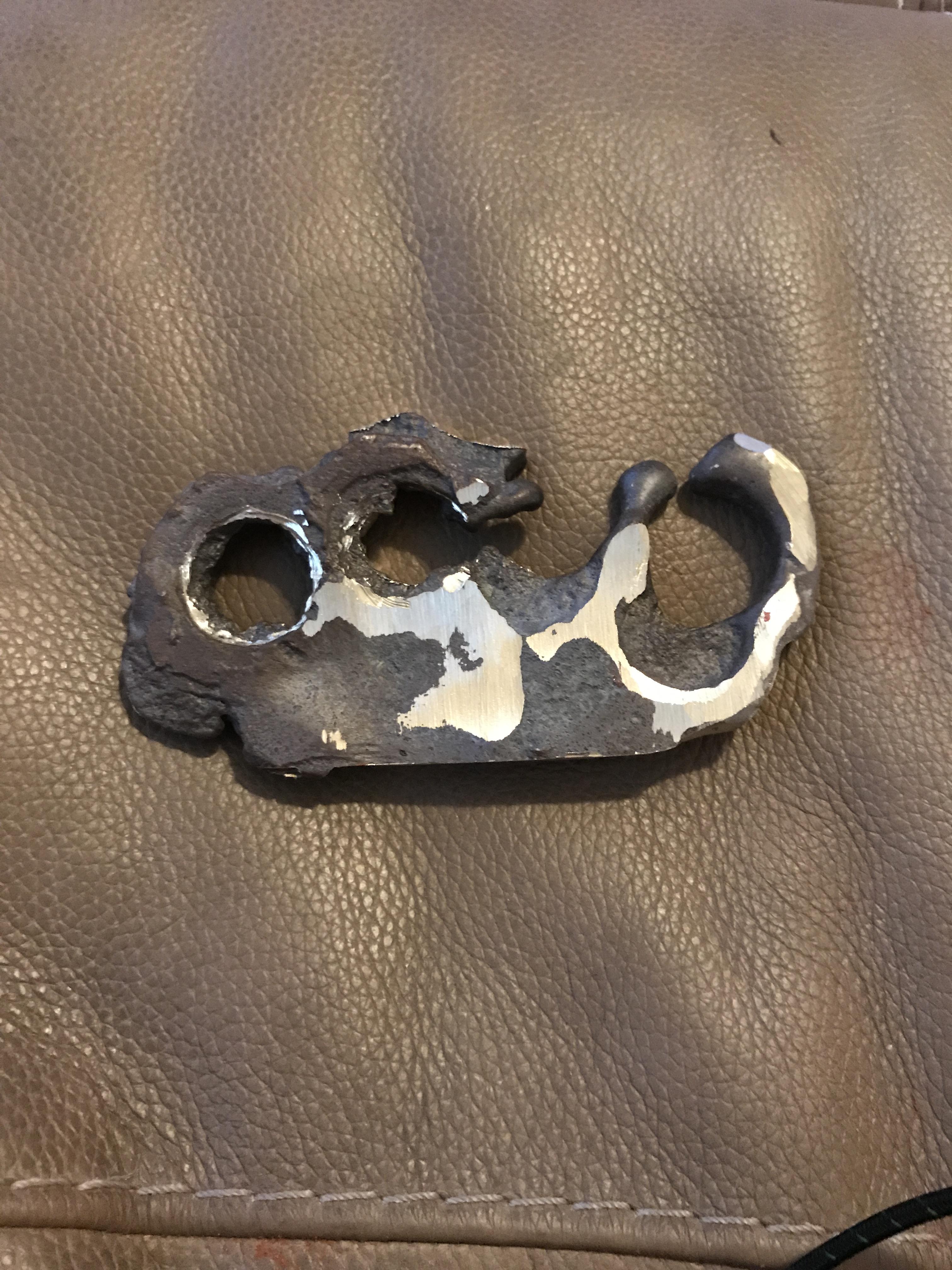

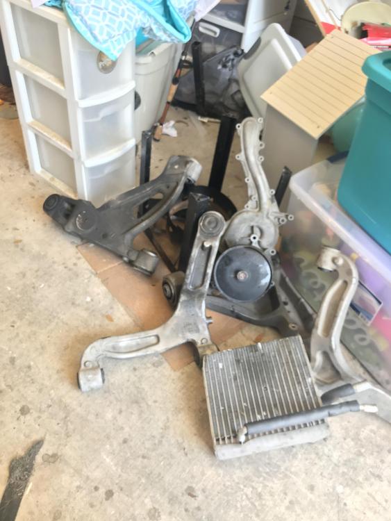

Looking good Hans. I like my little foundry but I'm also looking to the future of getting a larger forge. I am wanting to make ash trays for a couple of my buddies cigar shops and I'm not sure if I can melt enough aluminum at one time to make them. I took a hiatus to try making some things and here are my results. My first try at casting was brass knuckles. They were not good but atleast it wasn't a total disaster. My second try was the ashtray is modeled after the red one ( I forgot to take pictures before I cut it up), I got the top 1/3 shaped perfectly but then I ran out of aluminum. So this is why I think I'm going to need a bigger foundry, or custom make a crucible like the one I use for brass (the steel one in the pictures I use for brass now). The clay graphite I got does not hold enough metal (you read that right, I used the new crucible and I cured it and it didn't break) So I thought things were going better so I tried using Styrofoam to redo the brass knuckles, this time it was a disaster. The metal somehow went through the sand and created a mess. That is what the picture of a mangled mess was. I seem to be able to pour ingots pretty good. So I have a buddy who has a cnc milling machine and is going to make me a negative of the ashtray for me and I can just melt and pour into steel like my steel muffin pan. So I'll shut up now and let y'all put your Windom on me. -
