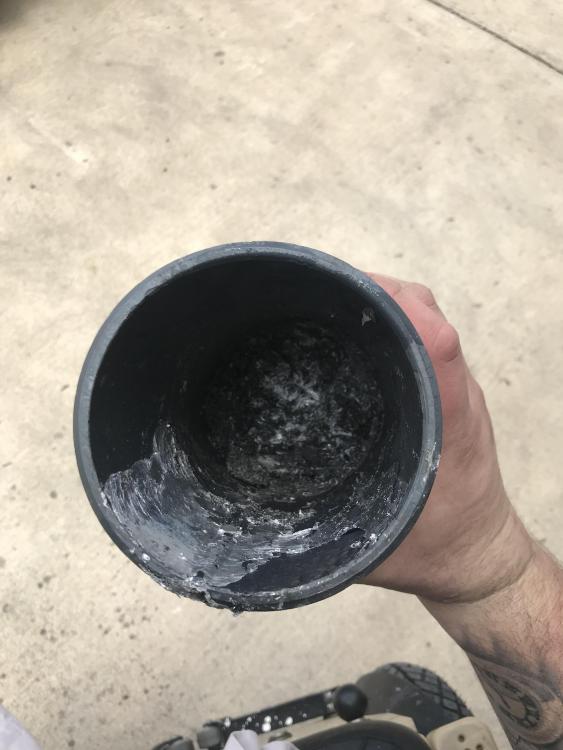

Okay I was using the borax way wrong. I would get a punch with my gloves and sprinkle it in while the crucible was still in the foundry. As for brass, I melt outside with a respirator mask on. Plus I always try to stay up wind. I figure you can't be too safe. I need to get some fire bricks. The brick in the bottom of my foundry has broken in three different spots. My steel crucible sheds like a thin layer every time I fire it. It just has a a thin layer that is bubbled, looks like paint, but there is no pushing paint on the metal. I am going to make another steel crucible for the aluminum, so I can melt a lot. But the steel crucibles are heavy sands hard to pour so I'm going to weld up a pouring stand I saw in a YouTube video. For that crucible I'm going to drill holes at the top. Here is a drawing -

So I got the crucible cleaned out with a mini crow bar. Man that stunk horrible. Back in my last post I asked is it worth remelting dross if there is aluminum in it. Here are the pieces I’m talking about. I hit them with the bench grinder and it took a lot of the dross off. The pieces in the picture feels ( to a layman) like it mostly aluminum. It feels more like aluminum that the can I melted lol. -

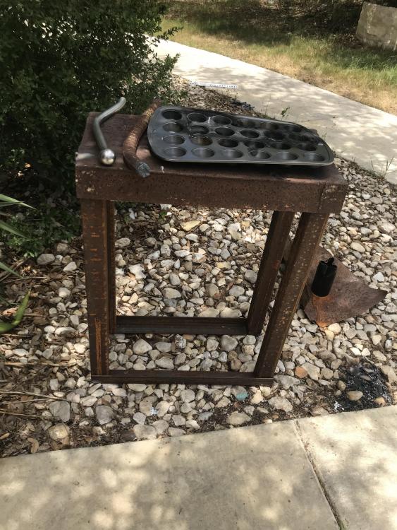

Thank y'all! My first name is Colton. Han I'm not trying to steal your thread and I'll delete this if you want me to. But here is my set up. I ran a batch today and I left a lot of aluminum in my dross, but I had much better quality ingots. I prefer to have no dross in my aluminum. In one picture you will see how much dross I had compared to my aluminum. That was a trash bag of soda cans. My steel crucible ( I know I need a clay, I'll buy one on payday Friday) has a weird spot now. I think it's where the burner was hitting it. So the next question is how do you get the stuck on dross out of the crucible? Is it worth running dross a second time if I see a big chunk of Aluminium? Then just a note, I’ve been using my welding gloves and pliers to take my crucible in and out. I learned that I can get a nice little burn blister through those gloves. So I ordered a more heat resistant gloves and some proper tongs. -
