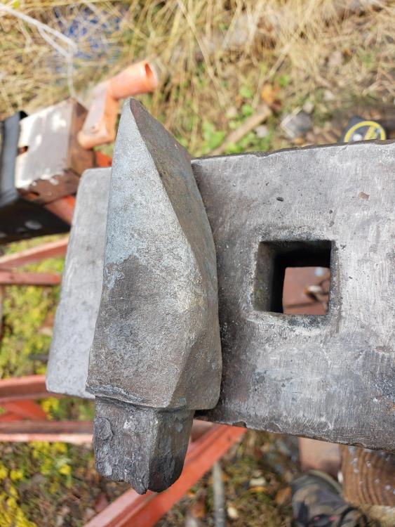

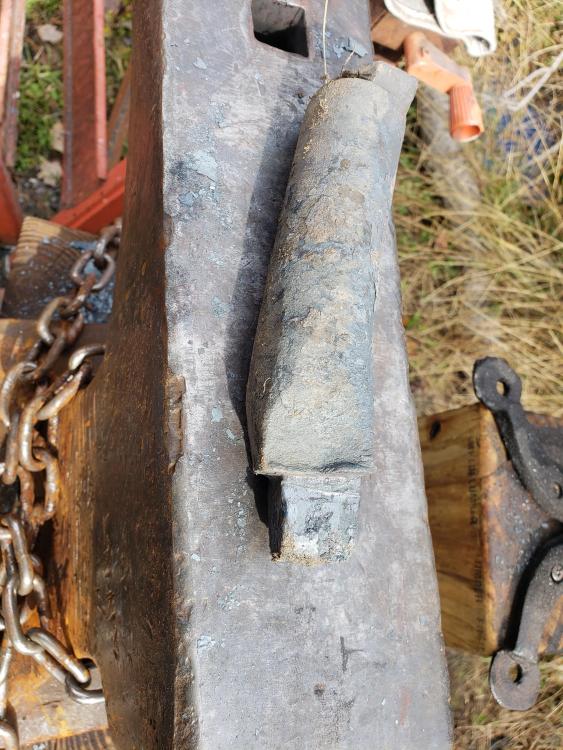

  2. So, I'm pretty new to the craft (less than 6 months serious work) and I really wanted a hot cut hardy tool. I do some steel shopping at my local scrap yard and I was lucky enough to come across some 4140 elevator pins. 1-1/4" diameter. I had a a few extra hours on Friday sooo... I got to bangin... I used an angle grinder to make a square nub on the end so I could grab it with my tongs. I made this with a 3lb cross peen and a file for final profile on the cutting head. I never thought that moving that much steel by hand would be possible. My shoulder still hurts and I broke my hammer but I did it. Hahaha. I heat treated the blade portion but didnt bother tempering as I felt the heat from hot materials would ruin any tempering I do. I would love some feedback. Please and thank you.
