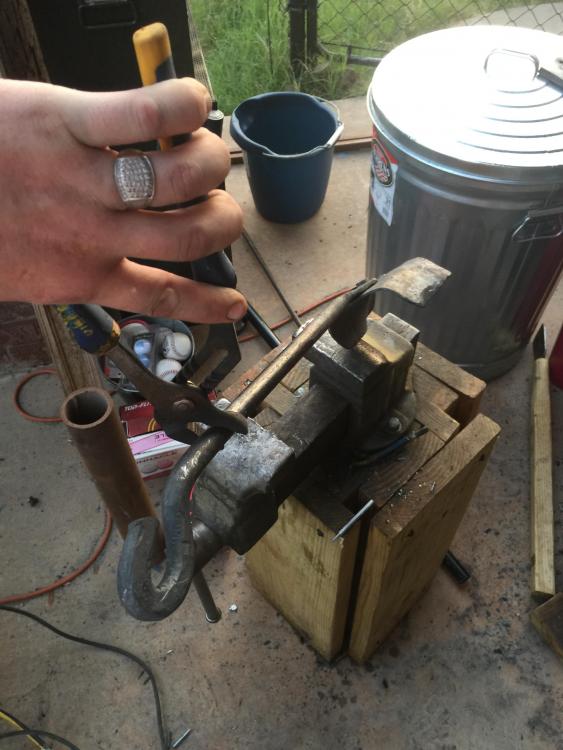

  3. I took your advice @Charles R. Stevens and I made a shovel. The shovel head was quite frustrating but I had a lot of fun with the handle. I'll make a better one in the future but this one will work for right now. What do you guys think?

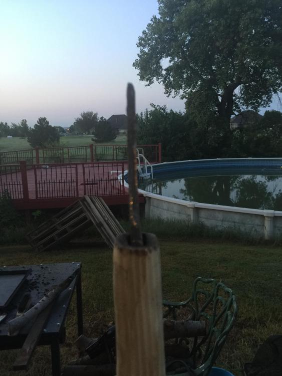

  6. ***Update*** Ive been told over and over the best thing I can do is get on the anvil so I finally did. My smithy isn't anywhere near done yet and my wife has relocated me to the backyard, but I am undeterred! Its not really that pretty, but it was the very first thing I've ever made. I found myself constantly shuffling coals around my firepot with a stick and inevitably, when you poke a stick into a red hot fire, it always comes out on fire and it was getting on my nerves so I took a piece of 1x2x1/2" steel and forged it into a coal "spatula". Let me know what you guys think!

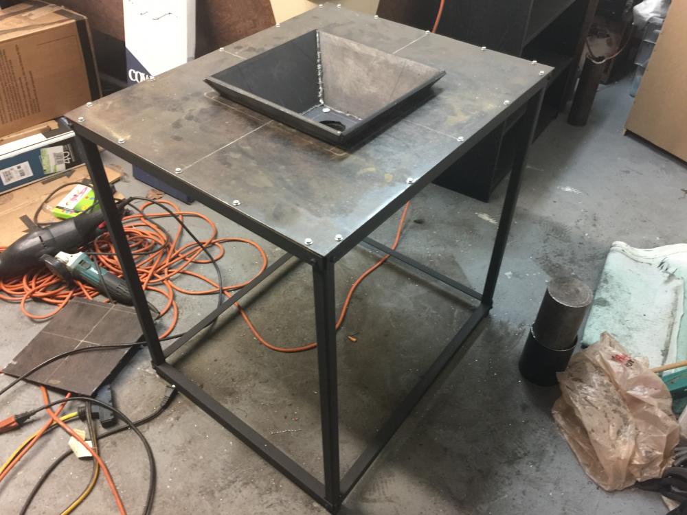

  23. ***Update*** Progress has been a little slow due to some unforeseen work stuff but I am coming along for sure! Forge is coming together nicely. The firepot is 13x13x6 making it 4 1/2 inch deep. It is constructed of 5/16" plate steel. The forge table is a combination of 1" square tube and angle iron with a top of 10 gauge sheet metal. The tuyere and air pipe are cuts from a oil drill pipe. I harvested all of the metal from my local steel yard's drop pile. In total I have spent about 80 dollars in metal and I still have enough of everything to build a nice work table and a tool rack. I will be adding 2 inch skirts all the way around the forge to keep the coal in.
