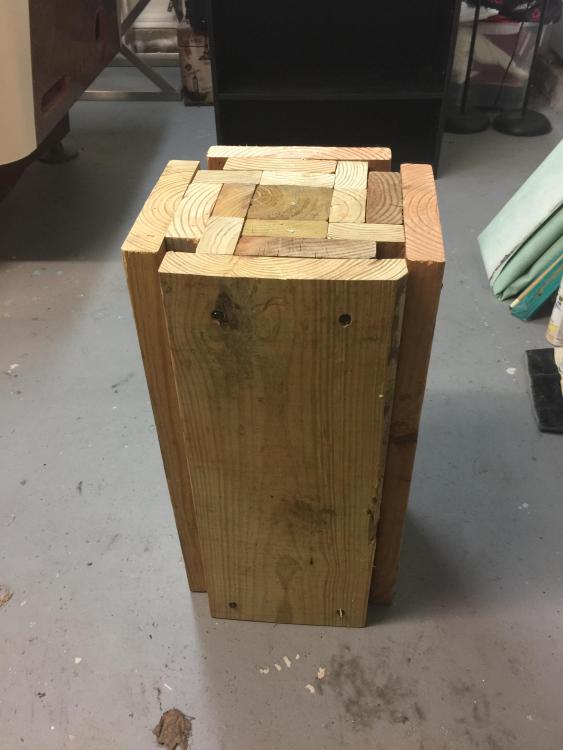

  5. Well I've been up all night working on it. I decided if I was going after an anvil object this weekend, then my block needed to be ready to mount up... so here it is. Each board is glued and screwed to the boards touching it and then 4x 8" lag bolts from each side. All that's left is to smooth out the top with a quick belt sander pass and to slather it up with polyurethane to weather proof it and fill any cracks. What do you guys think? I know it isn't perfect, each piece was cut from scrap that's been under my deck for almost a year so a lot of work went into pulling all the bends and bows straight. Regarding the holes at each corner, I'm planning to drive a piece of 1/2" pipe down each hole to use for accessory holes (like a Hardie?)

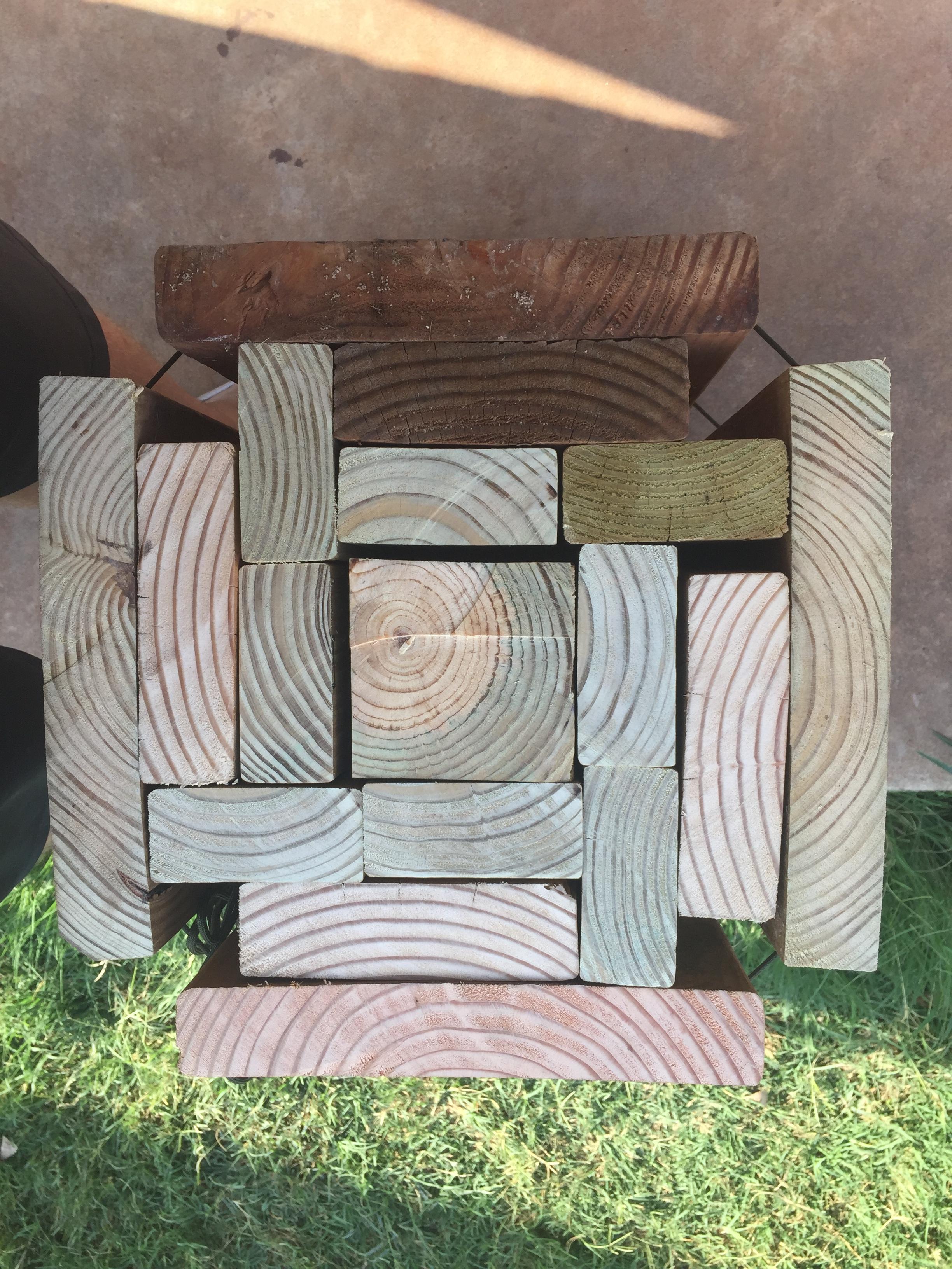

  11. I think I will be following Charles advice and start out on a coal forge. The money makes sense as I already own pretty well everything I need to build a nice one but mostly because that will get me going and learning. I'm a relief operator for Goodyear Tire & Rubber Co. and in a given day, I operate several hundred million dollars worth of machinery that takes months and even years to learn. When I equate that to forges, it would make much more sense for me to learn on something like a basic coal forge and then work my way into the more advanced propane forges. I also sourced some coal here in Oklahoma. I can buy it for $140 a ton from Salt Fork, or I can buy it from TSC right down the road from me @ $5.99/40#
  12. All the lumber was cut from scraps that I had left over from a deck project that I did. Most of them have bows and bends in them so I was planning the slather it up with wood glue and then use clamps to pull each piece straight before being screwed together. I'll start with the 4x4 In the middle and work my way out until they are all one piece at which point I am planning to run 2 pieces of all thread from each direction and finish with steel straps accompanied by a hearty coat of poly as this will probably spend a lot of time outside. I hope I'm not missing anything. Arkie that stand looks nice. I have a little extra 4x4 but was trying to save it for legs to a small work table to sit next to my anvil stand.
  13. Mr. Powers you are an inspiration regarding the corners! I think I have just the thing. I maybe should have clarified but the gaps between the pieces are only there because the boards aren't attached to anything yet, I stood them up on end just to take the picture. Once it's finished all the bends and bows will be straight and it will have kind of a butchers block look to it.

  16. Well there's no bottom in the hole so shouldn't be too hard just to move it in the event I drop something small enough to go down a 1x1 hole?
  17. I raided my scrap pile today and put in a little saw work, and here's what I've got so far. I'm brand new at this so this will be my first stand. Planning to mount a 6" diameter steel cylinder as my anvil object into it. I also left a 1x1 hole at each corner for build in tool holders and then will affix more to the outside its not glued, screwed, or strapped yet hence the gaps when it's done it will all be flush and solid. They're just tied together with 550 cord to hold the shape

  19. Haha yeah I know the feeling! Thankfully my wife does her own nails but those hair appointments.... you know... lol Anyway, I've had a productive afternoon of digging through my own scrap pile and after a little circular saw work and some puzzling, here's what I've got. Not finished by any means but glue, strap, and sand and it's ready for an anvil. I figure before I actually glue and strap, I'll know exactly what shape and depth my anvil object will be at and I can precut at least the 4x4 in the middle to fit. I may end up going with a 20# sledge head for now and having the 4x4 in the middle would make for an easy fit. I think I'm going to leave the 1x1 holes at the 4 corners to make for 4 extra tool holders in addition to the ones I will have off the sides
