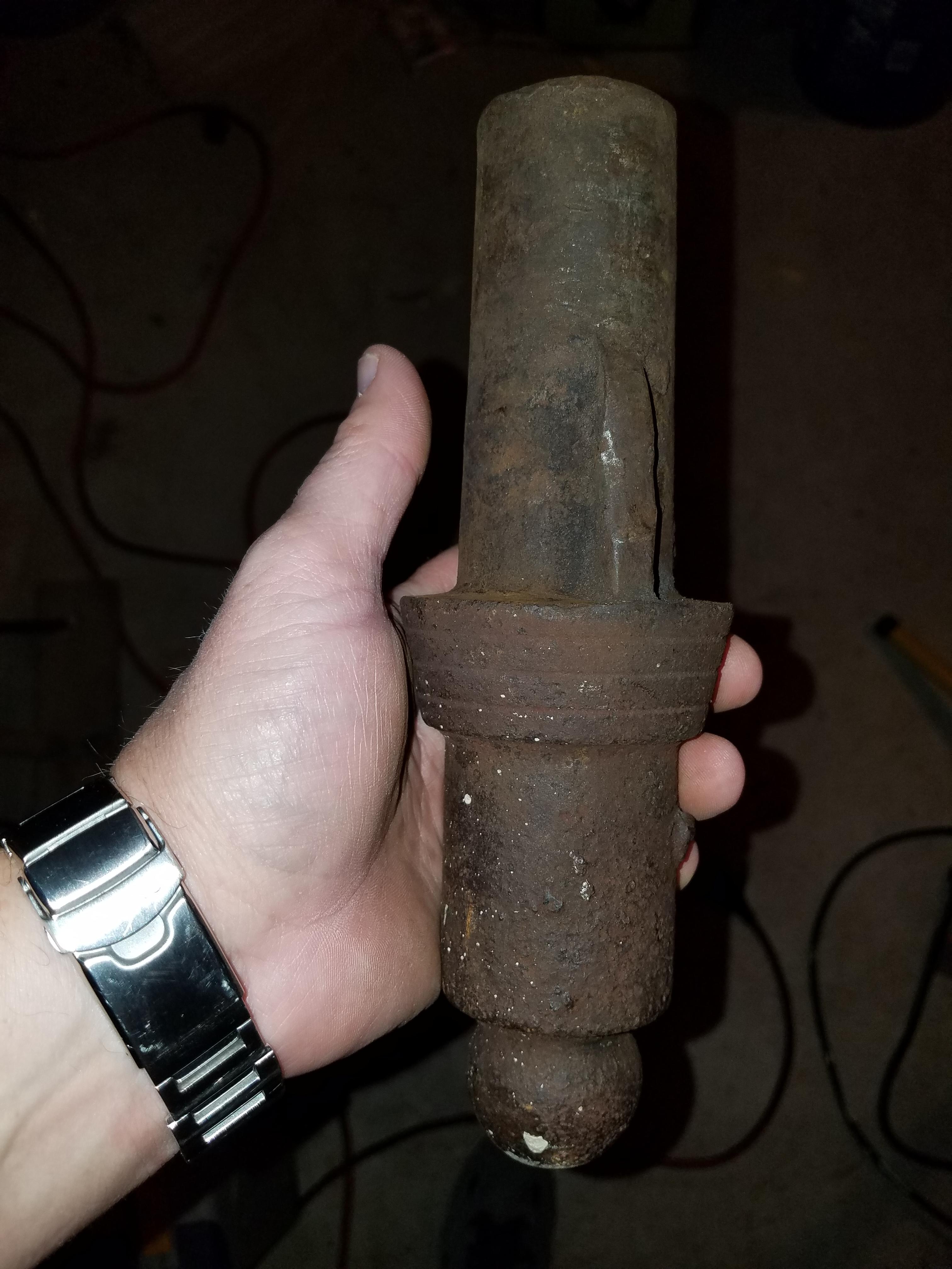

  1. The blower seems to be in pretty good condition, I think I will do as you guys suggest and pack it with clay/sand and see how it goes. I love giving older stuff a chance but I really would like to get away from my propane forge and start learning solid fuel coal and charcoal forging.

  3. Thanks for the advice. I will drill it down by the bowl where the crack seems to stop. I will give it some TLC and hopefully get it up and running. I will research and make a decision on how to 'clay' it as I do not want to damage it further. Looking forward to the project.
  4. Good morning monks of the coal forge , I have rescued a coal forge, which I am very excited about, and was getting it cleaned up and about to start fabricating a new Tuyere. However, there is a stress crack off the firpot (see pics) and someone has repaired it with what looks like JB Weld or something. I know I need to mud the main basin, but is this usable with the current crack?
