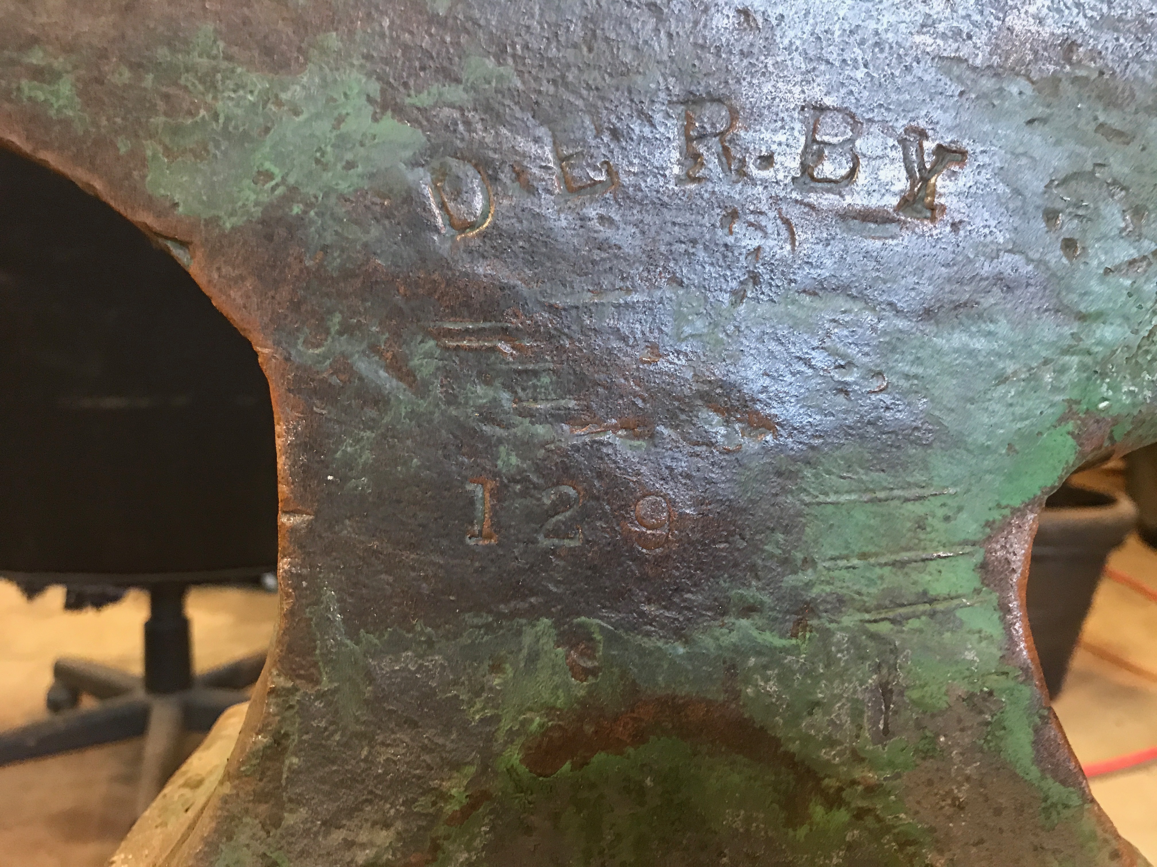

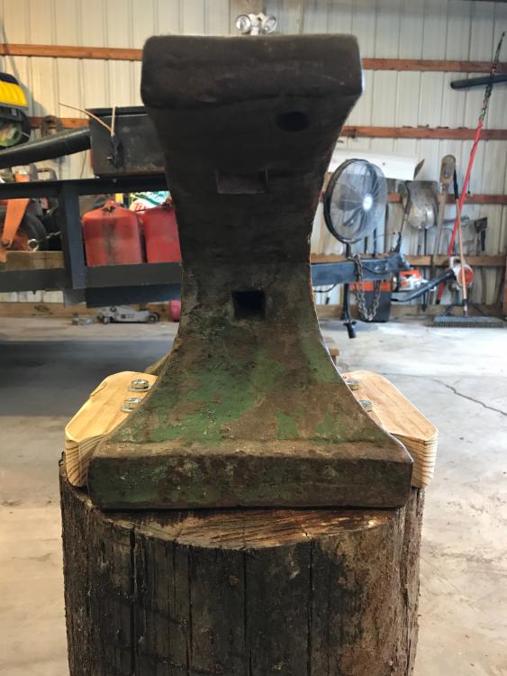

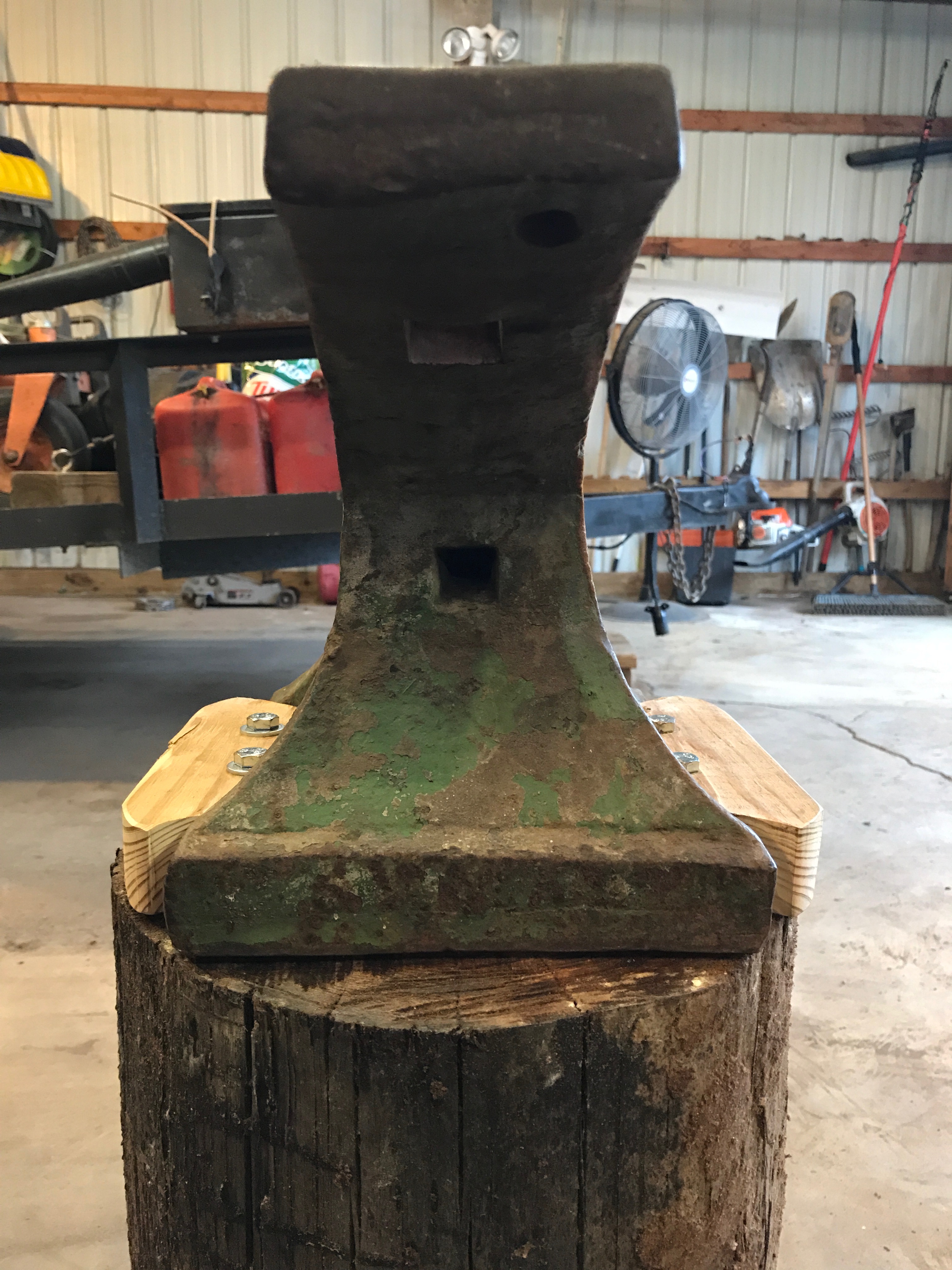

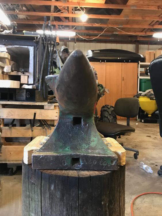

  8. Thank You for your replies and pictures. I love finding out the history of the older anvils. I wonder what the Backwards B is about. I assume this Early Trenton is also a DERBY like the one posted pics of.
  9. Thank for your replies. Does a first year production Trenton, place it some where in the dates I mentioned? (1900). And would it be a correct assumption that first/early years means an import? Black Frog one more question if I may, cuz you very certain, what about the anvil makes it an easy distinction from the PW's with similar characteristics?
  10. Hello, I am looking for help with Identifying this Anvil and Year. So far research, which includes talking to a 2 Blacksmiths and of course consulting AIA, has turned up some info, but conflicting. The 4 handling holes and step on the front foot would tend to lean towards a Peter Wright. However Trenton Anvils also used a 4 hole handling design around years 1900 to 1907. But it seems the Flat bottom was only used on Large Trenton Anvils. the 129 definitely is the weight in pounds not kg's. Trenton Used an "A" in the serial number and on the Front right foot like this one has. I have no idea what the "O" or " ZERO" is meant to represent on the front left foot. A page from the AIA holy grail made a one liner mention of DERBY being a company that would have had the Anvil made for them around 1900 to 1901. It seems as though another company possibly comes into play...Columbus Forge and Iron Company. Apparently CF & IC made anvils for Hardware stores and other Brand names, but on most of those the Trenton logo is still visible or noticeable somewhere. On this anvil there is no other visible marking other than what the pictures show. Besides all that it has a nice ring and descent hammer rebound. I was hoping the Farrier Clip horn would help with identifying however AIA shows PW and Trenton making a Steak design Horn with a Farrier Clip step in very similar positioning. Any ways, any help is help full and much appreciated. BTW paid $350.00 for the Anvil at an Auction. At this Auction was one right next to it that looked exactly the same, but had the Trenton logo on it. that one sold for $650.00. Thank you again for your help and or comments.
