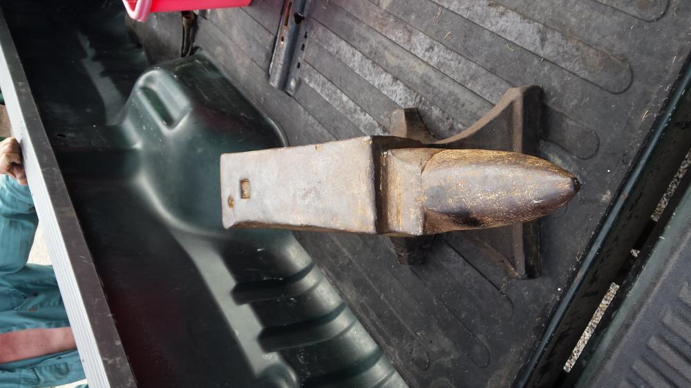

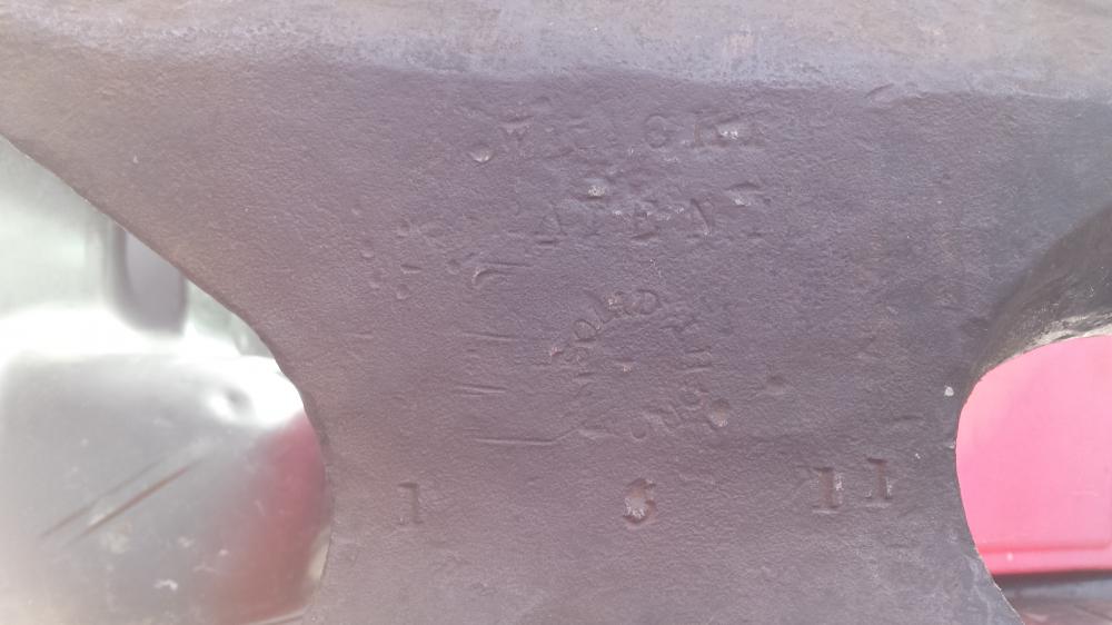

  4. A friend of mine purchased this anvil but doesn't want it now. He says its English and weighs 189 lbs. It looks to be in better shape than my Peter Wright, but I can't read the name from the picture. Anyone have any ideas?

  15. My brother in law just aquired this anvil. It's mine for $350 if I want it. It appears to be a Peter Wright, but the one side has a bevel on it and the name "Peter" is not there. All other markings are there, but that bevel makes me think that edge was damaged beyond repair and simply ground or cut away. Is this thing even a real Peter Wright? Still has good rebound and no dead spots
