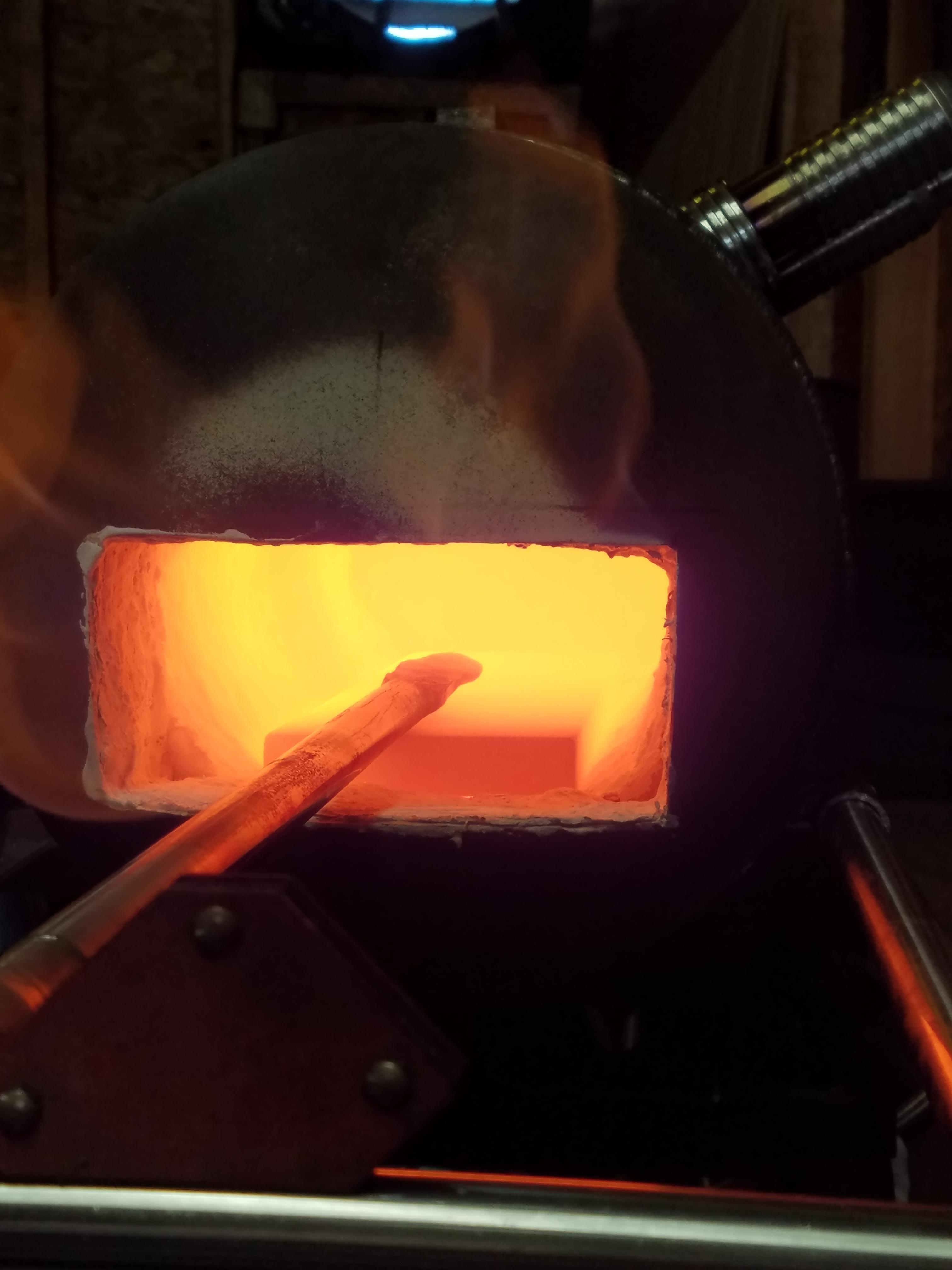

    So with all the fun I'm having, designing and fabricating. The main part is done. This thing gets hot fast and stays hot. I can't complain so far. This is running at 2.5psi.

    So with all my due diligence and all the research and I've done on this forum along with the Internet for flame tuning. I now can want to ask for experience on my burner. I still think I might be running a little lean seems like it's a little too white for the blue flame. Yellow DRAGON BREATH had been dialed back. It is a 3/4" with a 1.5" DOM tubing machined to slide and set screw into position on the main body. It has 1:12" machined into the nozzle. Also set @ 5 psi. I got rid of the crap nozzle in the second picture.

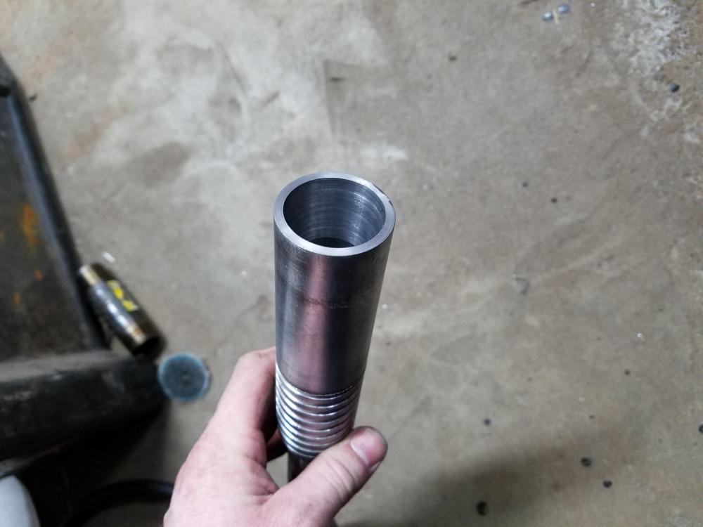

  10. I agree completely I'll post a video or pictures hopefully by the end of the weekend with a running two 3/4" burner forge. Here is my burner setup that I made. The three 8 32 screws are removable which allow the complete burner assembly to be extracted to exchange tips if need be. Since the photo I pulled out the adjustable baffle plate it is not needed it burns clean from cracking open the regulator on up to 30 PSI perfectly. I also shaved down the vortex plate to be super thin and sharp to allow the cleanest air flow. The nozzle is stainless and the threads are also machine out just like the intake
