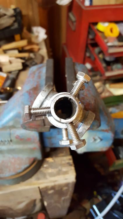

    Frosty, Call me Joe. I do have the ability to move the tip. I sanded the fittings to move in and out freely. Sadly the schedule 80 1/8" pipe nipple does not exist in my area; and I can't for the life of me drill a straight hole with a hand drill. So I have to make do. Hadn't planned to put it in a forge. I was going to try and use like a torch. Possible an edge quench or working with something small on a vice. I know, not the most efficient but I can't afford a torch setup right now. Picture is a little off center.

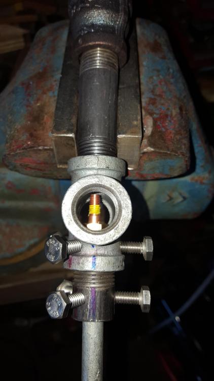

    Frosty, I've made some changes. I went with a shorter burner tube. I tried 4" then 3" with the .035 tip. The 3" seemed better with that setup but still not a good flame. Then I went to a .023 tip still with the 3" tube. I will attach pictures of that flame along wit pics of my jet tube assembly and mounting style.
  4. iamjoe replied to Mikey98118's topic in Gas Forges
    Buzzkill, Thanks for the feedback. I was thinking it was running rich. Will definitely change the tip and go from there.

    Folks, I hope I'm posting this in the right place. I've built a new burner tonight and could use some of the knowledge from you gents. I'm using 1/2" burner tube 6". A pipe cross for the air intake and to secure the jet tube. I have a .035 welding tip for the orifice. I can adjust the jet tube in and out and for center. I've moved it all over and this is the best flame I can get. I have a 0-40 psi regulator, no gauge but this is two full turns on the regulator. If that helps. 20170622_203850.mp4

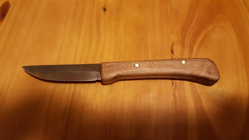

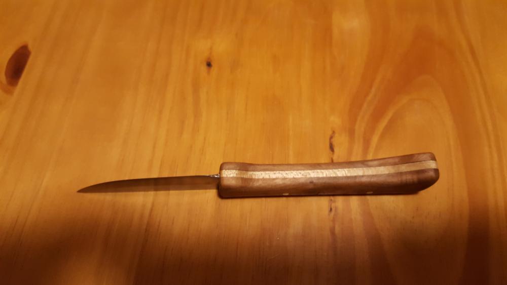

  14. Finished the handel on my first knife and planted a tree and made a baby blanket.
