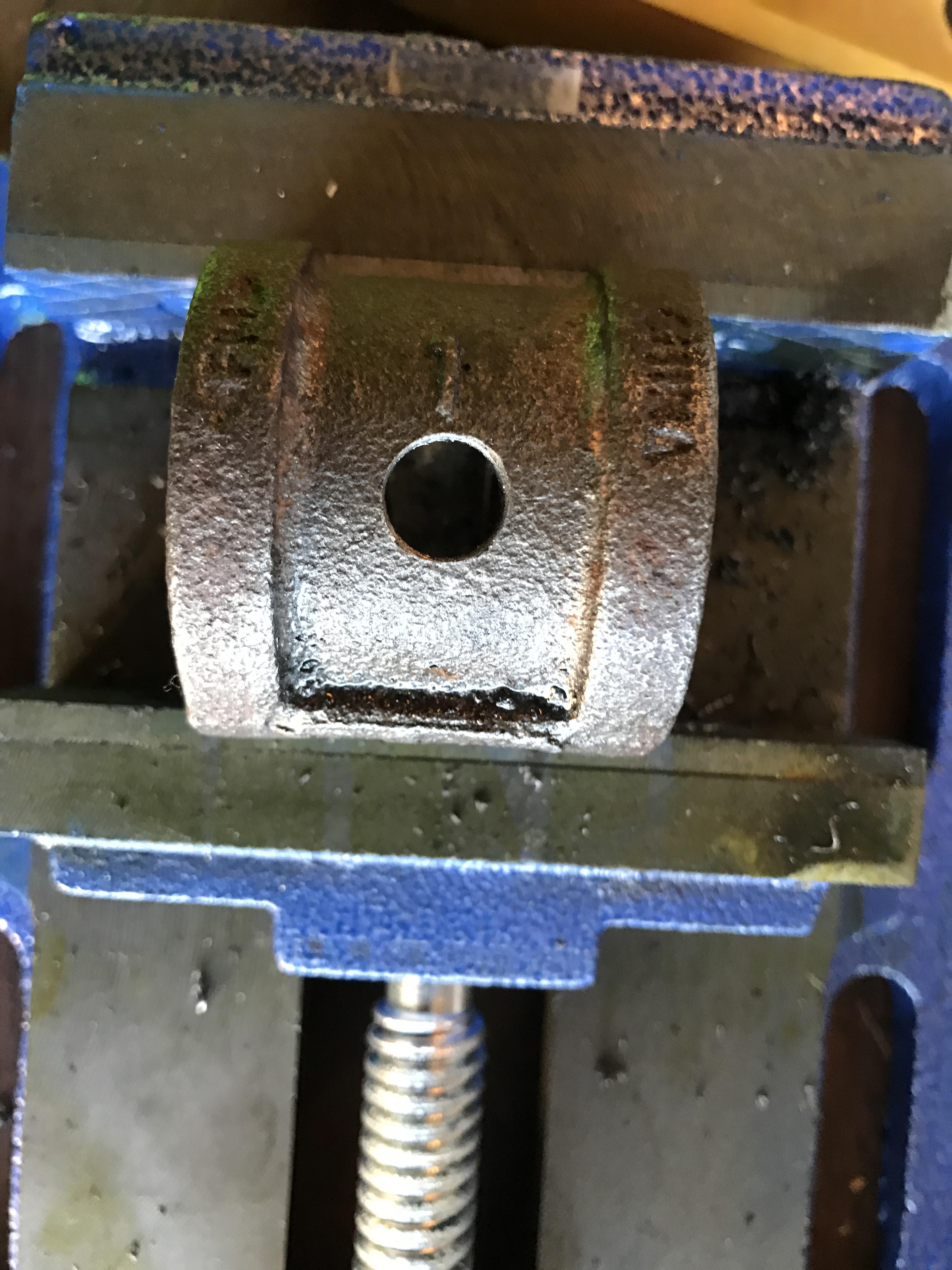

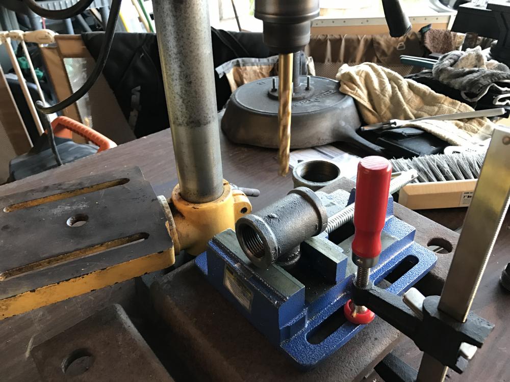

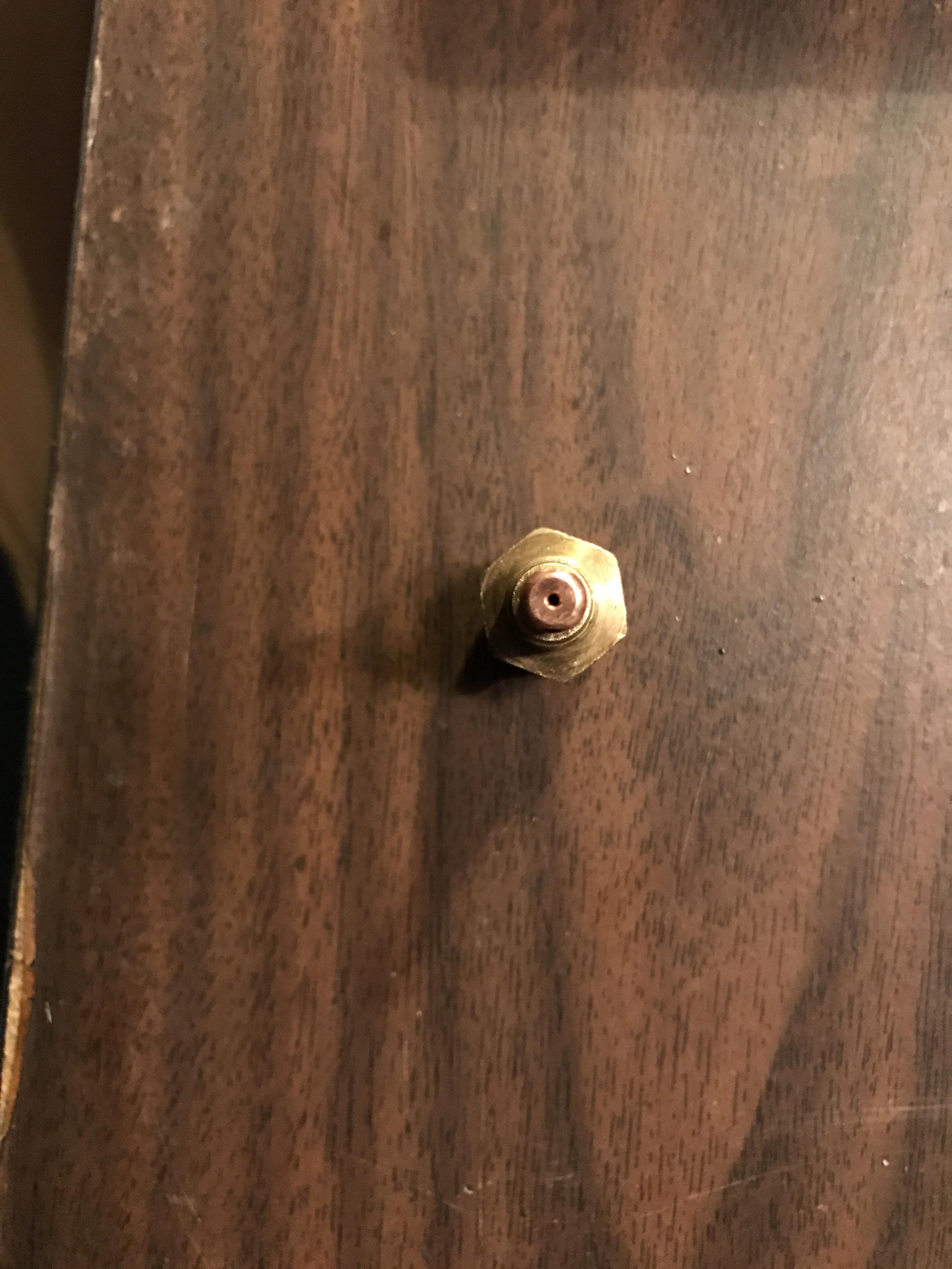

Thank you! I knew I should have left the T fitting in the vise. I pulled it out to inspect the hole I drilled and then realized I would have a problem lining the everything back up to thread it. I don't know why I even inspected the hole, BC I'm not even certain what I was looking for. And yes, I did unplug the drill press. When you stated that it goes against everything you know to do it that way, I took heed. I can only imagine all the carnage involved in learning that lesson the hard way. I need my hands to work and I've grown rather fond of them over the years. I'm going to get a floor flange tonight and practice it a few times tomorrow. I pretty excited to see how it goes tomorrow. I'll keep you posted. Thanks again for the help.

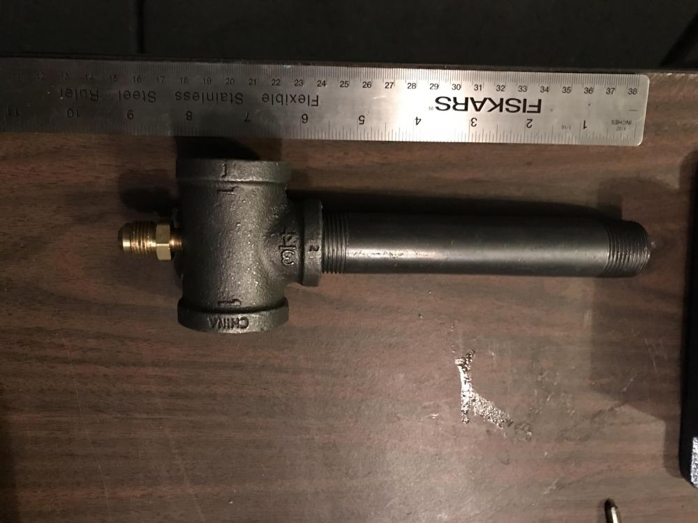

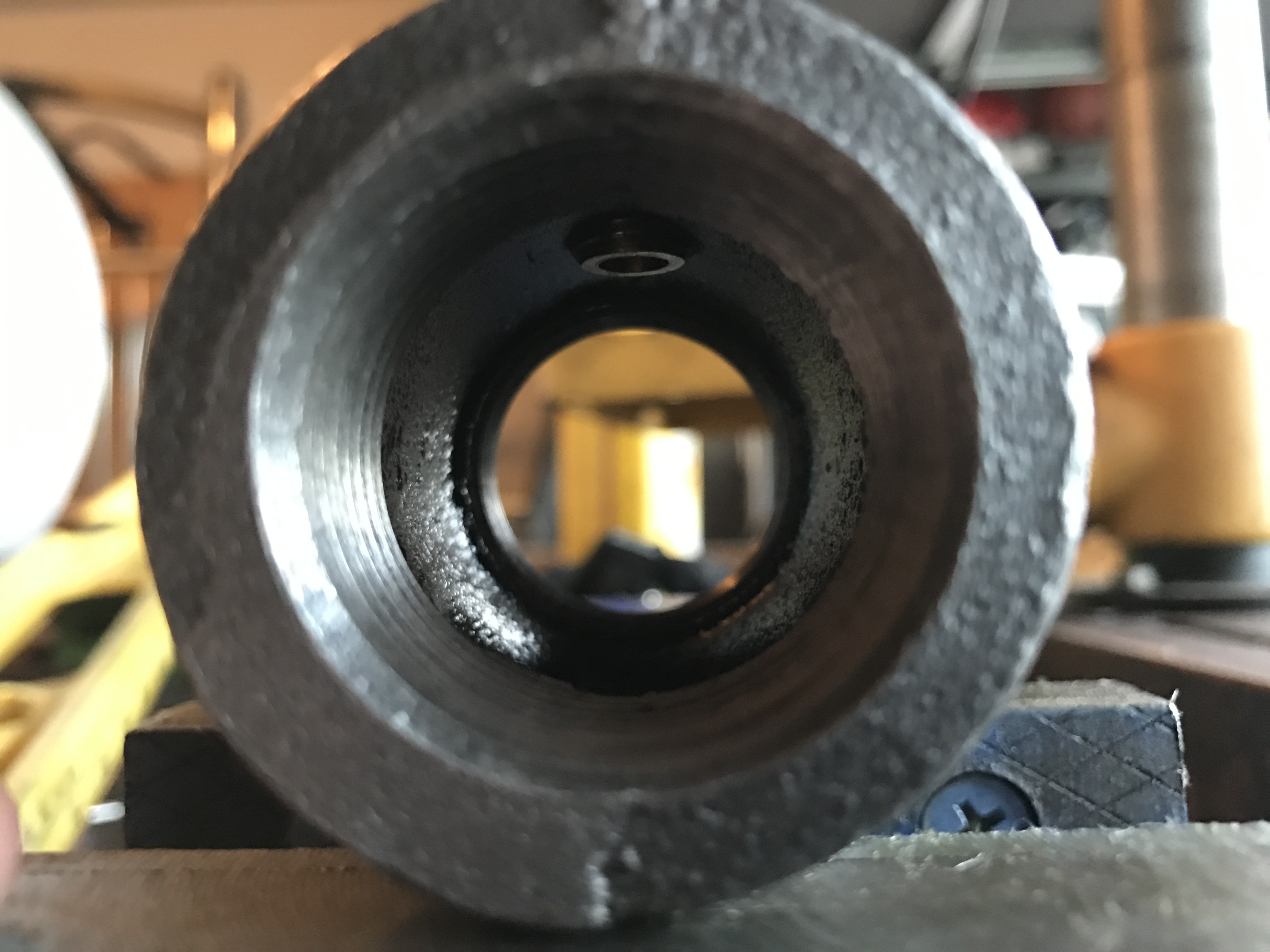

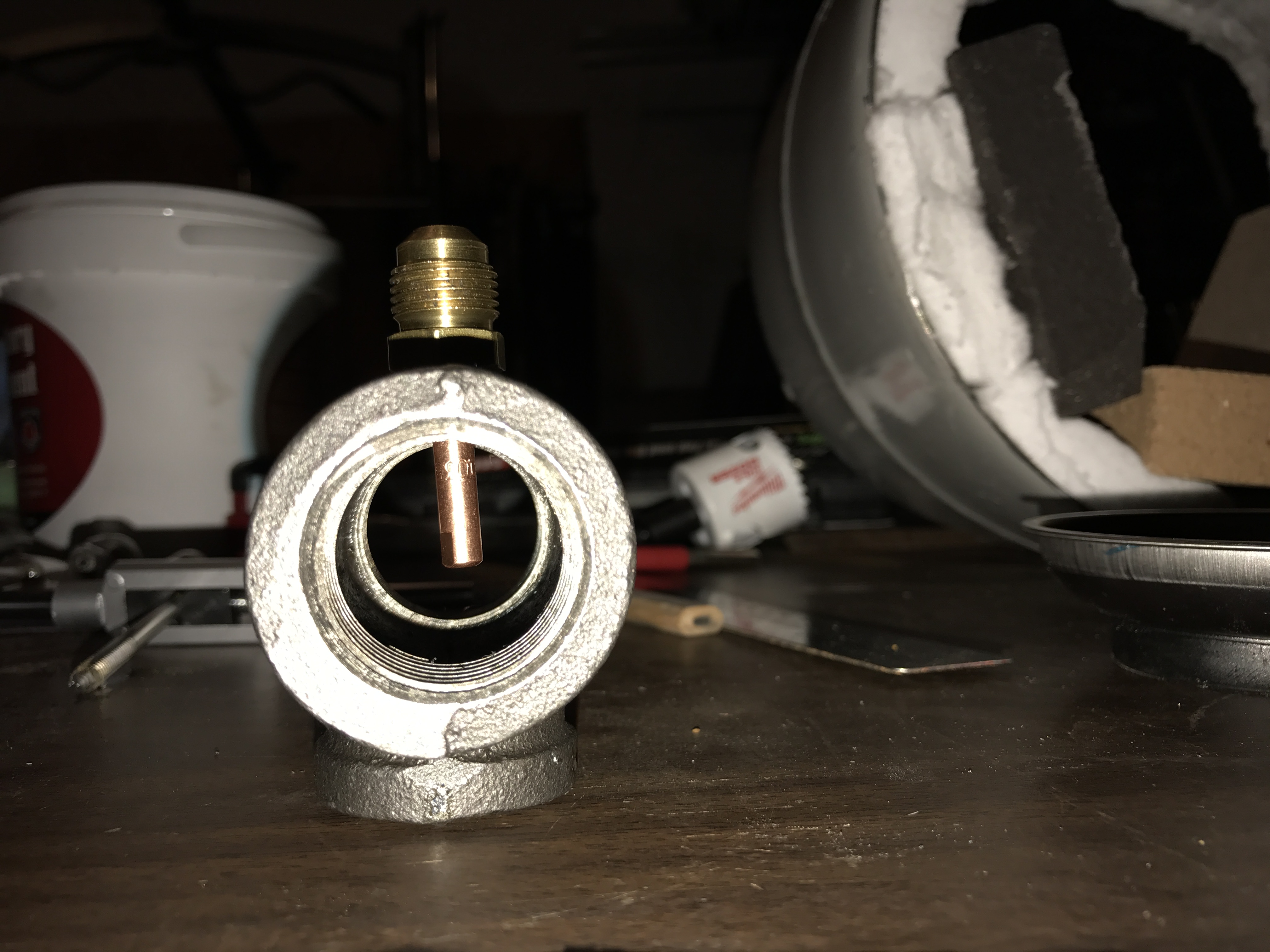

Frosty, Hoping to get a response from you regarding the burner I put together. I experienced a few problems to say the least. I attempted to use the "chuck" to start the the threading but I screwed it up. I tried to hand turn the press while the chuck was inserted, but I couldn't get the bit to turn. Not sure if it is a safety feature or what, but the drill press would not spin once I tried to hand turn. So I went to the hand and eyeball method which turned out like junk. I'll need to practice a few more times on some scrap pieces to get it down. I quickly realized the domino effect of having a bad tap. Everything else was completely off. Thoughts? Concerns?

Thank you for info on the taps! If you see the the pipe I threaded, you would have thought I tried to do it while standing on my head. It's terrible, but now I don't feel so bad. The pieces were labeled a certain size, but they were not accurate. I ended up buying both an SAE set and a Metric set BC I couldn't get the threds to line up correctly. And then the bit had a really hard time staying in handle BC is is really cheap. I think it's made from recycled coke cans. I'm going to reach out to Frosty again and see if I can work on the method where he uses the drill press to start the threading process. I'll keep this thread updated with the progress.- 15 replies

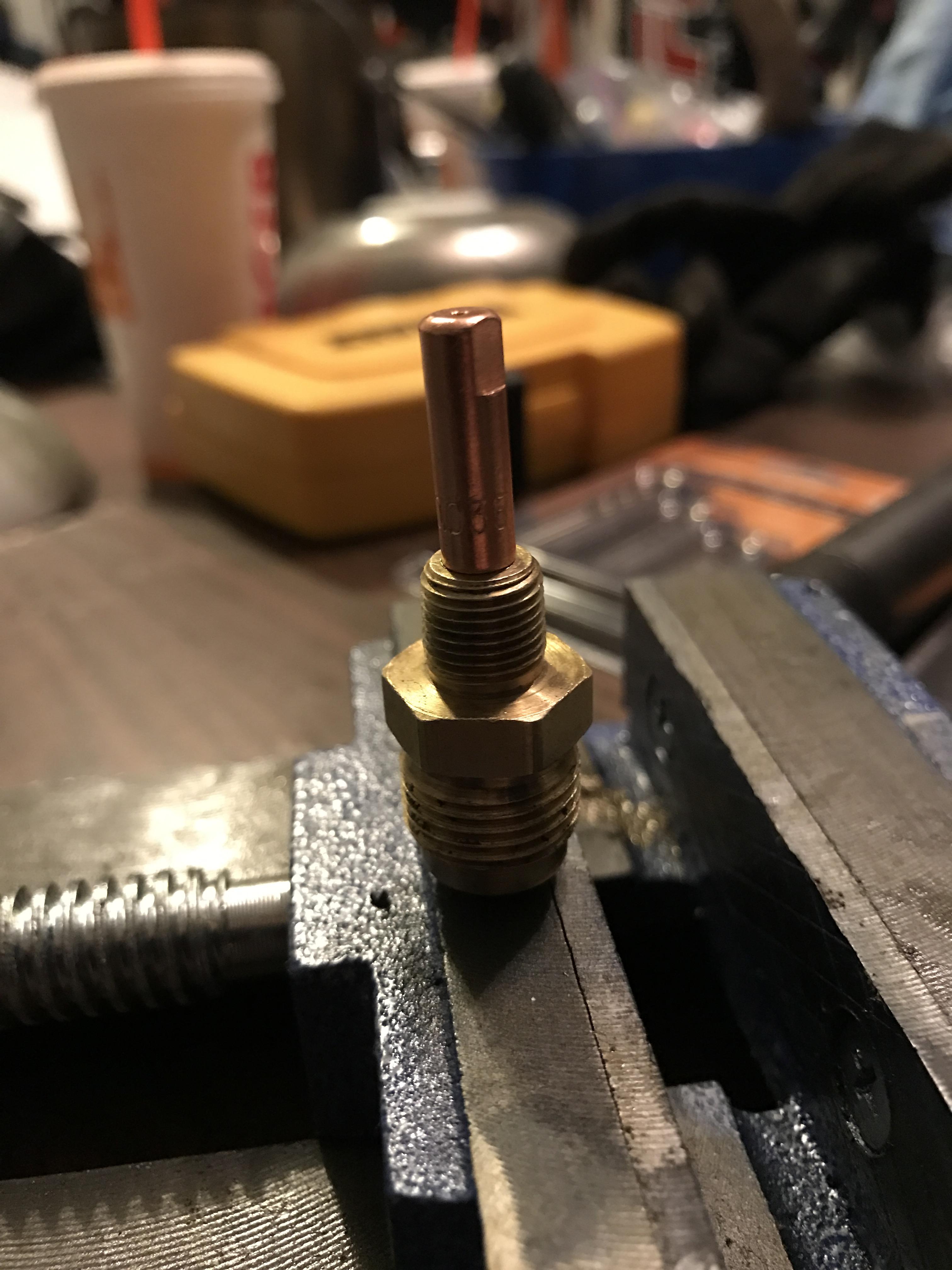

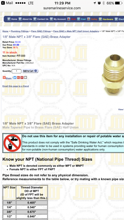

Stockmaker, Thank you very much for your quick response and willingness to help. I'm having a really hard time finding the correct part. I wanted to go with the hose for the propane burner so the 3/8 flare makes since. I'm stuck with relying on a google searches for the part because no one in the big box stores in San Diego know what I'm asking for. I found the following part by searching 1/8" MPT x 3/8" male flare. Is this correct? I want to order several of them because I know I will make mistakes along the way, but I really want to learn how to do this.
Can someone please confirm this is the part needed for the T burner? Living in the city has limited my ability to get certain pieces so I been to multiple different areas to get the parts.
