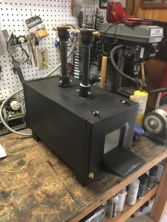

  5. Thanks for the input guys I need it. The finger holes look sharper than they are they are well rounded and it is very comfortable in the hand. I used some high carbon steel I had in scrap. Heat treated with motor oil and a quart of trans fluid and yes it did warp a tiny bit at the Chou as you call it. The wood is just some poplar I had laying around. The shallow bevel is because I just didn't know how deep to go. OverAll it's very sharp and very comfortable in my hand. I'll keep taking all the helping pointers I can get. Starting a skinner knife tonight. Her is a pick of my forge. 10 inch square by 18 inches. I tug welded from flat steel. 2 inches of ceramic wool then lightweight firebricks inside. Oh and my first knife.

  10. Yes I will thank you. What burner would you recommend?
  11. Yes I did, tried a few friends forges and put together what I thought I would like. The only thing left to do is coat the wool with refractory cement and am awaiting the fire bricks. Fired it last night for the first time and it heated steel real quick. I have a few friends that now want one just like it. The only thing is I might want to try some different burner types but overall I am real happy with it. allowed me to practice my welding too.
