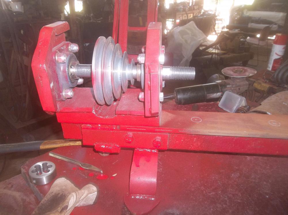

  16. Let me further elaborate on this hinge Jig concept.A picture is worth a thousand words,but I'm too lazy to make a diagram so picture this in your minds eye. Let's say we need over a hundred pieces of 1x1 tubing 10" inches long that need a quarter inch hole drilled in them at two spots. Well instead laying every single one of the drill holes in every piece we'd make a jig. For this jig we would probably use a small piece of plate for the jig base and small piece of angle iron down the side to hold the tubing and a couple of butt stops. We then lay out one piece and figure out where the holes need to be drilled and then we would drill some guide holes in hinge. Now the hinge I'm talking about are usually these weldable 2x2 hinges you can find at any hardware store but yeah after we drill these guide holes in the hinge we then tack it at the right spot on the angle iron and have it flop down onto the 1x1 tubing. And there you go.. You need have a nifty speed jig for drilling thousands of these parts.

  20. I was able to take a few photos then my camera messed up today.. So this may be the last update for a while.. On the main drive shaft that goes into the head stock I used a cape chisel to cut a groove for a half moon key that the step pulley rides on. And it was a real pain but I was able to cut threads on this shaft as well...... Nobody offered up any suggestion on the tread size I should cut, so I went with what I had which was NC 8tpi and I should be able to find a backing plate that will thread onto the shaft and the lathe chuck will bolt to it... Not pictured but I've taken a fan motor and have it mounted and I'll probably use a rheostat to control the speed and I'll start working on the lead screw and split nut here before too long. While I don't expect this thing to hold tight tolerances or anything like that, it's still better than having no lathe at all to turn wood and metal on.......... to be able to take an oversize shaft and turn it down to fit into a bearing like I had to do with the main shaft here would be very useful I feel anyways.
  21. Little update,I took Frosty's advice well almost. I went with the DOM tubing and I would of liked to of got something a little bigger than what I got....I started to get it from some metal website but the shipping was ridiculous! So I wound up getting a foot long piece of 1 1/16th DOM pipe with a 1/2 hole 1/4 wall and I had to take it to a friend who has a mini Lathe and we turned it back down to 1" in diameter.. Some used flange bearings was all I could afford everything from ebay,. But I'm building the head stock.... Now you may wonder why didn't I go with a bigger diameter piece,Well.... The biggest hole in a step pulley that I could find was only 1" inch and that was almost 40 bucks! I also ordered a die to thread the spindle and it's like 1" 8tpi course right hand thread. I saw I can buy blank backing plates that already have this thread and I can screw that on then bolt my chuck to that. But yeah I'll upload current pics later on today..
  22. I like the ideal of 1" ID DOM mechanical tubing,Frosty, But this is still just a little lathe and I think I would have problems boring out a hole that big to fit the bearings , And the budget is really tight right now as well. I thought about saving up and buying a headstock from a micro lathe but again I think I can get away with the multiple bearing ideal. For no bigger than what it is I'm leaning to just buying a spindle that has like a M3 taper on it that way I can buy chucks/face plates for it off the shelf. It's just those shafts are not very long and fitting a pulley rather than the drive gears on it might be a little funky lol
