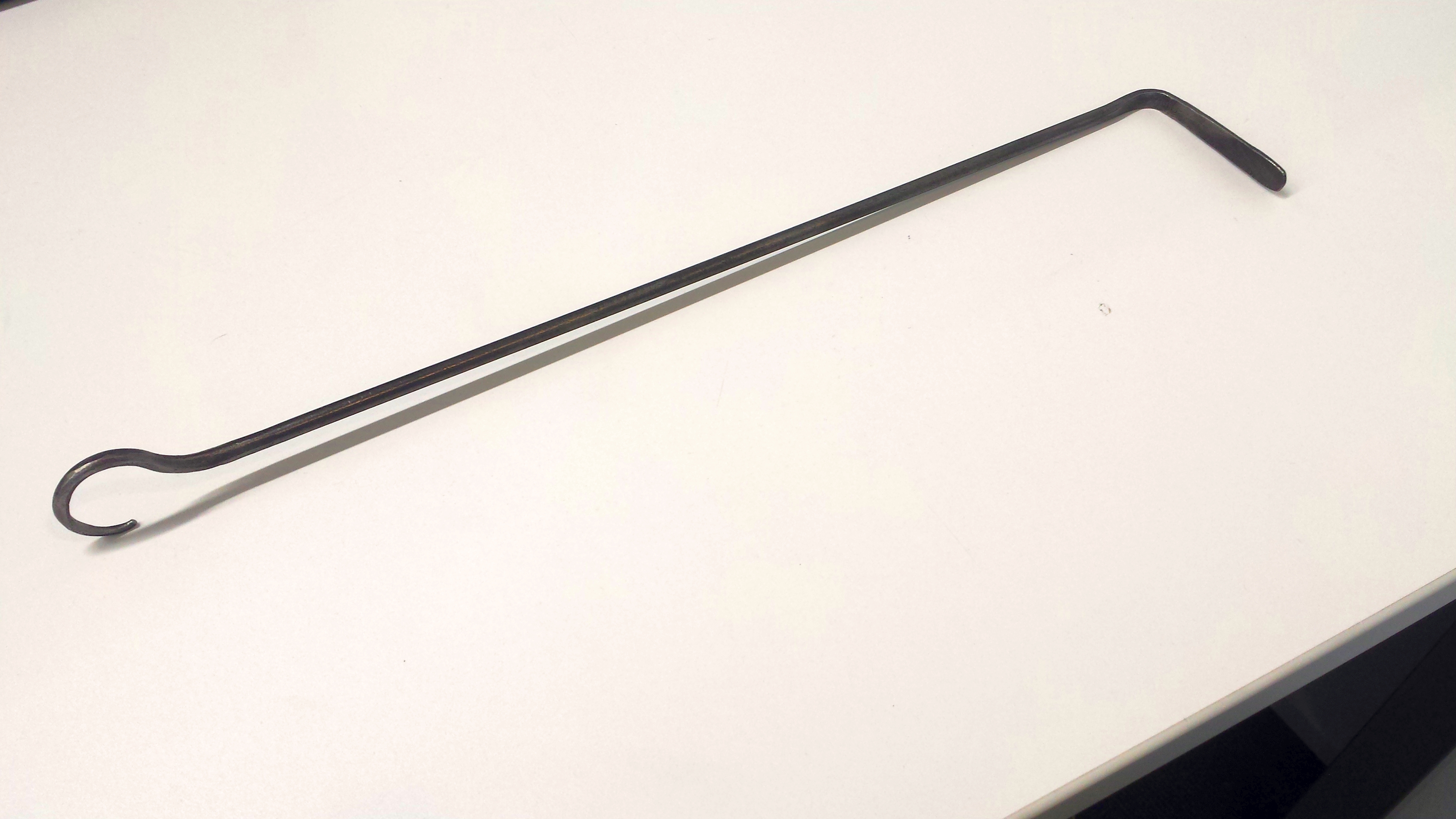

  3. That is good advice Bo, thanks. I did reevaluate my situation and settled down a bit on jumping to soon. I tend to do that a bit. I get excited about things and try to get the best that I can before I even determine what it is that I need. I got my forge fired up for the first time last night and learn a little bit about that tricky girl. I think I might have some rough coal. I used the Vulcan last night and it worked well (made a little coal paddle to pull the coal around in the forge, see pic). I get that pit in my stomach when I think I may be missing out on a good find. I am gonna just settle for a bit and use what I have on hand. And, like you said, if one comes around close to me I will have a bit more money then and an understanding of what it is I really want to do. The trip wasn't a total waste, I collect chainsaws and picked a decent old Homelite XL-925 for a song. Appreciate the advice. Always accepted and thankful. Regards, Adam
