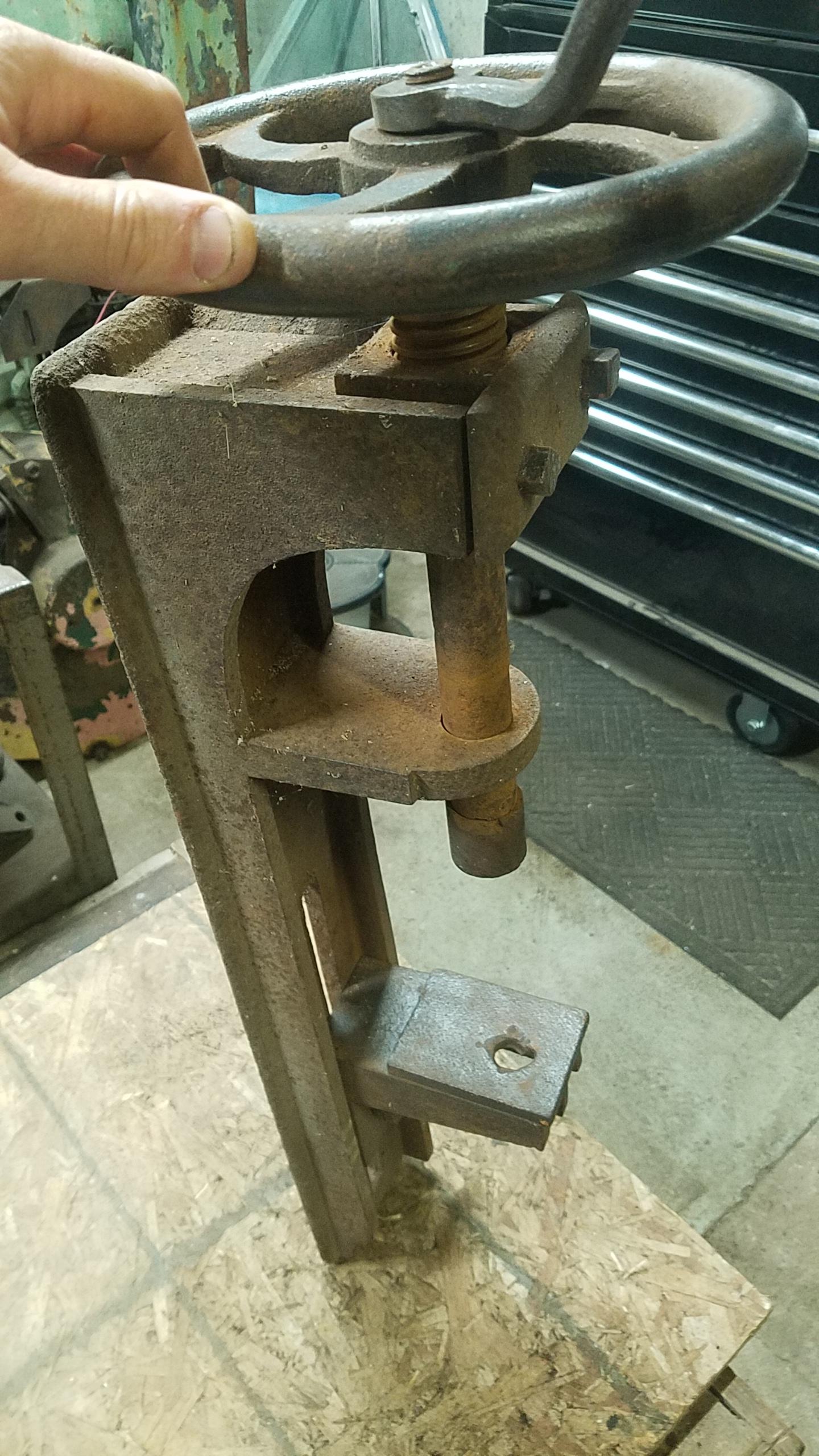

I bought this last year at a garage sale. I thought it was a simple post drill but with the Acme square thread moving the entire arbor down would seem like it would be a horrible drill. I grabbed it thinking I could use it as a small fly press of sorts for a touch mark maybe but would have to make the business end float on a bearing or something of the like. It looks to accept a square shank (almost like a bit brace). The bench looks like either it was drilled at some point or was a thru hole that got blown out. Maybe an early arbor press?! Any thoughts? Might use it for pressing rivets or something like that. Thanks. Paid $10 for it. Adam

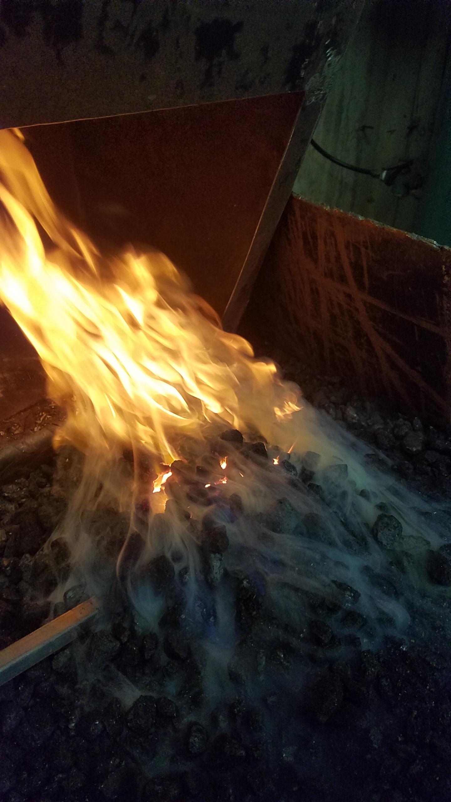

Hello All, thought I would share the design I came up with for my chimney/hood/stack/forge setup. Admins, wasn't sure to post it here or in the builds! This is primarily about my stack so... Please move if needed. So I read through a bunch of the threads on here and built my setup based on what seemed to be the consensus (with materials I had on hand). I was given a few 6'-ish pieces of 10" spiral duct and decided to build around those. I built my forge at the same time using the water cooled side draft forge design and the hood is built from the "Super Sucker Side Draft" design. I had a few issues with the tuyere being too close to, and too far below the face of the side draft so I made an adjustable setup where I can move the tuyere left and right (while standing from the side) and up and down to fine tune the hood (first pic shows the original setup, forth pic shows the modified setup). I can show more pics of that setup if anyone wants to see it. It is limited to about 2"-4" of movement, but I don't see it moving again. The forge was built from an old oil fuel tank I got from my neighbor. The base was from a recycle heat treat oven. I am using a blower that is in the base and piped out to the tuyere through the side. I control my flow with a VFD (variable frequency drive). I can come up to welding heat in about 5 minutes from the start of the fire. I didn't want to go through the roof of my workshop because I didn't want to try and deal with sealing a thimble with a steel corrugated roof. And I really couldn't afford the thimble for a 10" duct anyway. I couldn't find a wall thimble at 10" locally so I wanted to see if I could make my own with just store bought components. I drew a cross section to show the idea I came up with. This is primarily the reason for the post, to show a different way. I am also about 8'-10' away from the fire so the heat at the "thimble" is not crazy hot but it is warm. So take precaution, I am not accountable for anything that could go wrong with your setup! I can forge for a long time and not have any issues with heat. The vinyl siding on the outside is in direct contact with the 12"-10" reducer and I haven't seen any signs of melting or warping at all. So figured I would show the setup. Again, please be cautious and check temps regularly. Every time I fire up the forge, I am checking the pass thru inside and outside. The side draft works great, it draws like crazy (once it gets warmed up) and I am super happy with the outcome. I used firebricks I had from the recycled heat treat oven to take up the dead space so all of that is not coal! (pic shows an early setup of bricks, I ended up making a pocket around the tuyere and then making a shelf about 2" from the top) Forgot to snap a pic of the final layout. My water has antifreeze in it, that's why it looks rusty. Will be painting it here in the summer and finishing up a few things, but all in all I am happy. Hope this helps. Regards, Adam Edit: I wish I could remove the above pic from the post as this was not the direction for the thread, but what "not" to do for future reference.

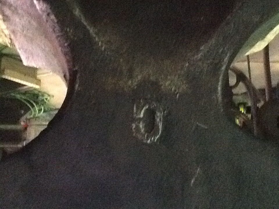

Yeah, I got pretty lucky finding an anvil in this condition. Most of the "texture" was just dirt and debris. Those were pictures of when I picked it up. Just hammering on it has clean the surface up quite a bit. The scale is a pretty good abrasive and helps clean the dirt off. I would just hammer on it and it will clean up. Anything that has transferred into my work piece I leave because I like the hand worked look of things. Or if making a blade, the texture comes out in the finishing process. My face is pretty smooth so I haven't notice any spots that transfer. -Adam -

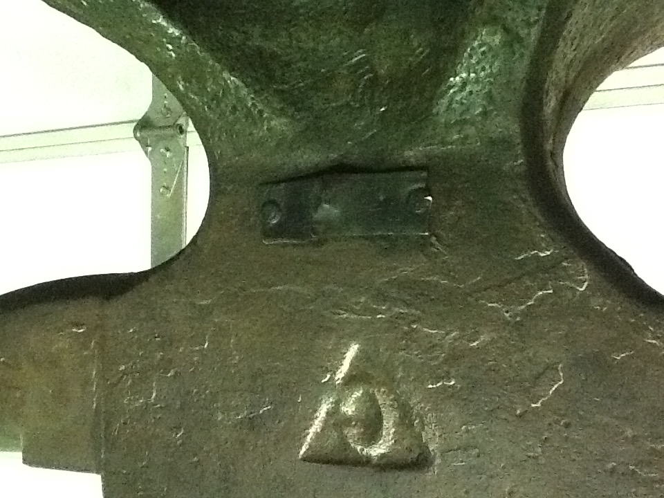

Thanks Thomas for the reply. I worked on the old girl a bit more last night and really noticed quite a difference from the Vulcan to the Columbian. I have to tie the anvil to the base but liked the feel. I found a bit more info on the tag on the side of the anvil. HSB & Co was supplier of all types of tools and supplies back in the late 1800's to well into the 1900's. Some re-branded stuff, some of their own stuff. I found a catalog from 1922 showing that they did in fact sell their own anvils, but may have had them made from a company. Their process they state doesn't really match the Columbian process from a stand point of all cast vs forged and cast. The weight on the anvil doesn't align with the ones they sell. Still interesting. I wonder if anyone has actually seen a specific "HSB& Co. Rev-O-Noc" anvil? Maybe they had Columbian make these? Anyway, interesting none the less. -Adam -

Well, I took the scale and weighed it. Came in right at 180. Rings great, no cracks, awesome rebound all over the face. Even on the horn and step. My one inch ball almost smacked me in the face on the return bounce. 80-90% rebound. Was hoping for closer to 200lbs but... the ol' girl looks almost new. Looks like a cast "C" or "G" on the opposite side. She has an interesting badge riveted under the triangled c that, I believe, reads HSB & Co and REV-O-NOC. Looks like it is a gun manufacturer amongst other things. Might be some cool history there I might try to dig up. Not sure if they sold anvils, or it was part of their shop and they tagged their capital goods??! Didn't get any off, so $2.50 a lb. She is a bit bigger than my Vulcan so should do pretty well. Happy and home, sitting on a stump in the garage. Waiting to be used. Sorry about the photos, they are from the iPad and not the phone (phone was dead). Will try to get a better shot of the badge in the daylight tomorrow. Thanks for the advice all. -Adam -
