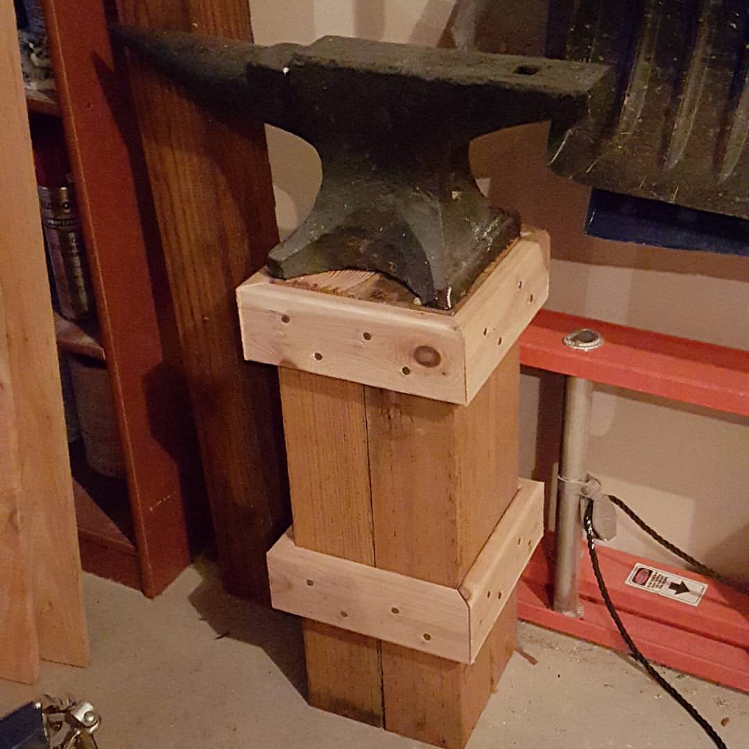

  12. Location added I also added a photo of my anvil stand below. I was originally planning to use a 20 lb tank for my forge, but my wife was going to make it to the town with free salvage tanks before I could so I asked her to grab a tank for me. I said to get one the same size as what's under our grill, and the 40 pounder is what she came home with... I was a little worried about the volume as well given the burner I had bought, even with 2" of Kaowool and IR coating (about 650 cubic inches), but I put the burner close enough to the front of the forge that I can fill up the back with extra insulation to start and have plenty of space to eventually add a second burner. I have read great things about the 3/4" T-Rex burner (reviewed here by Ron Reil, where he says the output is closer to his 1-1/4" Mini-Mongo burner) so we'll see. Thanks for the tip on the order of projects.
  13. Well, I took a blacksmithing class and was hooked so now I'm working on putting together my own "shop." I've been lurking here for several months and now that I'm getting close I figured it was time to join the community. I've got a cute little anvil - an 84 pounder - and built an anvil stand out of rough-cut 4x4 fence posts that I had to replace when they got blown over in a wind storm. I've also got a forge nearly built out of a 40 lb propane tank and using a 3/4" T-Rex burner from HybridBurners.com. All that's left is to weld the burner holder onto the tank and get some ITC-100 or similar to coat my 2" of Kaowool and I'll be ready to start banging metal. I figure the first order of business is a set of tongs, followed by punches, cutters and more tongs.
