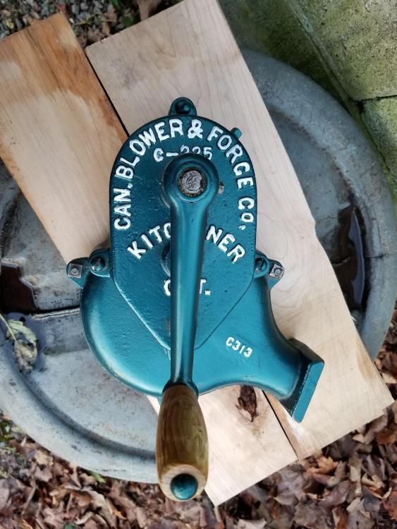

  1. thanks bud my brother in law made it hes a welder by trade. its preatty sweet.

  6. thanks bud i put some time on it 2 years ago when i was supposed to build my forge its all cleaned up and rebuilt inside i cant wait to use it now

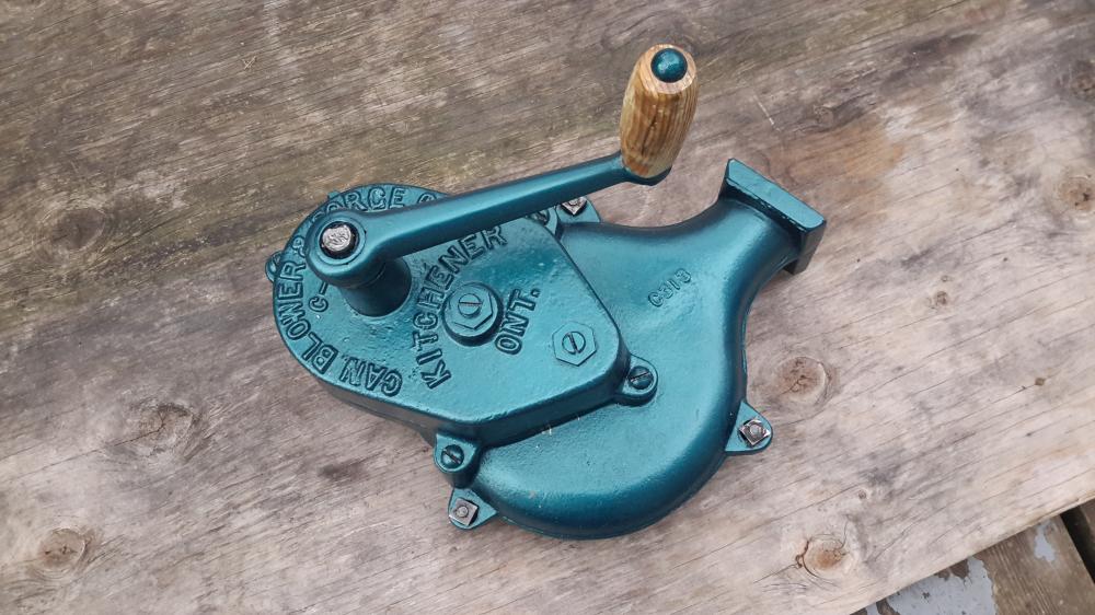

  9. nah i just ordered all the peices i need to build it,i really didnt want anything welded, i prefer the threaded pipe route to take down easily at anytime i want, i know it is more costly but i think since i might be moving the forge once in a while it might be better off that way and also probably better for cleaning it out, im going to pick up my 55 galon drums this weekend too so it will be just a matter of time to get those peices from the mail and theni can start making some charcoal and eventually start up hammering some hot metal from the forge im finally gonna get to use all tbat equipement i got haha

  14. thanks mate i think it came out preatty good as well
