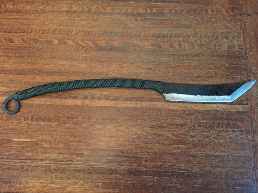

  6. otto replied to templehound's topic in Knife Making
    Wow, That's an amazing looking blade. What is the finish on the blade?
  7. Looks like that beast would cut through just about anything. Nice work
  8. I was thinking the same thing. I may change it to a solid color. No I don't. Let me tell you swinging a 10 pound hammer and holding the stock kicked my butt
  9. I was thinking light cutlass or wakizashi type blades. Not sure how the hilt would evolve single handed I would think.
  10. I like the what if part of this. I would think that if swords stayed in fashion a short slashing blade would evolve. Easy to carry in cars and around busy towns.
  11. That looks great. I have been thinking of building something that size. How does it work on 1/4" stock? I mostly do knives and small stuff and have been looking at hydrolic presses but think the speed of a power hammer would be better.
  12. Yeah after I finished it I thought it would have been handy on my last boar hunt.
