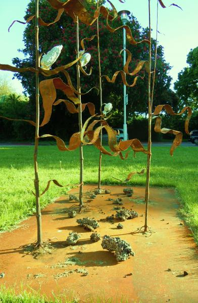

  3. Hi, maybe I made it, a pic of my last work, not really fine work, brute work, that's what I have done of those rebars...

  5. Very nice, I have worked on a similar subect this year, thousand miles away from you, amazing..
