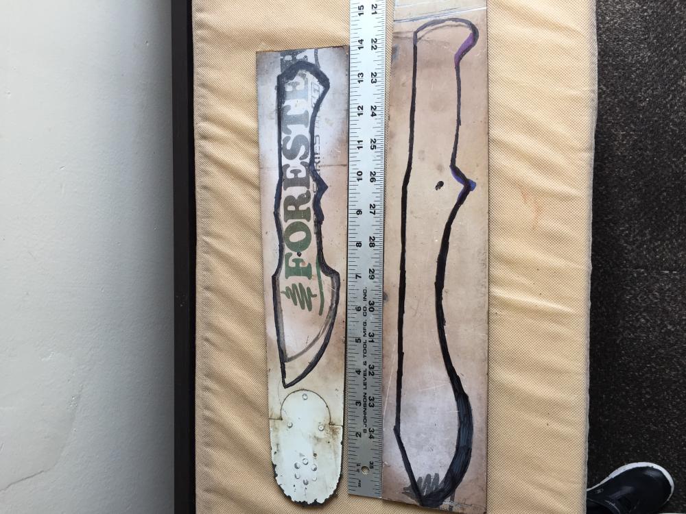

According to the “steel guru”; Any bar that is over 24” in length and is not pressed together with rivets is likely to be high to medium carbon steel. It should be noted that this person offered no evidence other than a good ole, “trust me, I know what I’m talking about…” I started with a Forrester blade and used this experiment period as a time to put together a little shop where I could work with known alloys at the same time.
This is the starting point:

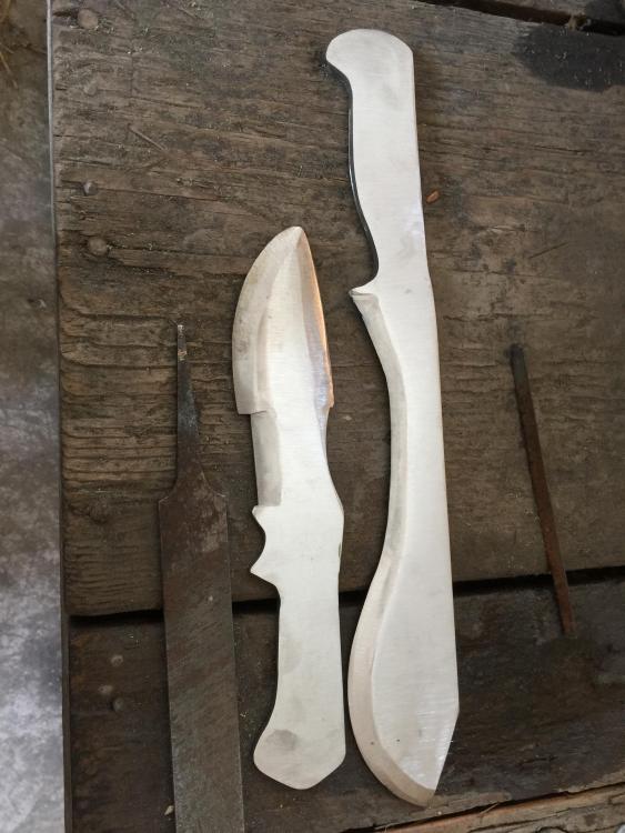

After the were roughed out using a file and hand sander to grind the metal I was left with this set of knife-shaped lumps of metal:
After these were roughed out using a file and hand sander to grind the metal I was left with this set of knife-shaped lumps of metal:

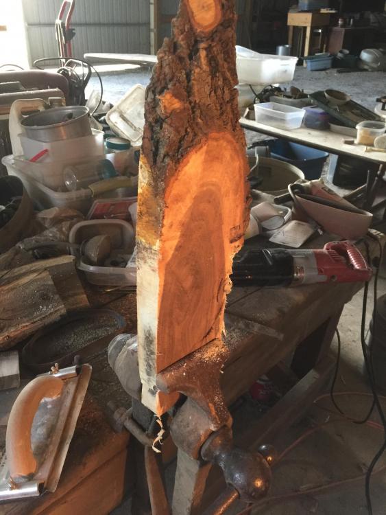

During this time, I also found a beautiful stump at a local side road and asked the owner to cut it down and keep the wood once it was confirmed to be mulberry.
Got some beautiful spalted wood and found that mulberry is harder than I had ever know wood could be. My Stihl hated it. I also took some time off to hunt Morels. Around this time, I also ran into the myriad of issue involved with trying to make a forge that is semi resilient and stable in heating my stock. This was beyond frustrating to try and do from scratch. Over a month of researching later I came out with a very close resource for dozens of refractory products from a reliable supplier in a nearby city and gained a great supply of O1 tool steel from Bohler-Uddeholm in a stroke of luck. This would later lead me to destroy my smoker from Bass Pro Shop.
