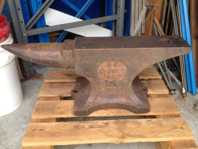

  4. How about this, absolute bargain, $2200 for the anvil plus a few pairs of tongs, top tools and branding irons worth about $150-$200. Say the anvil on its own is worth $2000 to the seller, that's $8.92/pound!!!!! and BK anvils are by no means rare in Australia.

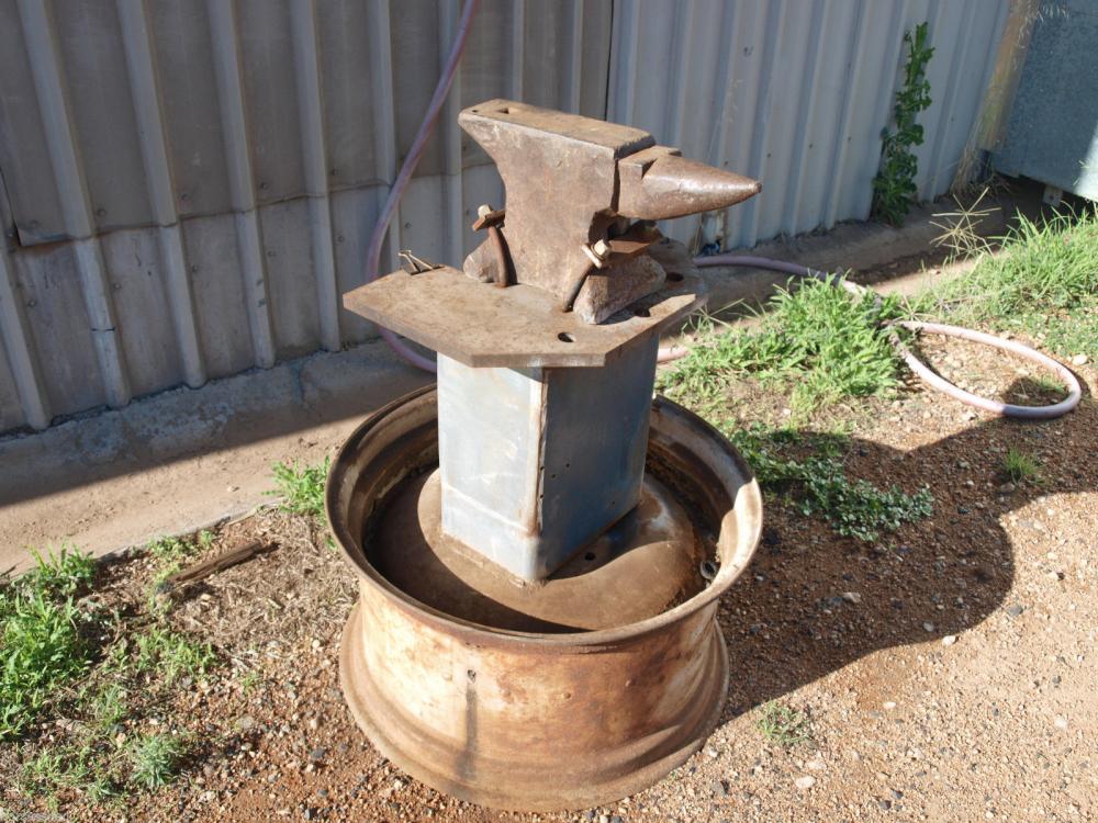

  5. Lol what a joke, sadly EVERY anvil here in AU is priced that way. There doesn't seem to be a shortage of anvils, i've seen heaps, they are just about everywhere on farms, workshops .ect people are just asking WAY too much or would rather store their pot plants on them or keep them just to say "i have an anvil" because they are made of gold.

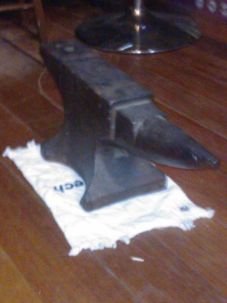

  6. That's a mighty fine anvil mate, awesome stuff. Can't imagine there would be many other HB anvils here in Australia. Be good to catch up again, Hans is planning another hammer in at his workshop next weekend I think, will see you there.
