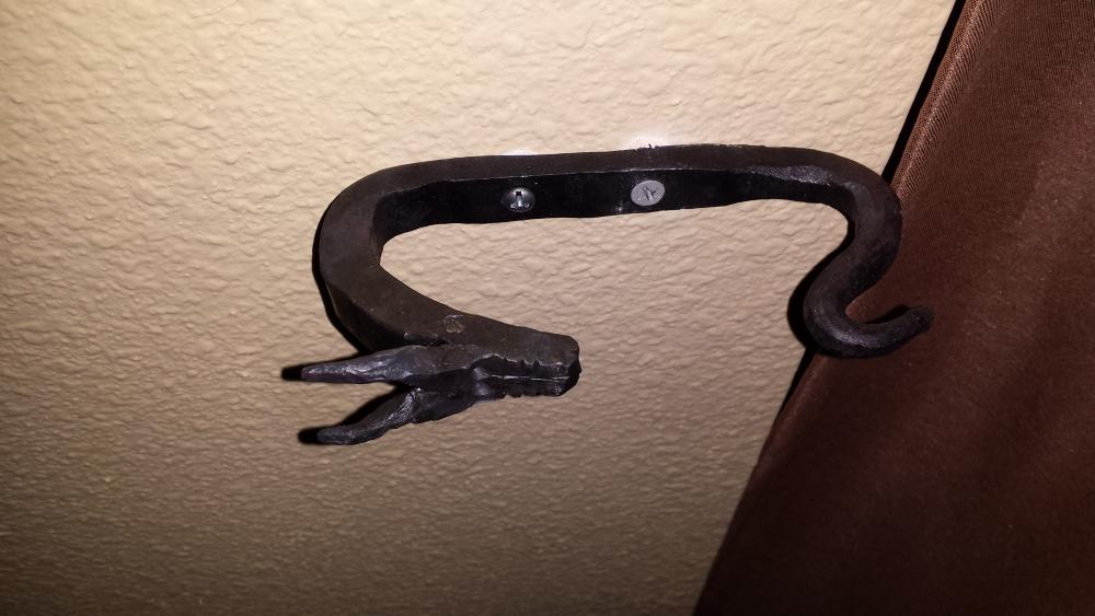

  1. This is a dragon curtain holder I made for our old house. Need to make some more for the new house
