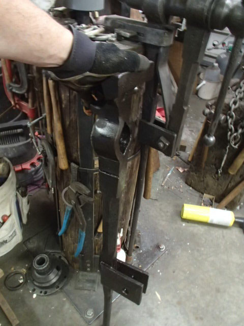

    Put hammer to steel in my newly mounted vise tonight and am very happy. Reinforcenments work well.
  9. Bill M replied to Glenn's topic in Vises
    I started with just the telephone pole, then added the steel reinforcement because I don't trust the 4" lag bolts to stay fast for the long run. And yes, the vibrations are very minimal and the whole thing is very solid, I'm loveing it! I just finished mounting my anvile, and routed out a 2" pocket in the wood base then filled it part way with sand, no ring and very solid.
  10. Bill M replied to Glenn's topic in Vises
    Hi there, I just decided to join after "lurking" and learning for quite some time. I just finished refurbishing and mounting this old Iron City vice thats been sitting in my dad's yard for years.
