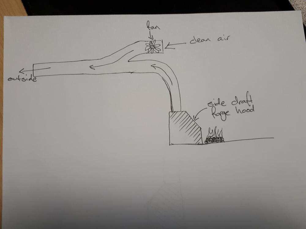

  13. ThomasPowers: Yeah, I have an old fan from my ford focus which I was planning to use as the forge blower. So doing something similar for the extraction would be ideal. My problem is that I don't have electricity where I am, so I'm going to be running the forge from a large agricultural 12V lead acid battery. I shall look at that sort of clean air pushing idea. Sort of like the image I've attached is what I have in my head, if you'll excuse the terrible drawing. mutant: Thanks, I've had a look at your channel and I'll have a go through more of the videos when I have the chance. (I see you've done an Alec Steele course, he's just moved to the states from his home in the same tiny city I live in ). I'm impressed you've got it that soundproofed, does the enclosure not restrict your working area a lot? Seems like it'd have the drawbacks of a gas forge in the small opening, and make maintaining the fire harder.
  14. Hi all. I'm at the moment kitting out a coal forge in a small space I was able to obtain. My forge is in a 10ft x 8ft metal shed, which is itself inside a storage unit. I have the door of the shed a few feet from the door of the unit (a normal house sized door) with both open so hopefully enough in-draft. My problem is the forge flue, I only rent a space in the unit, I can't put a flue through it and can't really extend anything above the roof line. My only real option is to have a flue coming out of my shed, through a flexible pipe which I put out the unit door. I understand that I won't be able to get a cross draft which is needed for a passive chimney, so I'll need some sort of mechanical extraction. My other limitation is that I'm trying to run the whole forge on 12V. I've seen 12V extractor fans on amazon, which im thinking "Put some sort of forge hood on, duct it out of my shed to a fan, duct that out the door.". I have no idea if this sort of setup would be sufficient and in all honestly, I don't like the sound of CO poisoning I realize my setup is not exactly ideal, but it's what I have to work with. Any advice would be amazing.
