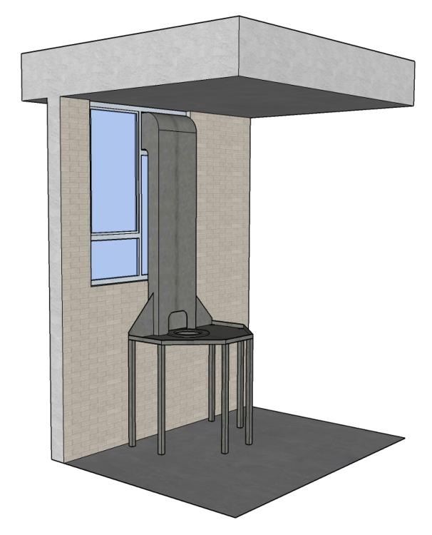

  2. Hi all, I'd like some advice on doing something incorrect, but functional. So, I have a window in my shop about a foot higher than the level of my forge table. I used to have a flue coming out from it with a side draft and a chimney 1.5m above the roof and it worked really well. I have since moved away (so had to remove the chimney) and come back. My landlord is not allowing me to reinstall my chimney, or anything affixed to the building. I have kinda stopped caring that much about my workshop, I'm in the process of looking for alternative shop space. I need to reinstall my coal forge (Ive been using gas for the last 2 years) and just get things functional and the smoke out of the window. I cannot add anything to the outside of the building, but i need to extract smoke out of the shop. I have a bouncy castle (bounce house) blower which is pretty strong and some thin sheet steel. Because I am not staying for long, i need to do it as cheaply as possible, not really invest anything in it, but I need a coal forge this summer to work on my qualification pieces (WCB). My current idea is just a kinda hood, with forced air blowing across the top and, in theory, pulling the smoke via venturi. No idea whether that will work or not. Note: this doesn't have to last for years Any help would be awesome xxx

  13. That forge build looks amazing JHCC, I've been through the thread and it looks incredible. So, I probably could make a watercooled tuyere without welding, or get it welded by someone much more simply, but I'm not convinced that it's the right choice for my workshop. The 6" of space I have is from the back of the firepot to the wall, so that includes the water tank AND the nozzle. And with the only available space being below the forge table, it would need mechanical water pumping in order to circulate the water too. Although I don't think we should skip over Frosty's idea of a ceramic tuyere. Surely there must be a reason we don't see it more often though

  15. I may have misunderstood, but isn't the point of water-cooling your tuyere that none of it burns up? Otherwise is it not just like having a pipe through the fire clay into the pot. The extruding bit will burn up and need replacing. Also, the 6" between the fire and the wall I only have below the table. Above the table, that's taken up by the side draft hood. The boat is possibly the most financially irresponsible decision my wife and I have made we used to live on a boat for years (inland waters) and we missed it so much. So we bought a little 23ft tugger,(not like we were ever affording a house anyway) it's a 2 day cruise from the coast (where we bought it) and the river we want to moor it, and no heating or insulation. It's a fun weekend

  18. Of course. Sorry. I am a member of ABANA, don't know why I'd assume an American smith wouldn't be aware of BABA Having thought about it, I do have a 1.5m length of 200mm stainles spiral ducting (it used to be my chimney). That might be more uniformly shaped than what I can cobble from plywood. And a LOT lighter and easier to manage and move. Depending on if I can work out how to get a non-return valve into 2" black iron pipe, I can use the maluable pipe work as the secondary chamber on it's way into the fire inlet. That a really interesting idea JHCC. I can definately see how that would work and be more controllable in terms of airflow. Would it be harder to maintain a good forging (welding) heat with a much longer wait between blasts?
