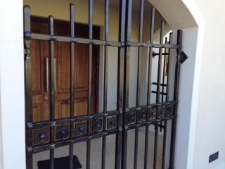

made a gate for the owners private home on a wine farm (edgebaston/Stellenbosch)

Materials: 40mm square bar & 30mm round bar.
Good sized equipment? Omg, no. Made it in my garage. Tools: self built mech. power hammer & self built hydraulic press. Have not even 3 phase in my garage yet, so the press is a compromise between speed & power, momentarily adjusted to around 9 tons pressing power only.
