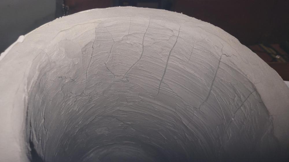

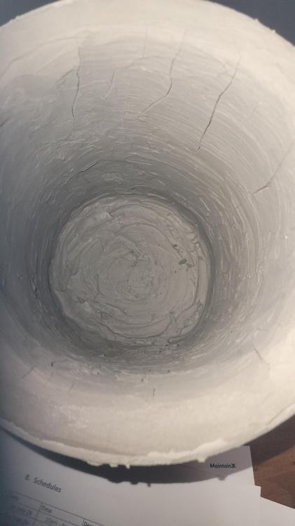

The 1st coat went well, no cracks, waited for about 24hrs to apply the 2nd, and as it often happens didn't stick to slogan 'less is more' and the next day the picture says all, same story with the top lid (
Reading again, conflicting info, confounds me, don't want to go 3rd time with this. The crack go down 1/3 all around, about 1mm wide.
Please direct me how to deal/repair this.

I'm not familiar with this particular product, but cracking like this is generally a sign that the refractory had too much water in the mix and/or was applied too thick. The more water in the mix, the more it shrinks as it dries, so we generally recommend using only as much water as needed to make the mix workable.
The big question is how well the second layer has adhered to the first. If it's sticking well, you're probably okay and can go ahead and add the third layer without too much worry. If it feels like it's flaking off, you're probably better off flaking off as much as you can and applying a new second layer.
Make sure to "butter" the existing surfaces before you add new refractory. This means wetting them slightly (with a damp rag or a spray bottle) before adding the new mix, to improve adhesion between layers.
