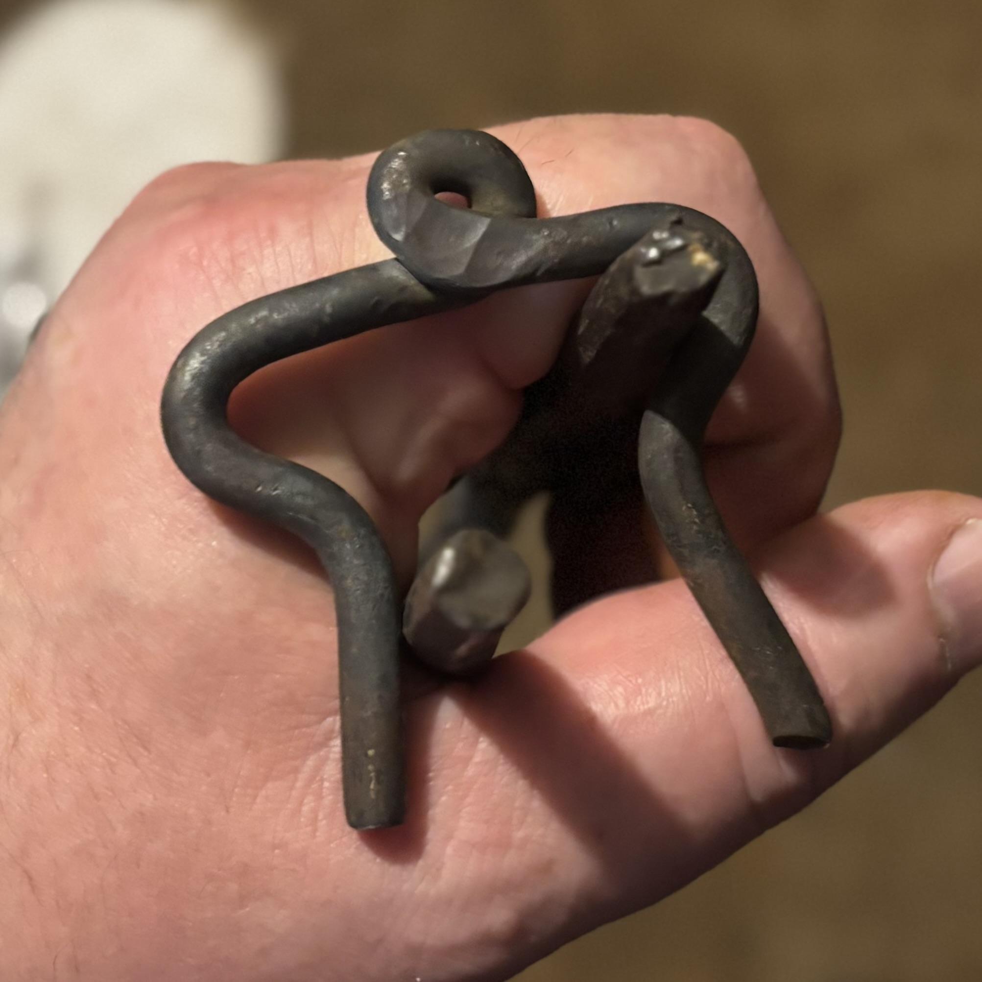

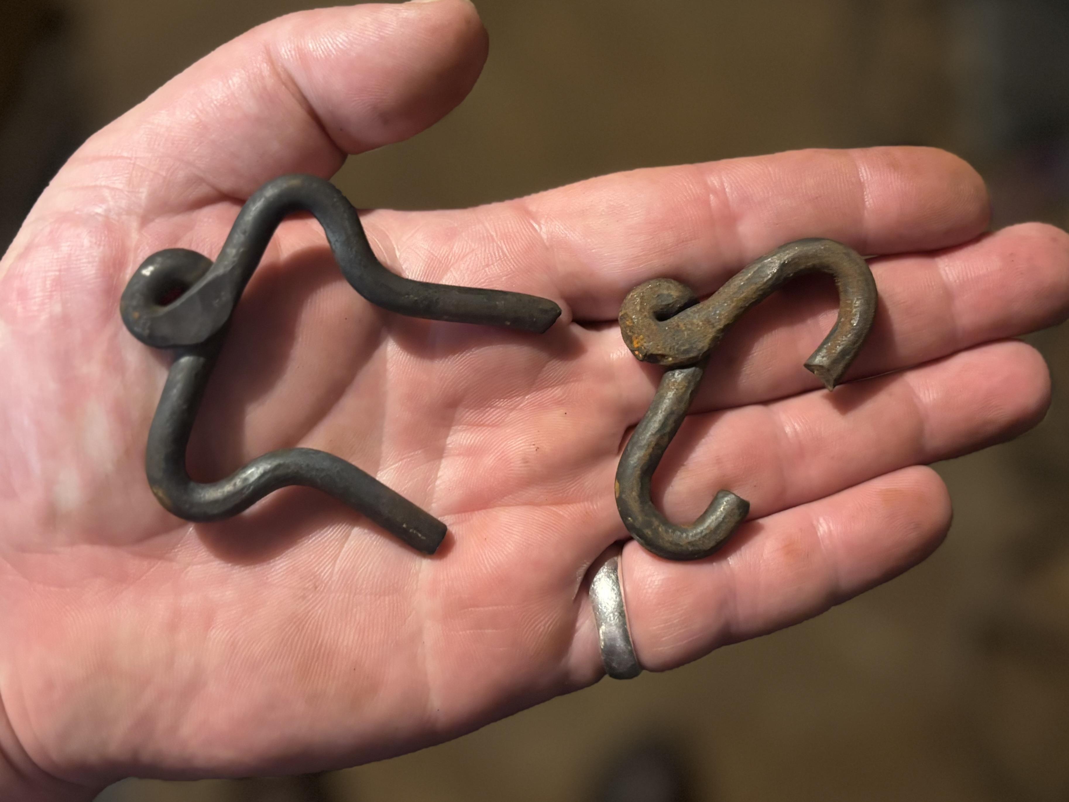

Yesterday, I needed a pair in a particular size, grabbed a bit of 1/4" round from the scrap bin, and was bending it to shape when a modification occurred to me. Rather than cutting the ends short to make the more conventional "C" shape, I bent them outwards kind of like the outer lines of a capital "W". Here's a photo of the new clip (left) together with one of the original style (right):

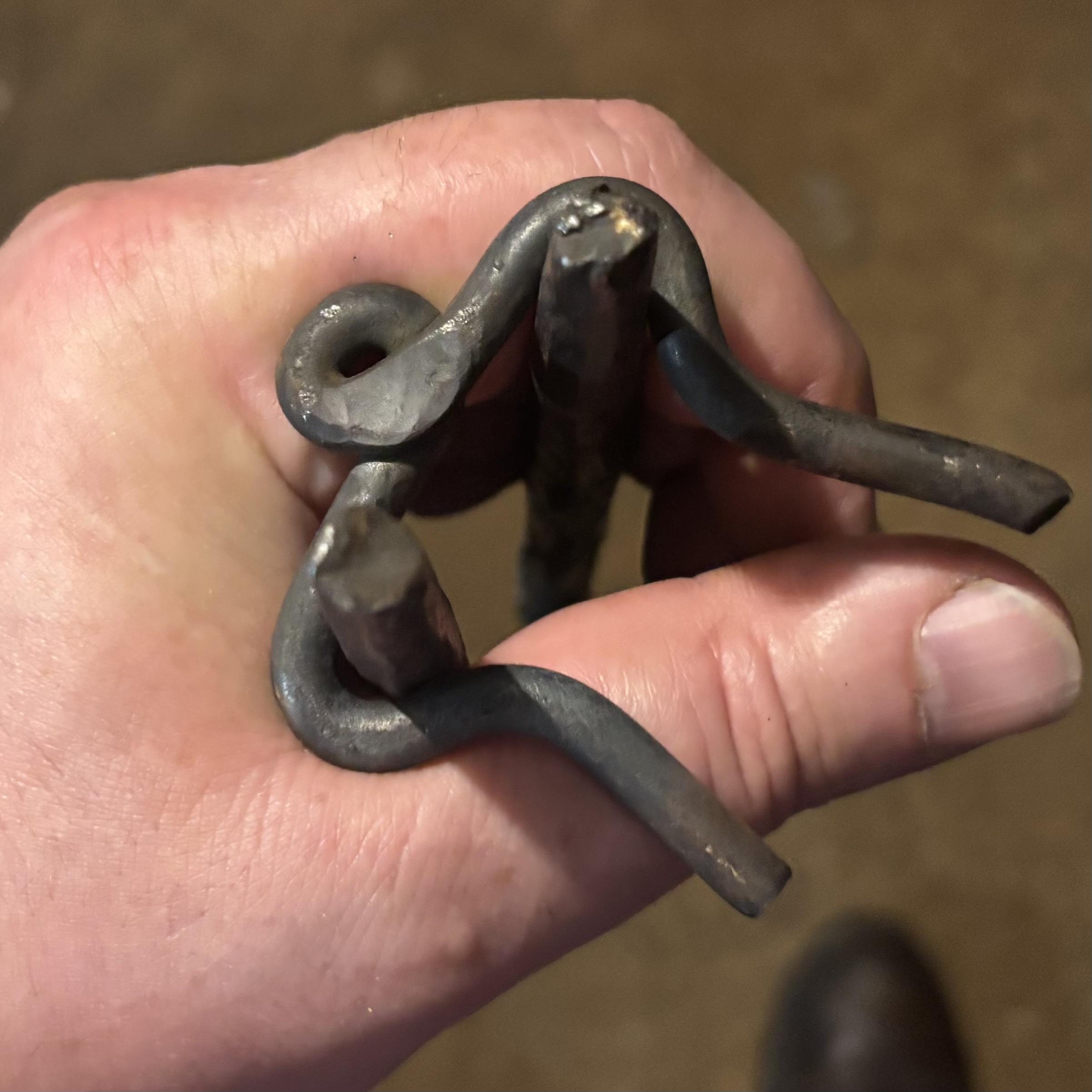

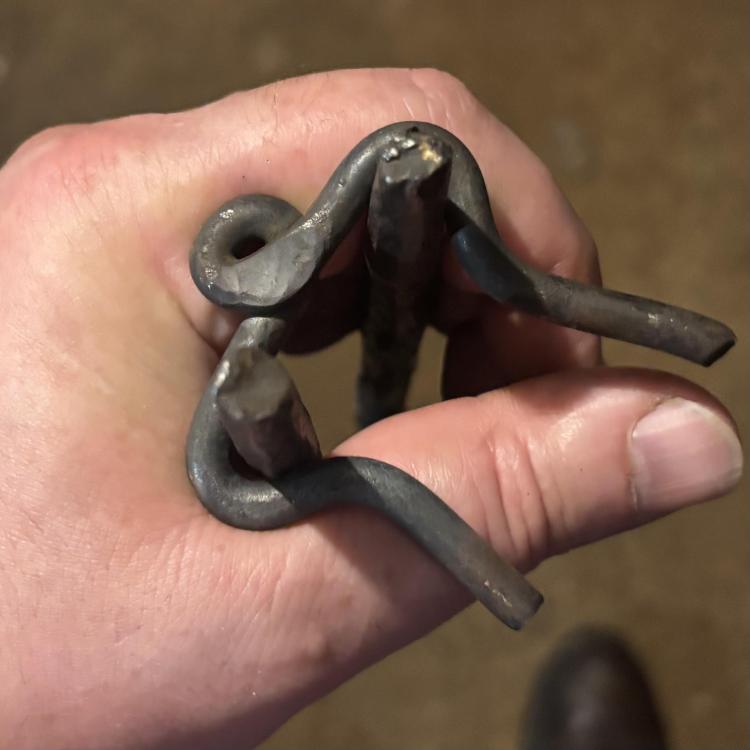

The big advantage of the modified version is that it's very easy to hoo onto one rein and twist into place on the other:
I've got a LOT of these bits of 1/4" round, and I'm sure I'll be making more of the new style of clip.
