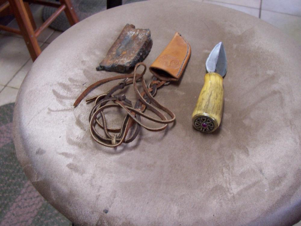

I've used JB Weld without any problems and the handles are still as tight as when I made them years ago. I always brad the tang at the pommel and even put some decoration over the brad with the JB Weld. Here is a little leaf blade neck knife I made for Debi probably 15-20 years ago and the deer antler handle and pommel cap are just as strong today as the day I made them. The hunk of steel in the picture is what the knife is made fro.
