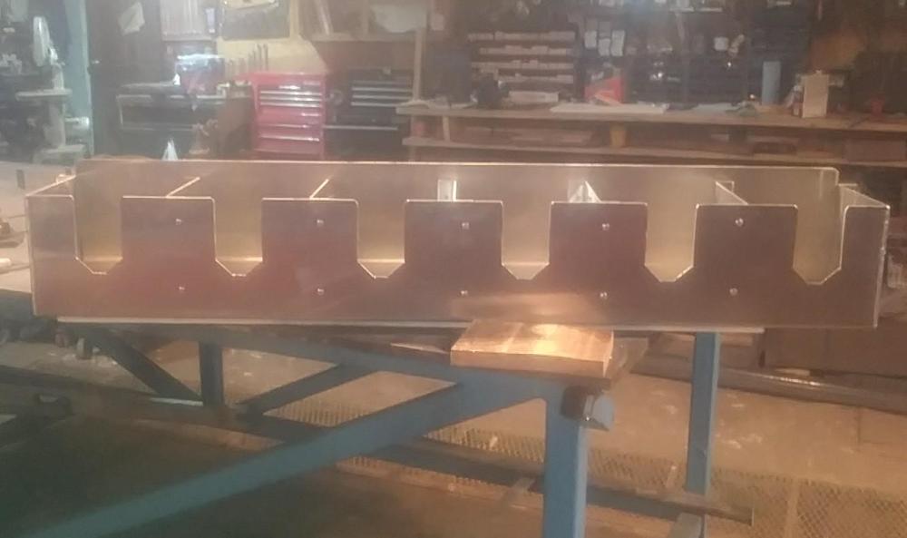

I stopped to chat with my closest shoeing friend last week and got to pondering the "organized chaos" in his shoeing trailer. He's the kind of person who is pretty meticulous about almost everything - except his work trailer. Think piles of shoes everywhere; heaps of grinding/forging slag; and pads stuck in any crevice that will hold them. So I built him one of my pad racks as a belated Christmas gift - and I'm going to hound him about using it!
Matt.0107251450-1.thumb.jpg.17adb9785f880b14aa20332a268d3d27.jpg0107251450d-1.thumb.jpg.d1e5b9a93cc3c930517400f501719df0.jpg
Maybe a pic of yours with pads in it? I don't get the idea of how it's mounted or used. Does it keep them sanitary?
Frosty - most shoers carry a wide variety of plastic and leather pads; we nail them on with the shoe to absorb concussion, provide support or keep snow from balling up in the shoe. This is just a nice, 6-compartment rack to keep the pads sorted and stored laying flat. This one is built to mount on the trailer wall - the back of the rack is 1.5" taller than the front so you can self-tapper-screw it in place. Also the end-caps are bent with a flange for extra screws.

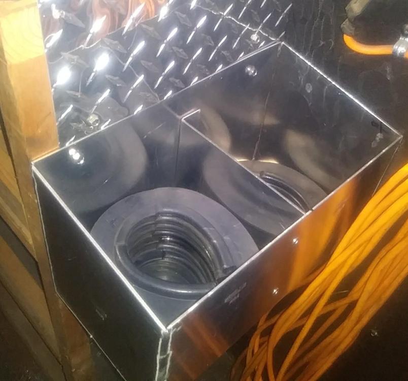

0501241044-1.thumb.jpg.c0ed47f9045427a58c76ccc9ff6bd3a4.jpgHere's a 2-compartment pad rack in my trailer with snowball pads nestled inside.
