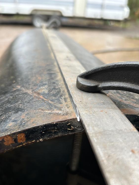

Hey all, I’m at the starting phase of my actual build and wanted to have a thread to both document the process, and hopefully get feedback of the older and wiser, and hopefully get a few questions answered. Not only do I fully acknowledge my own ignorance/inexperience, but I also appreciate constructive feedback (I.e. … I get that some of my ideas may be misguided, but I’d appreciate an explanation or link that explains why/how I’m wrong or what I need to reconsider).
Starting off, I believe I have all the materials needed with the exception of a few components for my new burner system. I’m wanting to build a two piece shell-D shape(figure it’ll make repair’s easier if I’m just having to replace the floor). My shell is a piece of old line pipe that is approx .375”-.38” thick, with an ID of approx 15 5/8”-16” and is 25” long. I’ve already split the seam on the pipe (be careful cutting anything under pressure, whole thing shifted open an entire inch after cutting it, thankfully I wrapped it in chain) and I’m planning on straightening the bottom ends at it’s widest point (approximately 16” widest). From the floor (which will be formed and cast as it’s own separate piece) it should have inner dimensions of around 16” wide at its base, 20” floor to ceiling (this is the one dimension that I have the most concern about, that I may want to keep it a bit lower), and 25” deep (which could easily be shortened). The floor, doors and anything else will be made from a sheet of .2” thick plate, 33”  by 60”. Please remember those inner measurements do not include the 2+” of kaowool or refractory.

Thank you for your time and feedback, pictures included are of the shell and cutting process (was a bit of a pucker moment while cutting it and listening to it groan/shift), and sketched plans.

I'm not expert on the construction of propane forges.  I'm more of a plug and play guy.  But that appears to be a pretty large forge and is likely to be VERY propane thirsty.  You will need a large tank, probably an 80 or 100 pounder to feed it and to avoid freeze up of the tank.  Don't forget you can only forge about 4-6" at a time by hand.  Heating more than that much metal is wasteful of fuel and can decarburize the steel.  I suggest that you consider what you are likely to be forging and how big a forge you really need.
I appreciate the response George. That pretty much encompasses my major concerns as well, I think a large amount of that can be Mitigated by two things though, cutting my working area depth (25” is a bit deep) and making sure my burner is properly matched to the work area/volume I have (which is part of why I’m looking at doing a ribbon burner).
