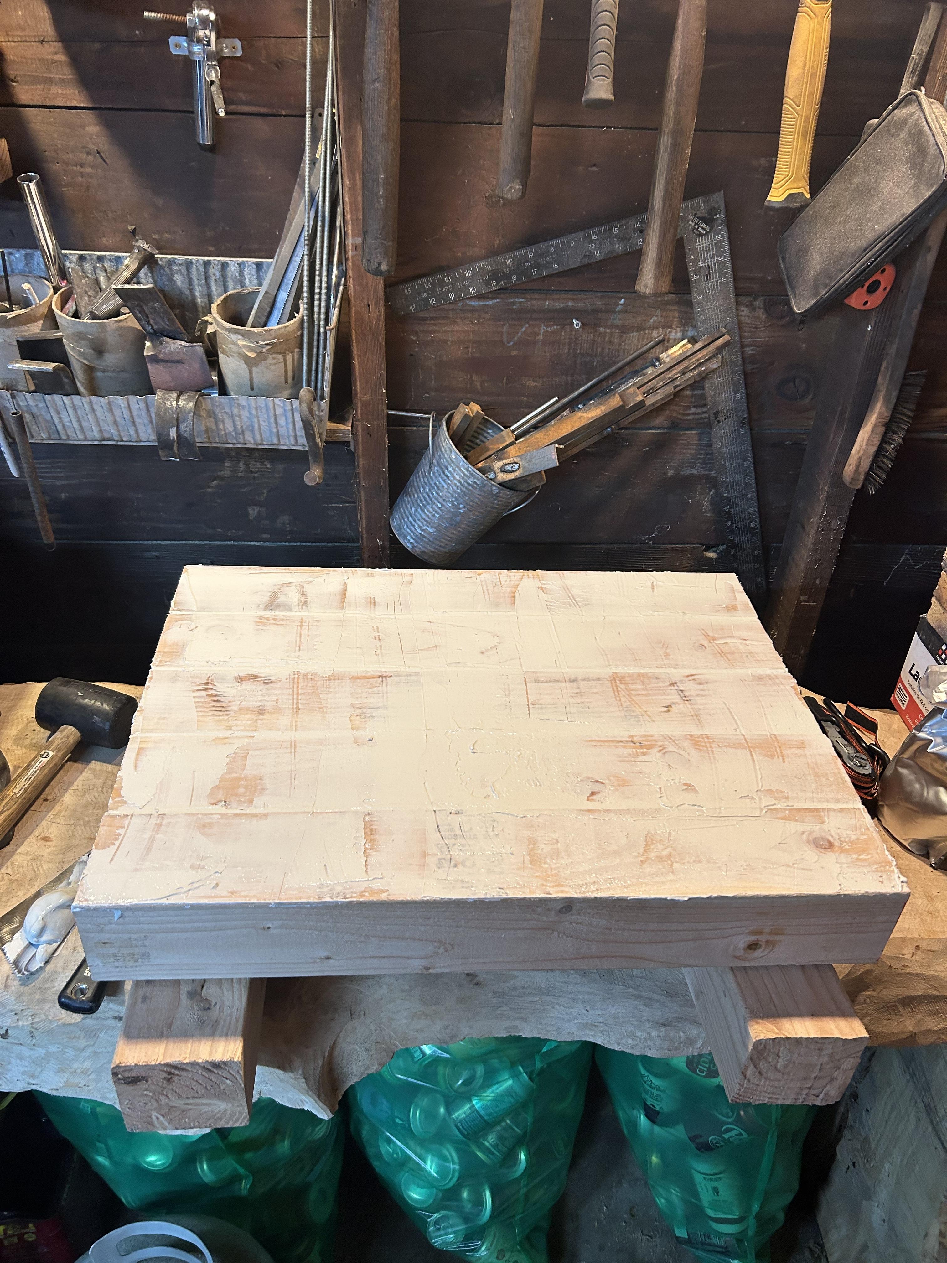

For anyone wanting good updates, working on my anvil/vice stand (small anvil and only a machinist vice for now) currently and have some good progress photos. My shop is small so being able to move stuff is currently a high priority to keep things clear. That being said, I already know I either need to weld some more supports on it cause it tends to sag a bit under heavy load or hitting the smallest debris on the shop floor. Photos show gluelam (liquid nails caulk) process of bonding 4x4 (Home Depot so closer to 3.5). Router leveling and cut out for anvil (dropped some silicone in there and it’s so much quieter). Char sealing (oil to come later) and strapping and embellishment process (rigging points will be set in multiple points on the strapping). I plan on wire brushing and oiling the wood, and finishing the strapping in some type of brassy/bronze and black. Any and all questions/criticisms are welcome! -
