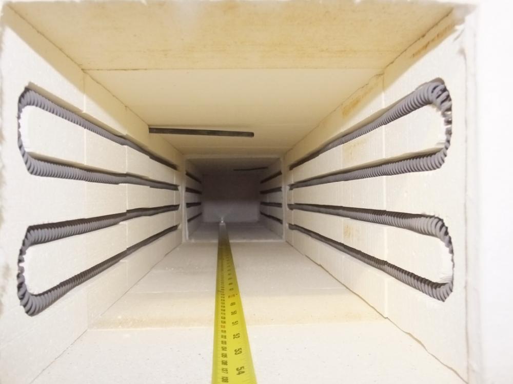

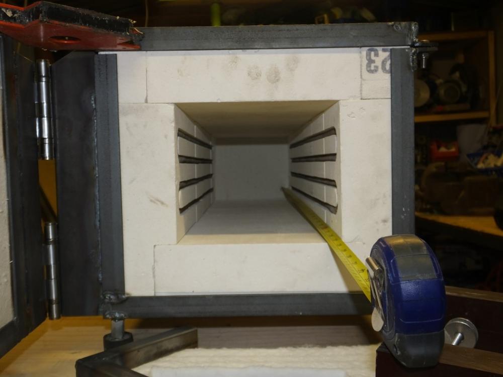

I used 16AWG Kanthal A1 on my first few builds (I've built 8 or 9 to date) and some of the guys who use them professionally experienced element burnouts. I went to 1.6mm Kanthal A1 for the 3 most recent builds and, as far as I know, they have held up well for nearly 4 years. I have always tried to maximize the available groove length, in part because I'm middle-aged and grumpy and find it easier to get the staples in to retain the coils in the grooves if I stretch the elements to the longer end of the recommended range. I run 4 lengths of the sidewalls as a rule. My elements are about 3/8" OD and the grooves are cut with a 10mm bit in a router.
The 7" width of my build has been largely dictated by the need to bridge the roof with a single brick. I build without mortar because I just don't have the knack of using the accursed stuff. I did build one quick-and-dirty 42" oven, 9" wide, that used a 3 kW element each side. That used Ceramic Fiber Board for the roof and solved the issue of bridging the 9" gap.

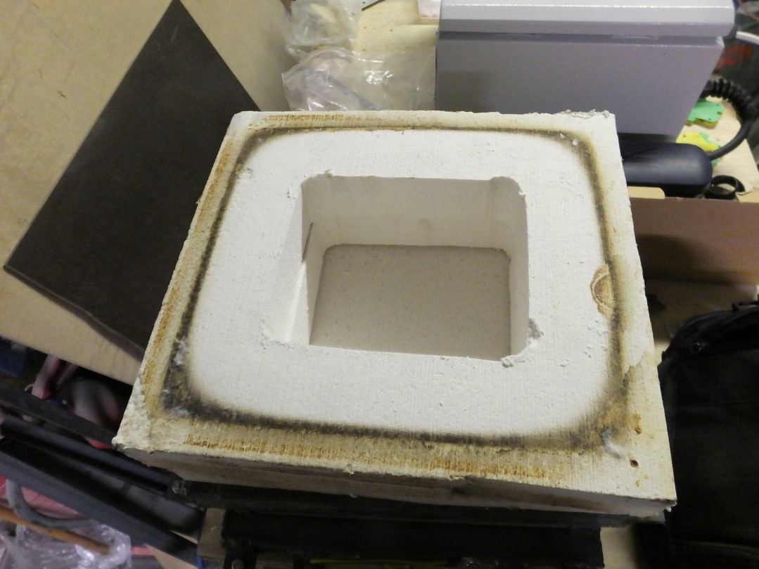

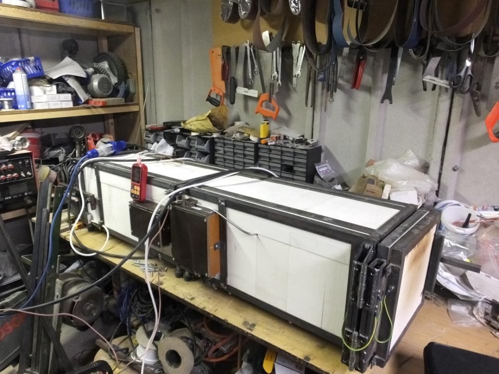

The last 2 ovens I built were 6 brick-widths long (27") and the 1" blanket I use as a door gasket compresses down to 1/2" in use, adding another inch for 28" total internal length (because some bloody irritating bladesmith had suggested, in passing, that it might be a good idea to build two ovens that could be joined together to make one for long stuff, they got built with removable backs with blanket gaskets too. I anticipated some other bladesmith telling me that a mere 56" of combined length is too short, so built the doors and roof from Ceramic Fiber Board with the facility to add layers to the door and middle for more length)
