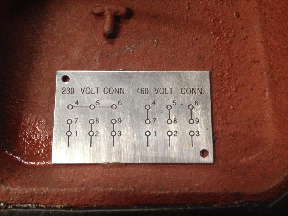

edennis Posted April 3, 2020 Share Posted April 3, 2020 Hi folks, I'm wondering if on this wiring diagram the wires 4-5-6 in series on the low voltage size can all be connected together using a twist on wire connector or if they need to be connected in a series (4 is not directly connected to 6, but through 5)? Thanks, Quote Link to comment Share on other sites More sharing options...
Steve Sells Posted April 3, 2020 Share Posted April 3, 2020 4,5,6 under one wire nut, how would anyone connect them in series anyway? Quote Link to comment Share on other sites More sharing options...
edennis Posted April 3, 2020 Author Share Posted April 3, 2020 Thanks, I'll connect the three all together then. Quote Link to comment Share on other sites More sharing options...
edennis Posted May 14, 2020 Author Share Posted May 14, 2020 If I wanted to switch the direction of this motor running on 230, which wires would I switch? Quote Link to comment Share on other sites More sharing options...
Steve Sells Posted May 14, 2020 Share Posted May 14, 2020 input leads 1,2,3 change it out to 1,3.2 or 2,1,3 or 3,2,1 (Switch one pair) Quote Link to comment Share on other sites More sharing options...
edennis Posted May 14, 2020 Author Share Posted May 14, 2020 Thank you. So if I switched 1 and 2, for example, 7 & 2 would be a pair and 8 and 1 would be a pair, right? Quote Link to comment Share on other sites More sharing options...
Steve Sells Posted May 14, 2020 Share Posted May 14, 2020 yup Quote Link to comment Share on other sites More sharing options...
edennis Posted May 14, 2020 Author Share Posted May 14, 2020 Thank you Quote Link to comment Share on other sites More sharing options...
