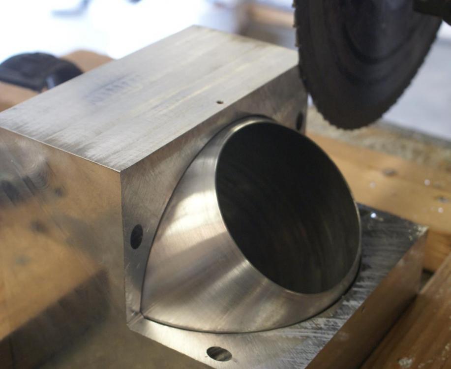

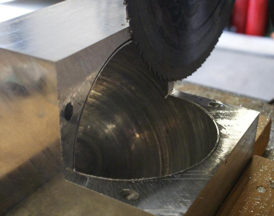

Spun a few 6" aluminum balls today
Over the last 3 weeks I spun 100 6" aluminum 6061 balls that are .055 thick with a pacman cut out. These attach to fascia on the Marin Civic Center building and get anodized 804 inorganic light gold. This was last building Frank Lloyd Wright designed before he died.
Cheers and "happy metal working"
Paul

Thats facinating and looks really nicely done can you put up a bit of vid of the spinning part if its not a secret squirel process I have never done any thing like that before, Cheers Beaver
