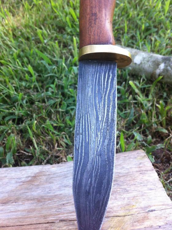

Still working on this, but onto hand sanding and finish work at this point.. Here are some WIP photos.. I'm pretty proud of this as it's my first, but critique is welcome as it will only make me better!
I'm dumb and realized in the last 2 pictures the guard was put on upside down.... When i'm back at home i'll have to retake them, the handle matches up with the actual front of the guard.
typically I would say that hidden tang knives are more difficult, just to get them all straight and fitted together tightly and that a full tang knife is a better/easier first knife, but yours looks good so far! What steel did you use? handle wood? Looks like maybe oak?

Good to hear, I just finished a hidden tang, I don't think I will be doing much of them, cause in my mind they are more work than it's worth. Sure you can do some more interesting and cooler things with a hidden tang, but it is also not as strong, and you can do cool things with full tang knives also. But, if you get good at hidden tang knives (though you already seem like a "natural") they will become easier than full tang, though for me I can do a full tang quite quickly, or at least quicker than hidden tangs, but speed comes with time. Not the most happy with the fit, but oh well. Mesquite handle from the firewood pile.
I had never done a hidden tang, and had never had the end of the handle angle like how I did on this one. I found it is quite a bit more comfortable with it angled for when holding it as if you were going to stab down at something.
Here is the one I did.
That's a very nice knife you made there though, it just looks comfortable! what finish did you put on that handle??
I plan on doing lots of full tang knives with a bolster / guard and thread and tap the tang and bolster to really seal down for a strong construction, plus i love the look of the guards and bolsters on the knives. I think the bronze and such really makes the wood stand out!
Really nice damascus also btw!! I havent done any forge welding yet, but cant wait to try it out. I've got 1095, 1065, and 15n20 to work with on my first damascus try.
Thank you!
For the handle I just hand sanded it, buffed it, and then a coat of boiled linseed oil, I understand there is better, but it is what I got right now.
I really like the look of the gaurds to, Like you said, the brass makes the wood stand out well. I ain't ever done any threading and tapping, so, that isn't on my plate yet, but would like to do it in the future, I think it would make things just much more stable and tighter. I would like to do an integral bolster.

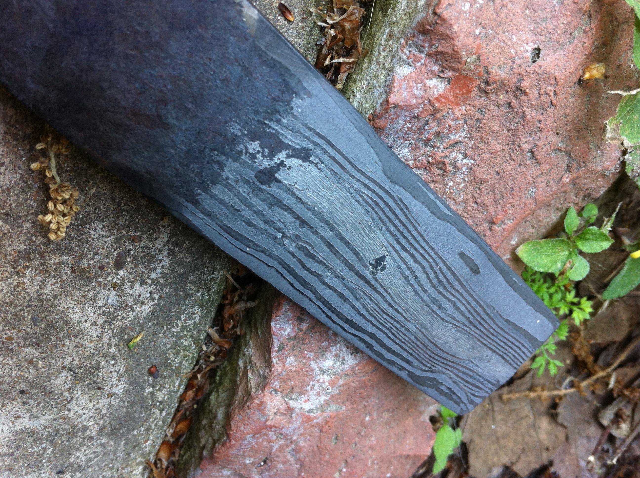

Thank you! it was just pallet strapping, band saw blade, and the middle layer that you can kinda see is cable Damascus, 113 layers. The pattern looks much better in person.
This was before the final weld, just took a fuller, made the "waviness" then took my piece of cable damscus, and put it inbetween the two halves, smacked it, and had it follow the contour of the fullering. Then I tack welded it together, and of course went to forge welding it.
Then there is a picture of the Damascus before I forged it into the knife and heat treated it. It is amazing what heat treating did to the color of the Damascus.
