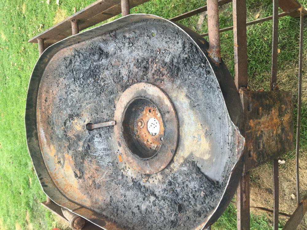

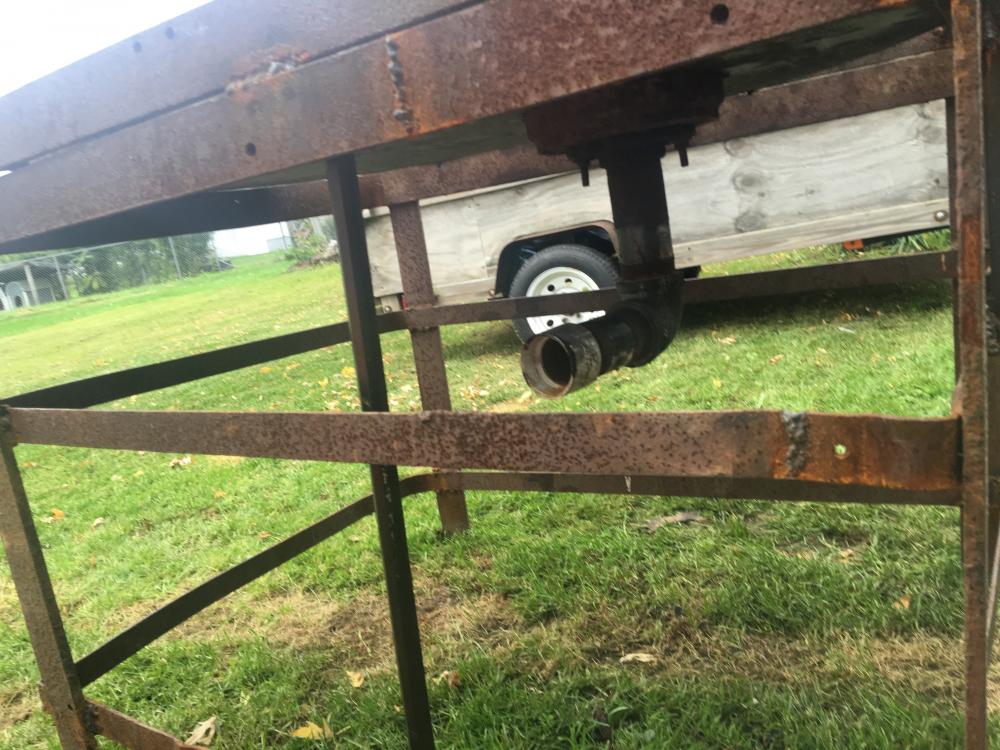

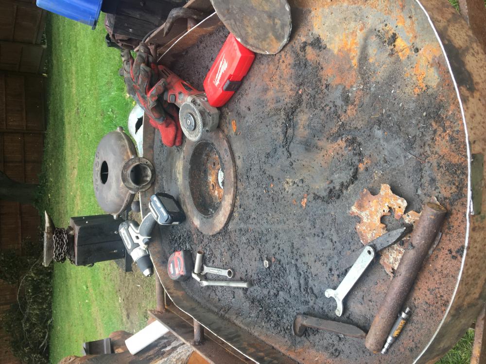

Some day I would like to build a plywood shelf and install a electric blower. For now it's a run what you brung kinda forge. All in all its a big step up from my trashcan forge. I built it up from a ladder a railing and a oil tank. Thoughts and criticism are welcome.
Think you'll be wanting bigger holes in the tuyere, and a T at the air inlet pipe so you'll have an ash dump. Think of a T on its side. the bottom part can have a flapper or lid to keep air from escaping when you arnt dumping ash.
That's a really good idea and I will work it into my plans. Thanks
