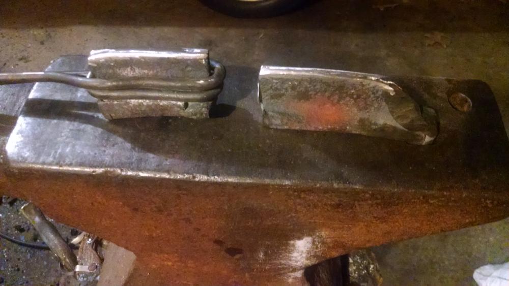

A friend gave me a bunch of Fair® rail anchors (from a rail-to-trail conversion near her home), and I had the idea of trying to make fullers from them. So, from the top:
Anchor as found (with some brainstorming sketching)
In progress, straightening out the bend.
Forging complete, with bend squared off into a shank to fit the hardie hole, anchor cut in half, and top fitted with a rodded handle.
And here are the top and bottom with the edges ground smooth. This gives a width of about 1/4".
I think I should be able to upset the anchor's "blade" to make bigger radii, as well.
Very nice job seeing a tool inside the steel,i also like the fact you used the shape to your advantage putting the bottom fuller more toward the center of your anvil.Looks like they will work great.
