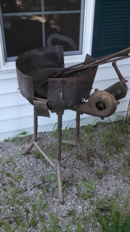

I just got an old Canedy - Otto forge for a good price, plus labor. I'm currently restoring it to working order so expect pictures in the next couple of days. I would be interested if anyone knew any info about this forge in particular. Its not a BB size and it doesn't have one of the big Royal or Western Chief blowers. I've only found two other ones online and no info. Any help would be appreciated. Looks like a decent little rivet forge, and just for clarification the extension was added after market.

Welcome back, glad to have you. If you'll put your general location in the header we might remember where you are after this post.
Nice looking little forge. Is it a cast or sheet steel pan?

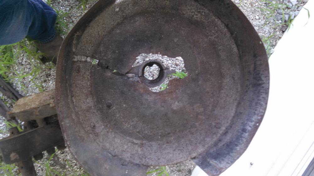

I know its hard to tell in that picture but its cast. Lots of pitting and one hell of a cack though. It says on the forge to clay before use, but I fear the last owner did not. Part of my restoration will also be modification/upgrading so that I will stop it from cracking anymore and won't need to clay it.

Ouch, that actually looks worse than mine. Good thing getting coal here is hard enough I don't bother trying.

Yeah its pretty bad, but I'm setting a rotor into it so it'll be back up and running. A forge with a working hand crank blower for $75. Crack or no crack, can't beat that.
It's a good deal, you ought to try finding one here for almost any price. I shipped mine up. If I knew which was the right coal vein and could talk some youngsters into digging and packing for me I'd probably just pull the tuyere off mine and build a new forge pan.
All the air blast hardware bolts to the pan so cutting a 1/4" x 24" disk or whatever shape table and welding a 2" rim on it to bolt the air blast hardware too is just too easy. Certainly a LOT easier than trying to weld up a crack that is almost all the way across the cast pan.
I'm dialed in with propane and can make charcoal if I want to so the coal can rest in peace. . . For now.
Oh I'm definitely not trying to fill in the crack, just welding the rotor in enough so I don't have to worry about anything shifting around. I intend to keep the bolts working so I can continue to break it down like it currently is. Its sitting in a corner after I stopped yesterday, it looks sad not put together.
