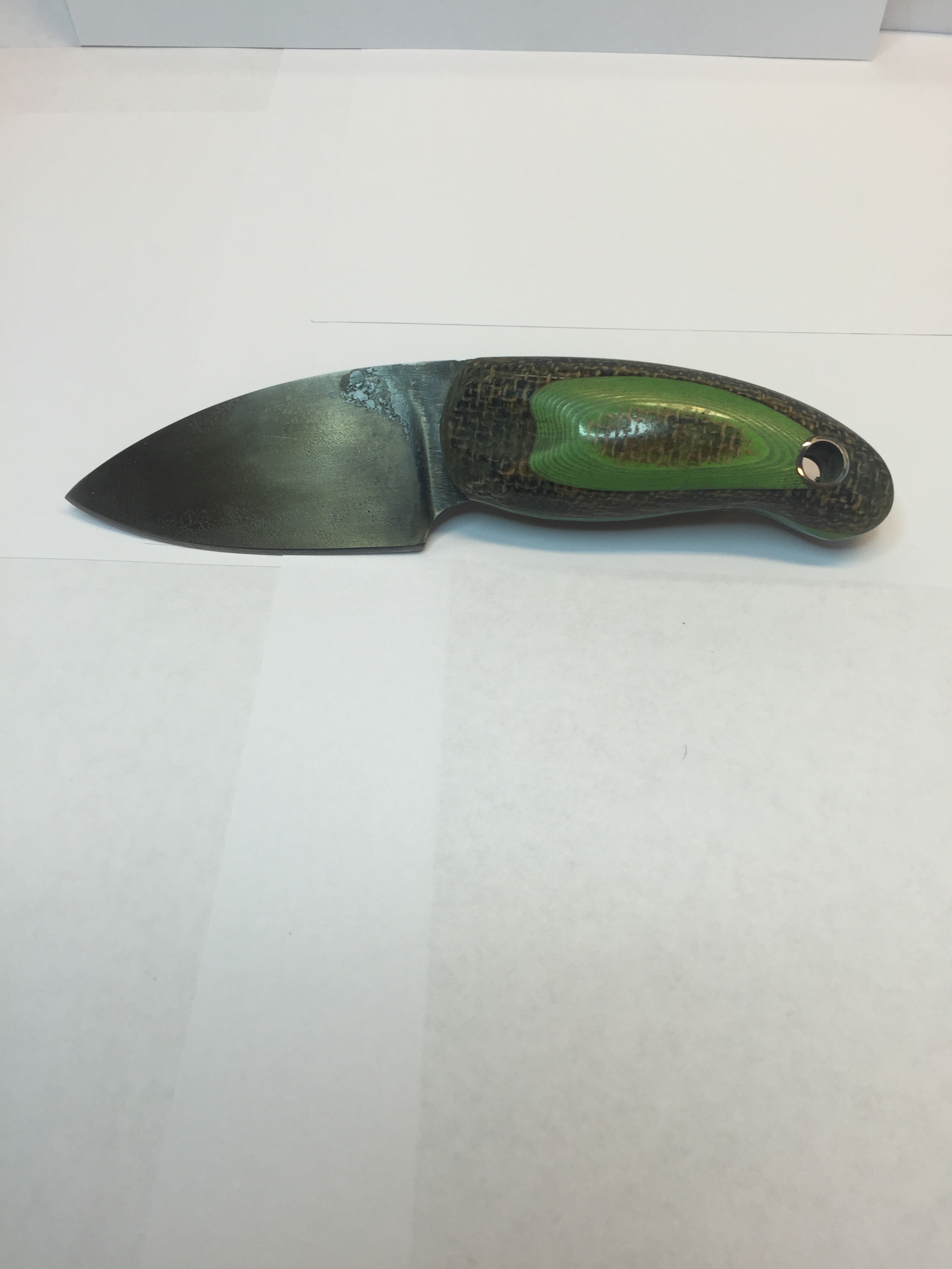

1095 Stock Removal Knife
Jeddly
Grinded out this little blade the other day. It was cut from 1/8" x 1.5" 1095 that I bought from Jantz a while back. The grinding went pretty good, I think I am getting the hang of it. I left the temper color on it because I thought it looked kinda cool. The handle is some homemade micarta that a friend gave me. He calls it Zombiecarta, and it is made with camp burlap and green construction paper. I kinda like it. I installed a hidden pin made out of 3/8" stainless tube so as to not wreck the handle at the mid point of the knife. There is also a thumb groove on both sides of the handle.
Hope you like it.
