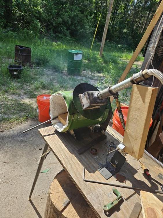

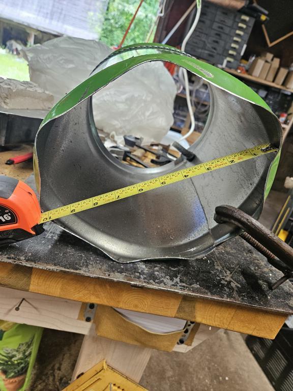

  8. Yup, one look at the final dimensions in real life and I immediately started a new build. Cut one whole section, node-to-node, of a 55gal drum. The nodes left on I think really help the thin metal hold the shape. Cut crosswise about 32 inches long. Bent that into a circle with the ends overlapped and put some bolts through. Had just enough kaowool to cover the inside with about 1" thick and rigidized. Ran with that for about an hour just to see what might happen and it did an OK job. Burner in this orientation did get a piece of 3/8" red hot, but I think having it point more directly down on the workpiece might do me a bit better. There was zero forge scale on the workpiece the couple times I brought it out. This will be my testing forge from here out. I coated the kaowool with some refractory and let it sit overnight. Will kiln wash that today and see what difference that makes. I did a dumb thing and put refractory on the hard kiln brick I used as the floor, so will probably try to pry that out so it can be a movable floor I can rotate the forge around to test different burners and angles. I still have enough of the cut off to make another this size. I'm going to order more kaowool and some good refractory in the coming weeks to build one of these for real.

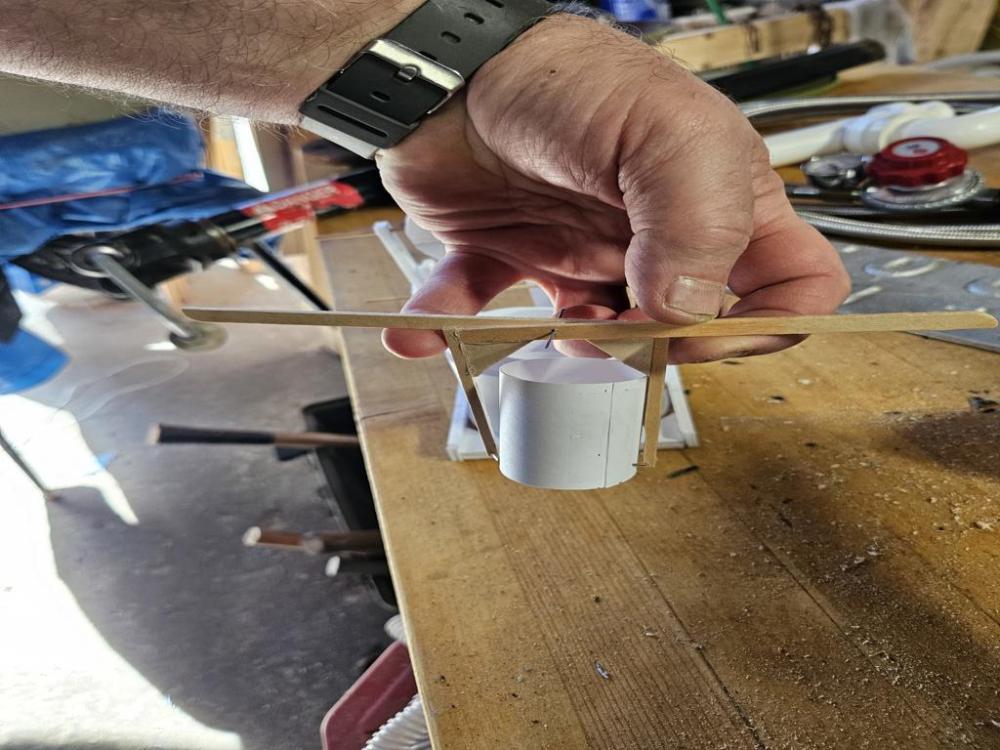

  15. Thank you much! I absorb as much knowledge as I can, and boy-howdy this forum will have me going for a long time. I haven't even gotten a forge built and already have a thousand steps ahead of me. I love drawings, I also love making scale models as it lets me test and measure easily. See pics of scale model lifting tongs and a full size test. The domed feature is from a wish to make both a forge and a furnace. Forge for billet work, furnace for melting work. On it's side for forge, on its end for furnace. I have mostly abandoned that idea, but I still draw like that so I can see from a different perspective. In casting, you want the furnace round so it swirls the flame and keeps in contact with the crucible. I was wondering about billet work and having a similar thing, where the flame impinges on the SIDE near the metal, but doesn't directly hit the metal. I bounce back and forth with that wasting energy heating the refractory, but then I remember most of that is being radiated back anyway, and the forge will be pretty well insulated and coated with good refractory as well as kiln washed and all kinds of crazy stuff to retain the heat. Oh, I also figured a ribbon burner would not be really good for casting, since the upper flame ports are almost as tall as one of my crucibles it likely loses more heat UP than allowing it to swish around. I too can go on and on about certain topics, and if there was one person I want to noodle on all he wants, it's you! In just this one post I've re-thought multiple things, and redesigned my kit multiple times. Now I just need to draw them out and see which ones "speak" to me.

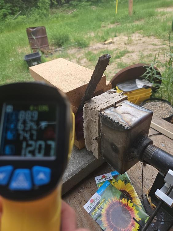

  16. Oh, believe me sir, I wholly perused your NARB thread. It also stands for Not ANOTHER Reil Burner. hahaha It has been months I have been "lurking". Before I realized Steve had approved my sign in so I posted the above. I hooked it up last night, Air supply was my old CPAP unit so a very steady 20 (cm H2O) air pressure, I was able to achieve 1200 F with nothing more than a few refractory bricks as a 'forge'. I wanted to test it with back pressure and it ran fine. Until I turned the propane up instead of off, then it started burning back into the plenum area. What a racket. Next one I make will be offset 90degrees as you suggest. I have all the cutoff 55 gal drums I need (at $10 each, I feel like a king!!) to build them with. PLUS I love the idea of having the port coming DOWN the side of the furnace as opposed to coming straight OUT the top. Anyone have REAL DATA on tangent burner placement? i.e. having the burner at say 45deg off side? Does direct impingement on the metal help or hurt? I can see the 45deg not heating quite as well, but will also heat more evenly. I would love to take time in one of our shops for real talk.... Yeahhhhhh, Windoze, Windoesnt.....Been IT tech for 35 years having to put up with the shenanigans of those goofballs. Just bring back Win7 and make us all happy again! I have a program called resize image that makes really small files from the gigabyte oversize stuff the phone produces.
