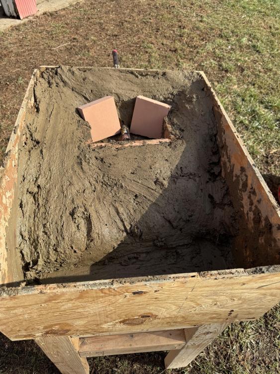

  1. Awesome thanks guys, I moved it back as suggested, the pipe I am using is a 3/4" sch 40 black gas pipe.
